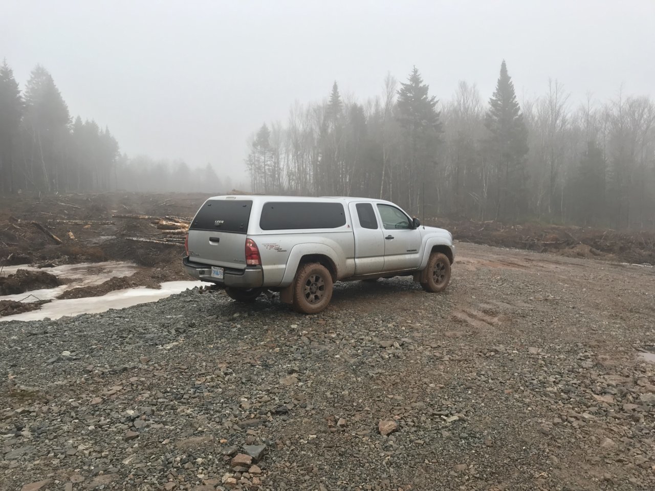

    .85" with tsb rear springs. Cap and gear are probably 300 lbs. The last picture is on the most level ground. 265/70/16

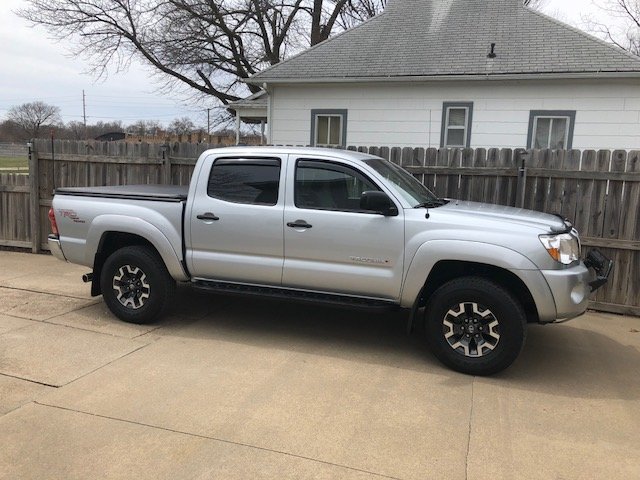

    Stock in the rear .85 up front.

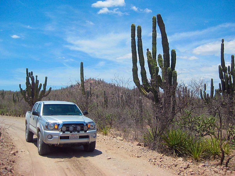

    2010 4WD Off Road DC
    Differential Breather Mod Light Bar: 4 Cree LED lamps Bilstein 5100s Ride Rite Air Bags
    Air bags were the recommendation at Off Road Warehouse to solve the harsh ride/ too soft springs on my 2005. I added them to my 2010 after a few years, as it had better springs than the '05. They are great as I can adjust them as needed rather than have a hard ride all the time that heavier leaf springs would create.

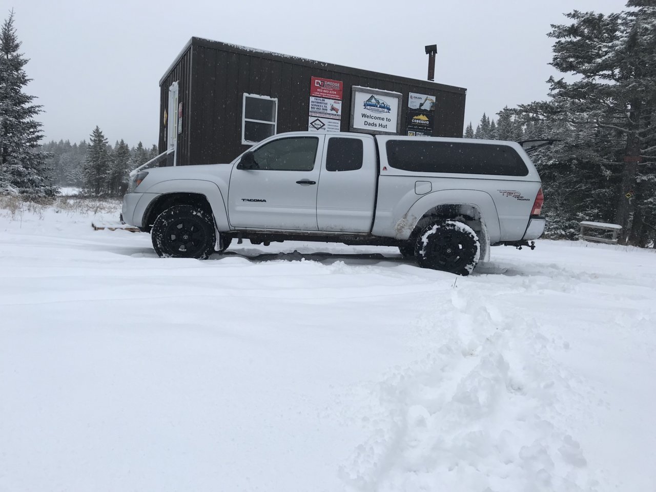

    Thanks! In those pics I had Treadwright Warden AT’s 265/75/16. They are re-tread’s and BFG AT clones.. They were good, tread wear wasn’t the best but a good tire for the price. Have the TW Claw Mud Terrains on now and same thing - not great tread wear but good tire overall. Getting Duratrac’s in the next month or two.. Good luck!
    Current Pics:

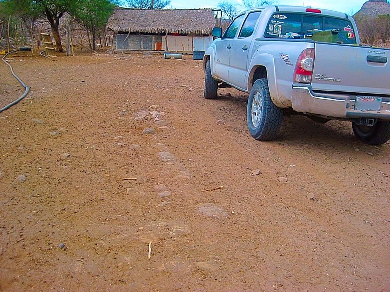

    Stock springs front and back. Other than the 5100s all around and the Ride Rite air bags in back, nothing else changed. I got the recall for new back springs, but the dealer will not replace the airbags after the change and I have a problem with that. It is my mod to stop bottoming out and level the truck and the springs changing should not cost me extra to put the air bags back on.

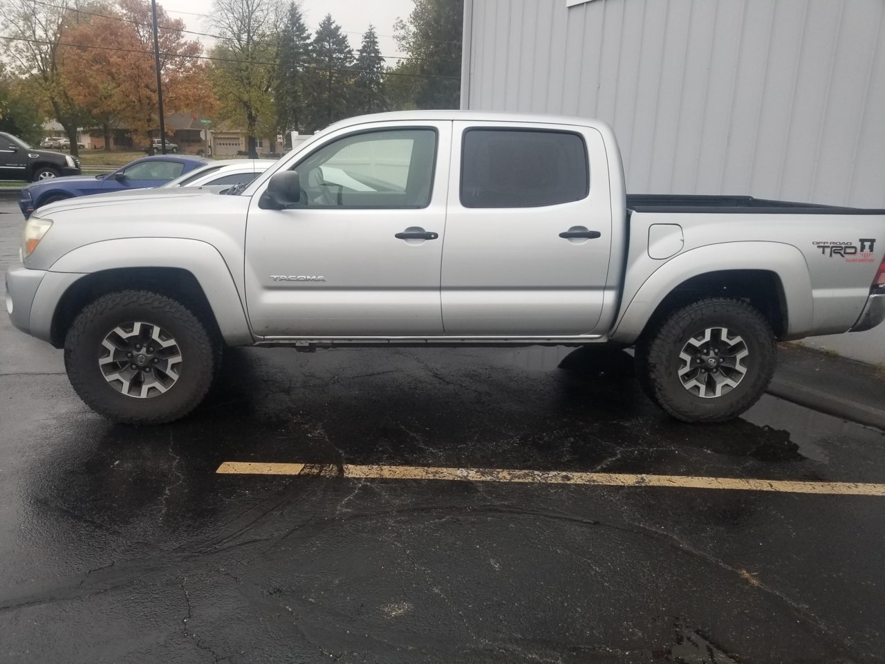

    I just had 5100s installed all the way around and the improvement is incredible. This thing rides like a caddy now. I set the fronts at .85 to allow a little more clearance for my 265\75\16 Wildpeaks since I rubbed a little. I had the rear leaf TSB and pretty bad rake. Normal rake now. Looks stockish. No issues with driving, vibrations, or steering.
    before
    after
