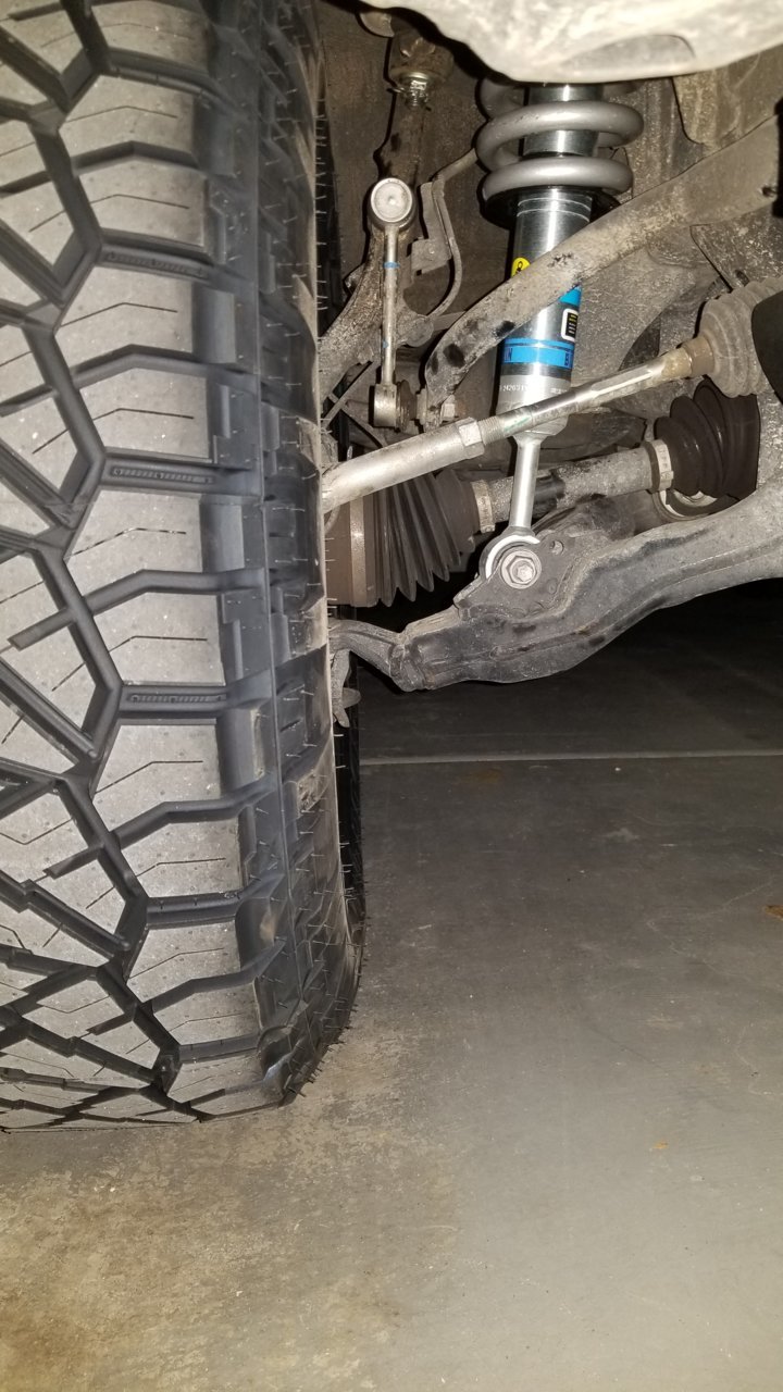

    Here's what's confusing me. Right now I've got an additional lift of just about 3.25 inches. With 5100s set at 0 I'm supposed to get 2 inches. Does it make sense that setting 5100s at top notch only yields 1+ of additional lift???

    Yikes...that's going to be fun soon. Those CV ribs are touching so much it's only a matter of months before they wear through

    Just from the angle of those UCAs I can tell it's not good. What leaf pack are you running considering the fact you have some tires in the bed?

    personal experience is indistinguishable from opinion in cases like this. The truck is governed by non-negotioable physics and reality. The parts literally can only adjust so much, or articulate so much, even less so when a wacky configuration is wanted by the customer because they saw it online. Its only the perception its "fine" but rest assured the wear and tear is happening whether you want to believe it or not.
    and those people are in the profit business. If they actually CARED like a good brother, they wouldnt even be selling this shit in the first place. Imagine head-strong or whoever sells this stuff putting up a blocker at "check-out now" if customer had "bilstein 5100 on the 4thclip and block spacers" or whatever other kit in their cart. They would probably do 80% less business at that point. Its just the reality of the business. Complete snake-oil sold to under-educated customers.
    ALL suspension upgrades necessitate alignment. You cant hand-wave this away. Also, a tech handing you a "its good!" sheet from his align-o-matic 3000™ computer does NOT MEAN it was a "good" alignment that is not blowing your CV's, ball-joints and drive-line to pieces. It would sure suck to get "30,000 miles just fine" of driving subtracted off the life of the truck because you skipped the upper-control arms during a a lift. Thats how big of an impact UCA's make for a lift 2"+.
