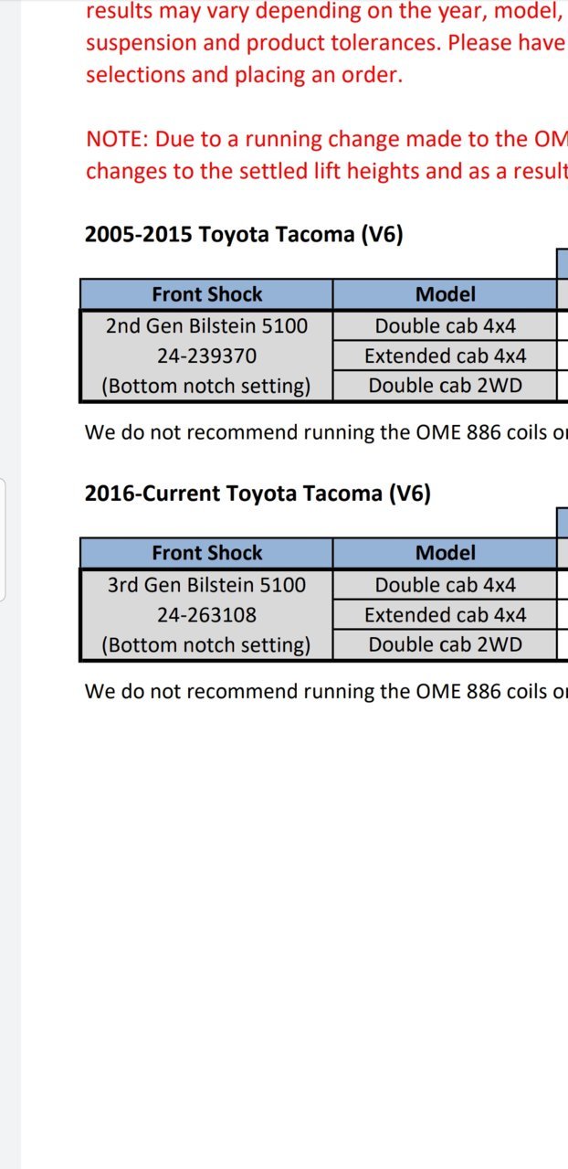

    Jasonstacoma
    Jasonstacoma Well-Known Member
    Jul 13, 2019
    #299186
    1,378
    Jason
    2019 dcsb Barcelona red
    Stock
    Headstrong reccomend setting at bottom notchScreenshot_20200125-185336_Drive.jpg
