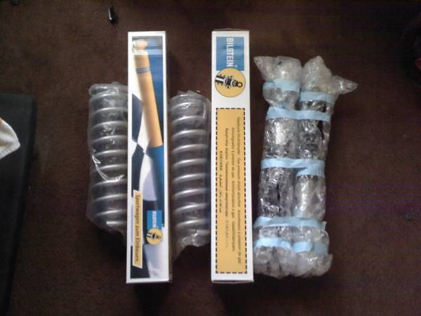

    just need to install them now

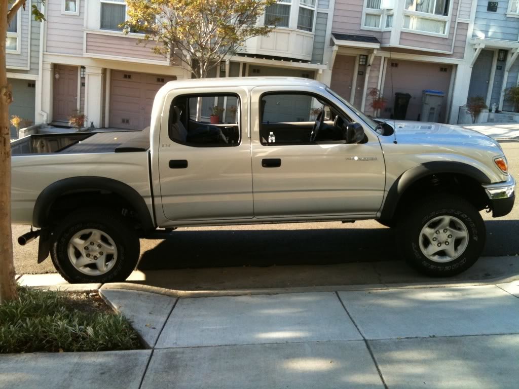

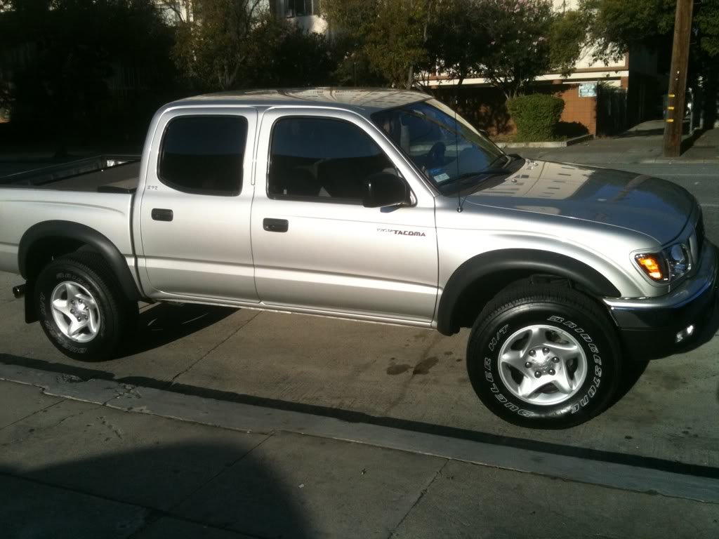

    Before
    After

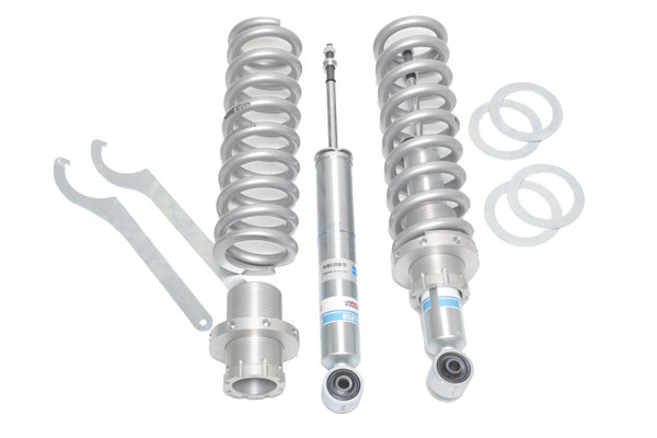

    Is this the kit I would need for an 02' Taco, do I really need the sleeves and wrenches or could I get just order the coils and shocks seperate, seems to be cheaper that way

    you dont need the wrenches unless you but the preassembled coilover.
    5100's + eibach coils is the setup we're talkin about here
    and you don't need the dust boot. I dont run them and havent had a problem, even when wheeling

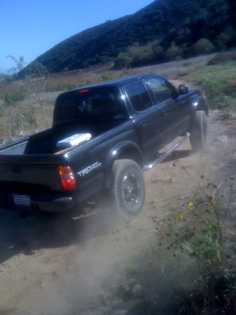

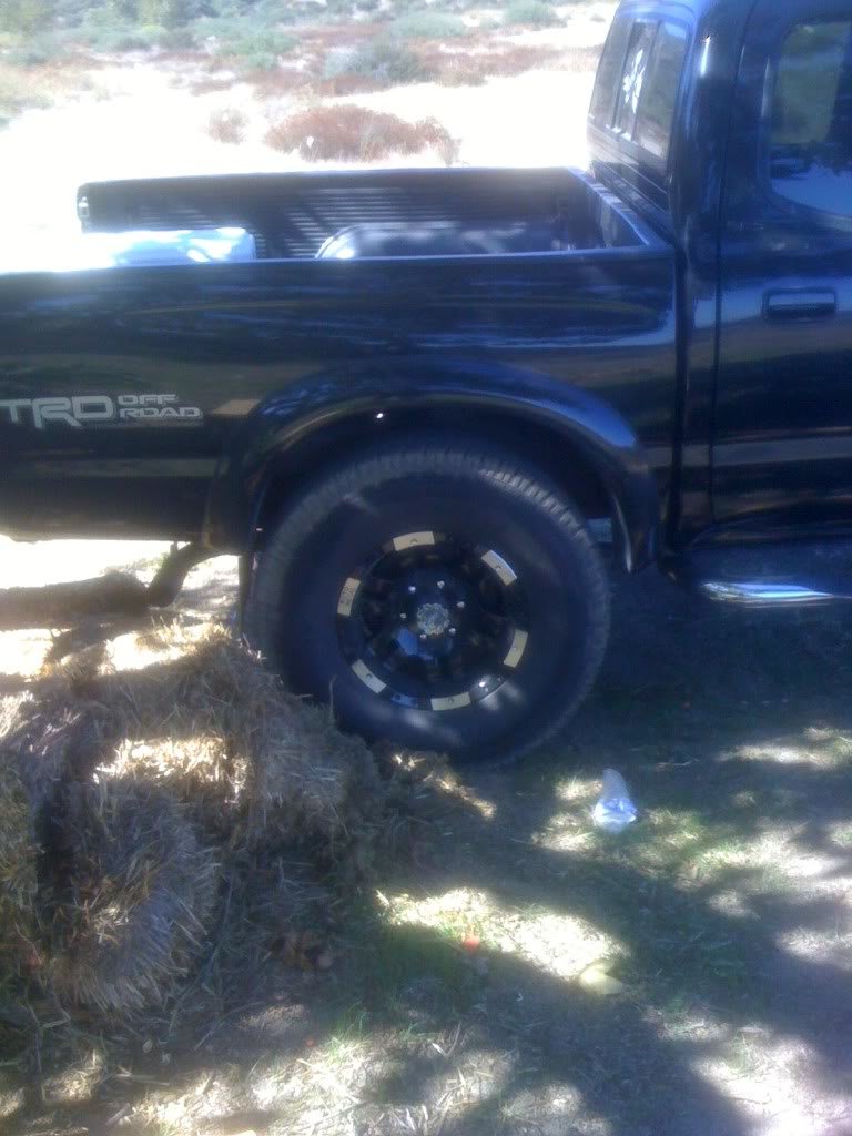

    Haha, I had to take them off about 10 minutes before that photo was taken. That was the first trip out with the tires on. I knew I was going to get some rubbing but it was a bit worse than I thought. The tires grabbed the front of the rear flare and started bending my bedside out. I've cut the fenders since then and no more rubbing.
