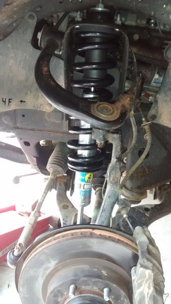

    hey, hope someone can help. I have a 2013 tacoma 4x4. Bought a Bilstein 5100 kit. It's supposed to give 2.5" of lift but after install ended up with about 6" of lift and the upper control arms are hitting the springs. What did I do wrong?

    using stock springs, went down the the lowest notch on the shock and still about 5" higher than it was stock

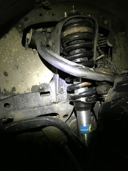

    This is how your spring perch should look

    If it looks like this it's wrong

    The bottom cup is installed properly but it seems as tho the upper arm is stuck between the coils on the spring, nfc how that happened but is the truck currently on jack stands or is is sitting on the ground?

    look how long the lower shock body is. Did they send you the proper fronts

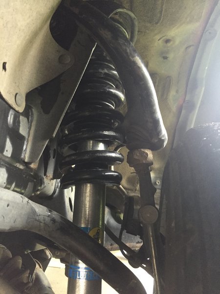

    This is what they are supposed to look like

    No its right side up. Any other ideas?

    yes stock coils, picture is taken sitting on the tires. Part number Bil 24-232173
