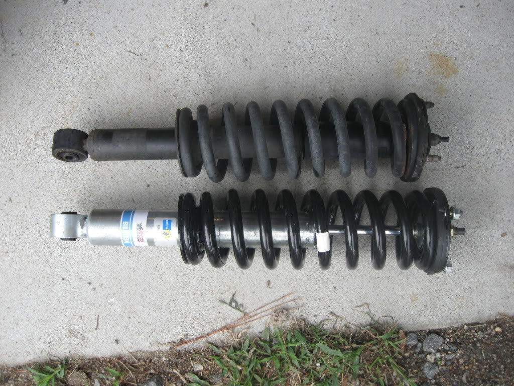

    I got bored yesterday and installed my Bilstein 5100 plus OME 880 coils. Looks good. I will have to get some pics when the weather clears up.
    Here is a comparison of my factory shock and coils with the bilstein/ome combination.

    Much better. ;)
