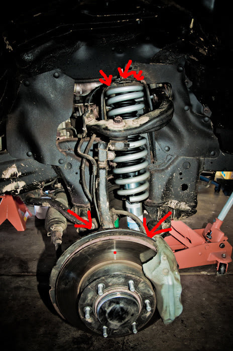

    Ok first thing remove the three 14mm bolts at the top of the strut.
    then remove the bolt holding the sway bar. Now remove the big bolt at the bottom on the shock I think it a 19mm it's might be a 21mm I don't remember. After that the strut should come right out.

    You had to remove the sway bar bolt to get to the nut on the lower end of the shock? I didn't on mine as a standard open ended wrench would fit in there just fine and the sway bar really doesn't get in the way. Doesn't hurt anything though, although it might end up being a pain if the nut doesn't come off clean (and ending up twisting the ball forever).

    I think it could of been done without removing it but we did anyway for more room.

    i removed the sway bar and link.....undid the tierod......take old out compress it.....install 5100 into coil......install onto truck by prying down on the LCA and using a spoon tool that is for changing dirtbike tires......torque to spec

    Also I removed the brake line clips so I could move it out of the way

    just changed mine this weekend remove the sway bar disconnected the lower control arm with two nineteen millimeter bolts, made life alot easier... kept the tierod intact...still a pain to remove but a coil compressor helps to get some of the tension off of the spring

    you can do the front without removing the sway bar or tie rod or anything. I used the toyota jack to push down on the UCA from the wheel well to get enough room to get the coil and shock back into position and the lower bolt to line up.

    I did replace the coils, and did did disconnect the the sway bar link It was a bitch getting the lower shock bolt back in, the sway bar disconnect helped, other than that it was a pretty simple install.
