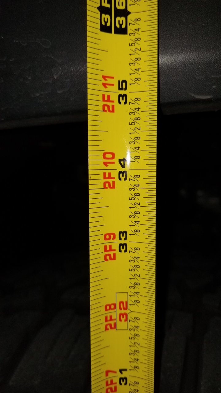

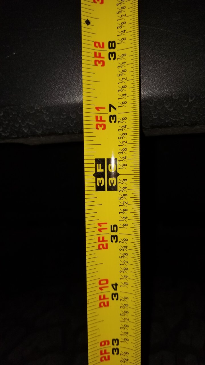

    I've been scouring the forum the last couple days but now I'm just feeling more confused. I'll be installing 5100s on the front only (for the time being) in order to "level" out the truck. I know the consensus to be, if you're installing 5100s on the front only, most go with .85 setting to give about a 1" lift. When I took measurements of drivers side front to back, I'm looking at about a 2" difference. So, my question is....in my particular case, wouldn't setting at the 1.75 put me closer to level +/- a degree from front to back?
    FYI 2016 OR DCSB Thanks!
    FRONT
    BACK

    Measuring the body is an illusion floor to frame is what needs to be level.

    *Forgive my ignorance* So, measuring from "floor to frame" would give me something other than the (close to) 2" difference?
    That would only make sense! :thumbsup:

    measurements should be taken from middle of wheel to bottom of fender> it eliminates improper air pressure and weight loading on tires
