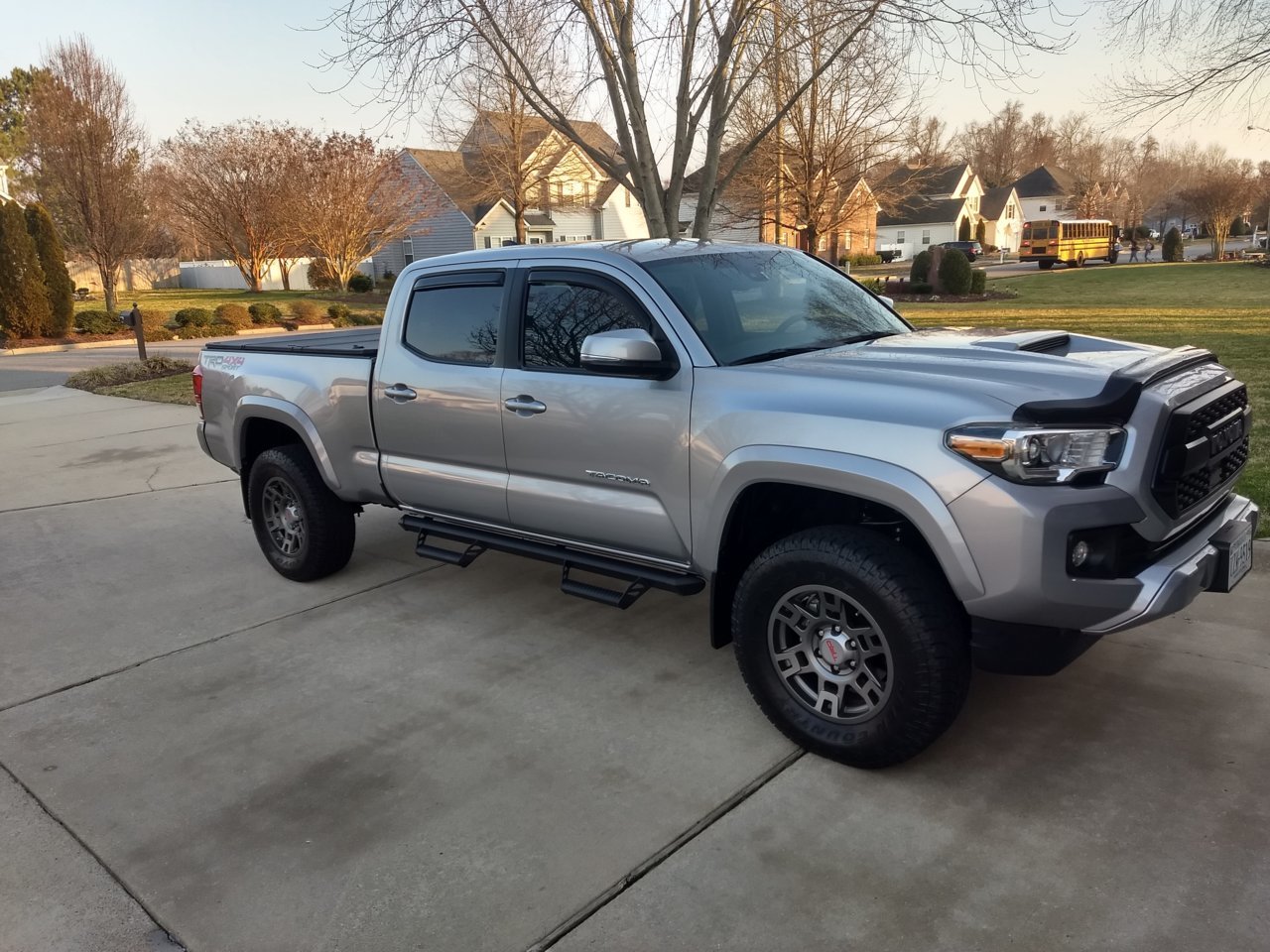

    Bilsteins 5100s on the top setting, 4runner Gray TRD Pro Sema wheels, 285/70/17 Toyo AT3s, Sumo Bump stops, TRD exhaust, ECGS Clamshell bushing, 1/4 shim for the lean and one inch rear block, OEM Pro grill and garnish OEM TRD Skid plate, TRD CAI, Demon Brackets, Rigid Industries Pro fog lights, OEM Trail Rails sidebars, Diode Dynamics LED SL1 high and low beam lights, OEM Roof racks, Clazzio leather heated seats, Remote Start, TRD Pro shift knob, tinted windows, Rockford Fosgate 4 channel amp for the headunit and sub and amp combo, OEM Puddle lights, OEM tailgate lock, OEM bed mat, LED interior lights, OEM blackout kit for letters, JLT catch can, upgraded 27F toyota True Start battery, Vleds led tail light kit with Pro tail lights, OEM Rave4 side mirrors with convex spotters,just to name a few mods.
    Not true, Im running 5100s on the 4th perch, stock springs and the ride is more plush than my stock Sport shocks. I have been in a close friends 16 Sport with the 5100s, ome colis and they ride about the same. He is ridding on 285s on aftermarket wheels and he does not rub. I drove his dclb all over the beaches of North Carolina and not a single rub. It really depends on the wheel and offset. You can use stock springs and it will still ride fine.

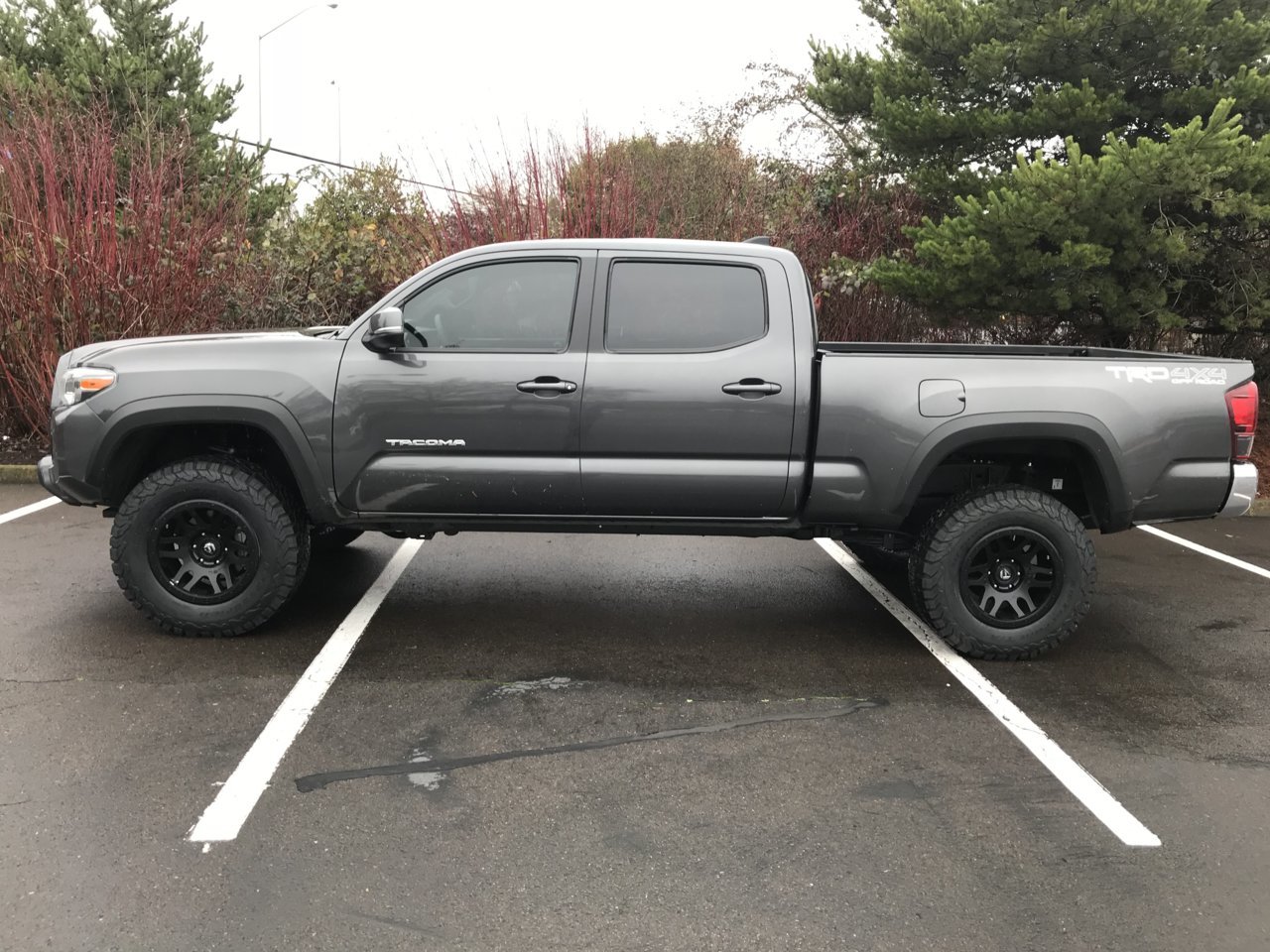

    Bilstein 5100s set at 0, 888, Dakars, SPC Light Racing UCAs, CBC, ko2 275s
    0399608B-23A3-453E-A432-AE79F598C60F.jpg 10A2AB14-B4BF-4253-BFF4-5ED42FBBA94F.jpg

    Also I forgot to mention it didn’t settle much if at all after the lift. I also wanted to maintain the rake the truck had from the factory although I know most people like to see it sit level. This should still give you an idea though of how it will sit a variation of the setup you’re looking at.

    Truck looks great man! Pretty much what I’m going for
    One in block and almost level with a very slight rake.
