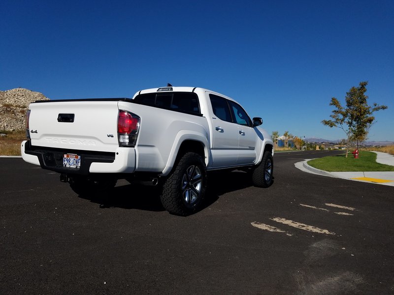

    billies set at 1.75 front and 1 inch block in the rear. 285/65r18 nittos
    I have the 5100s set at 1.75 on stock coils. The ride quality is awsome. Much better than stock. 1 inch block in the rear and set me with a tiny rake. I am also running 285/65r18 with only having to trim my air dam.

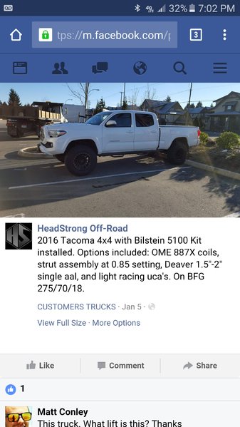

    Here is a picture of the 5100s set at .85 setting, second notch...never go to the highest notch. With the 887 coils on the .85 setting will get you close to 3" of lift. Set at the 0 setting with 887 coils will maybe get you 1/2 inch. If you got 888 coils with 0 setting, it would be roughly a 2.5" lift.

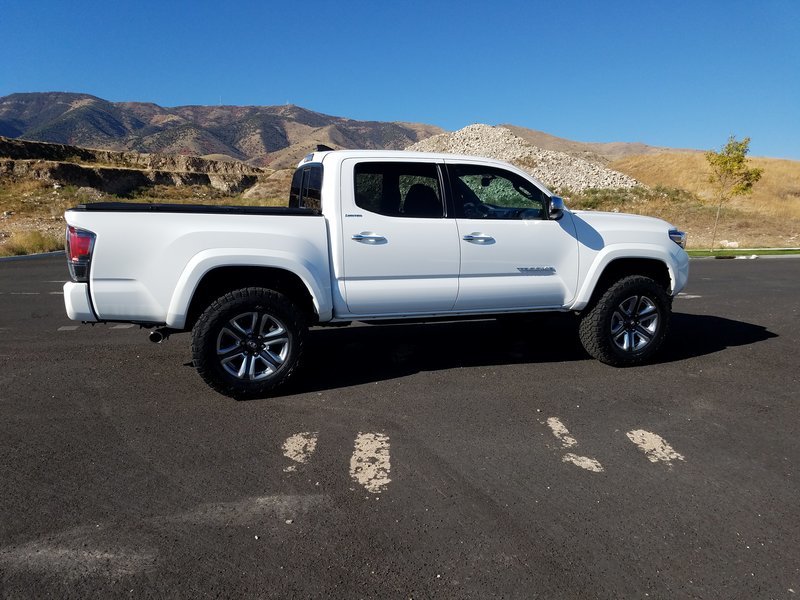

    Here is a pic of how my truck sits.
