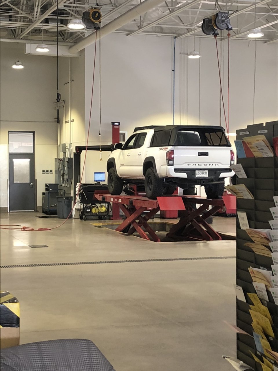

    Dont forget to get an alignment done
    100 bucks is alot less then 600+ for 2 new tires 7700CD93-47F0-45B1-A1B5-2A23709548D6.jpg

    You know, I was kind of being cheap and trying to avoid that, but I think I'm going to go do it. Thanks.
