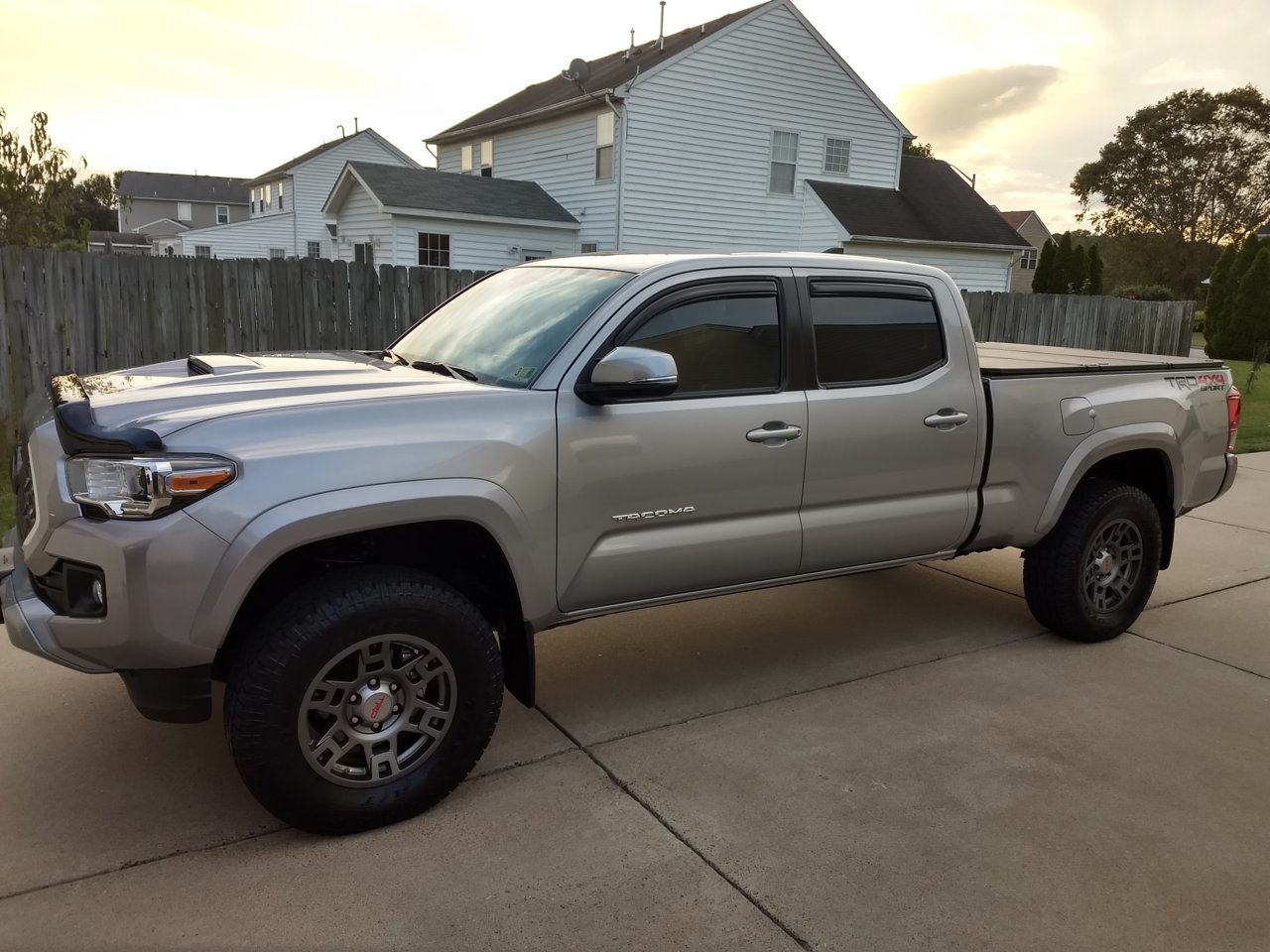

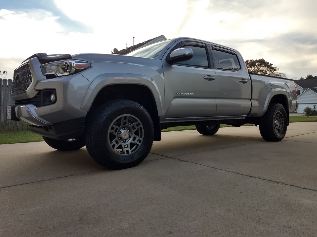

    Here you go. 5100s on the next to the top setting, factory coils and ucas, one inch block in the rear, perfect allignment, rides smooth, handles better than stock, added some 265/70/17 SL Toyo open country at2 on TRD pro Sema wheels. No rubbing, no issues and didn't break the bank. Still getting the same gas mileage , gained about 3 inches in the front and a little more than an inch in the rear after the larger tires. The speedo is dead accurate. Imo it's a great way to have a nice lift, capable of doing what I want off road if I decide to go, and looks great!IMG_20181009_175704107_HDR.jpg IMG_20181009_181855269_HDR.jpg IMG_20181009_181822806_HDR.jpg IMG_20181009_175704107_HDR.jpg

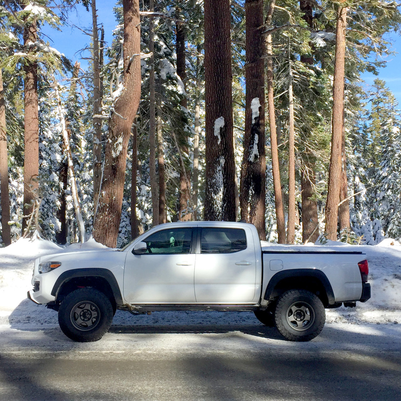

    2" OME Lift, 285/75r16, sliders
    I went from 5100's on stock springs to the OME lift. I love the OME lift and went with the heavy setup in anticipation for bumper and winch. I saw major improvements offroad. Even without the bumper and winch I don't believe its too stiff. Its a truck, its going to be stiffer than a car or suv. If you're anywhere near AZ I still have the 5100's and ill let them go for a good deal.

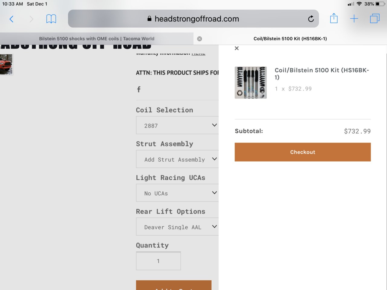

    Look at http://headstrongoffroad.com/

    That’s the lowest price I’ve ever seen for that combo

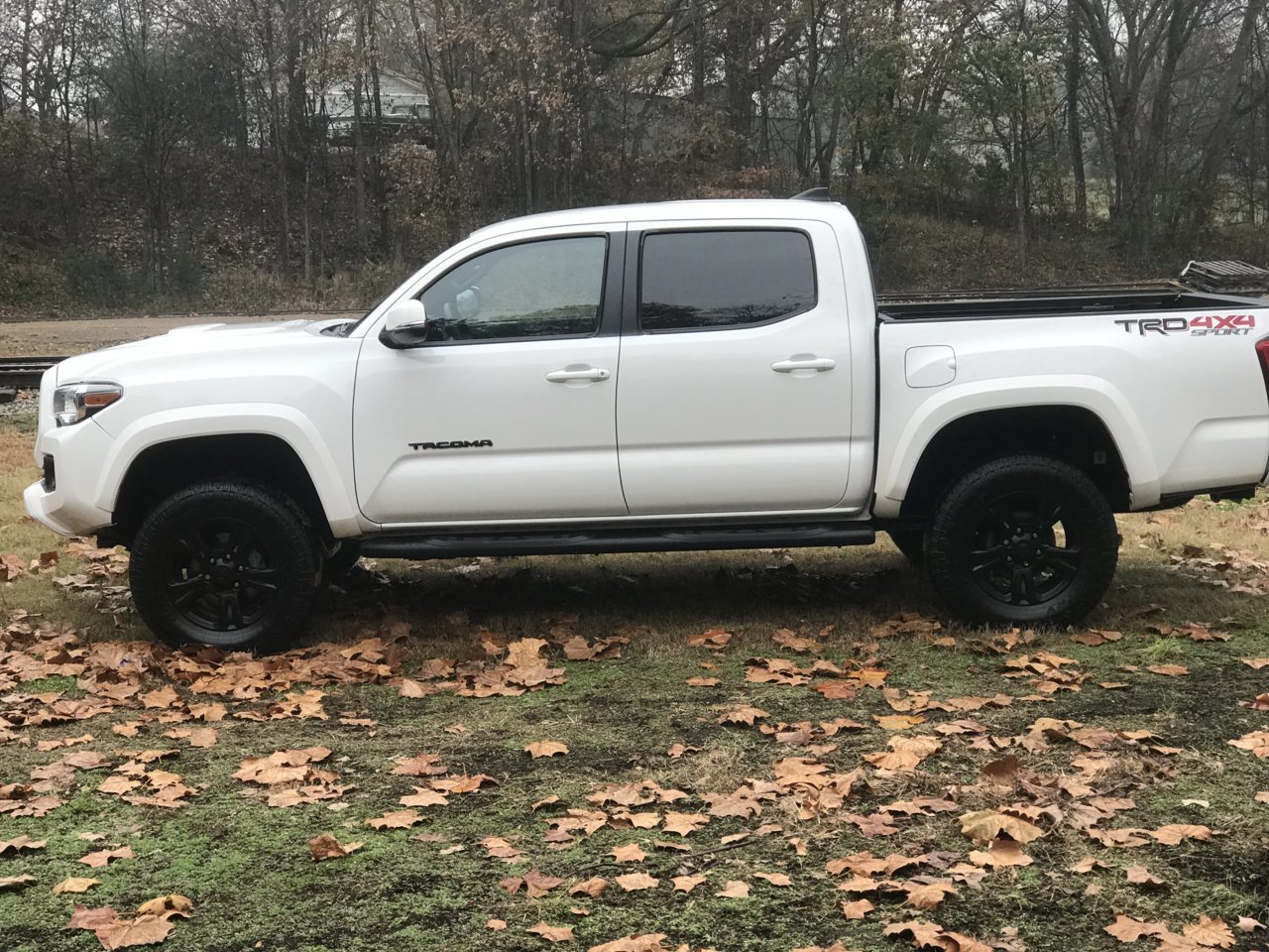

    6090411A-3E53-4278-9364-D9AD213075DF.jpg This is what I bought with the strut preassembled
    This doesn’t come with new ubolts ... some say you can use the stock ubolts but I put on new

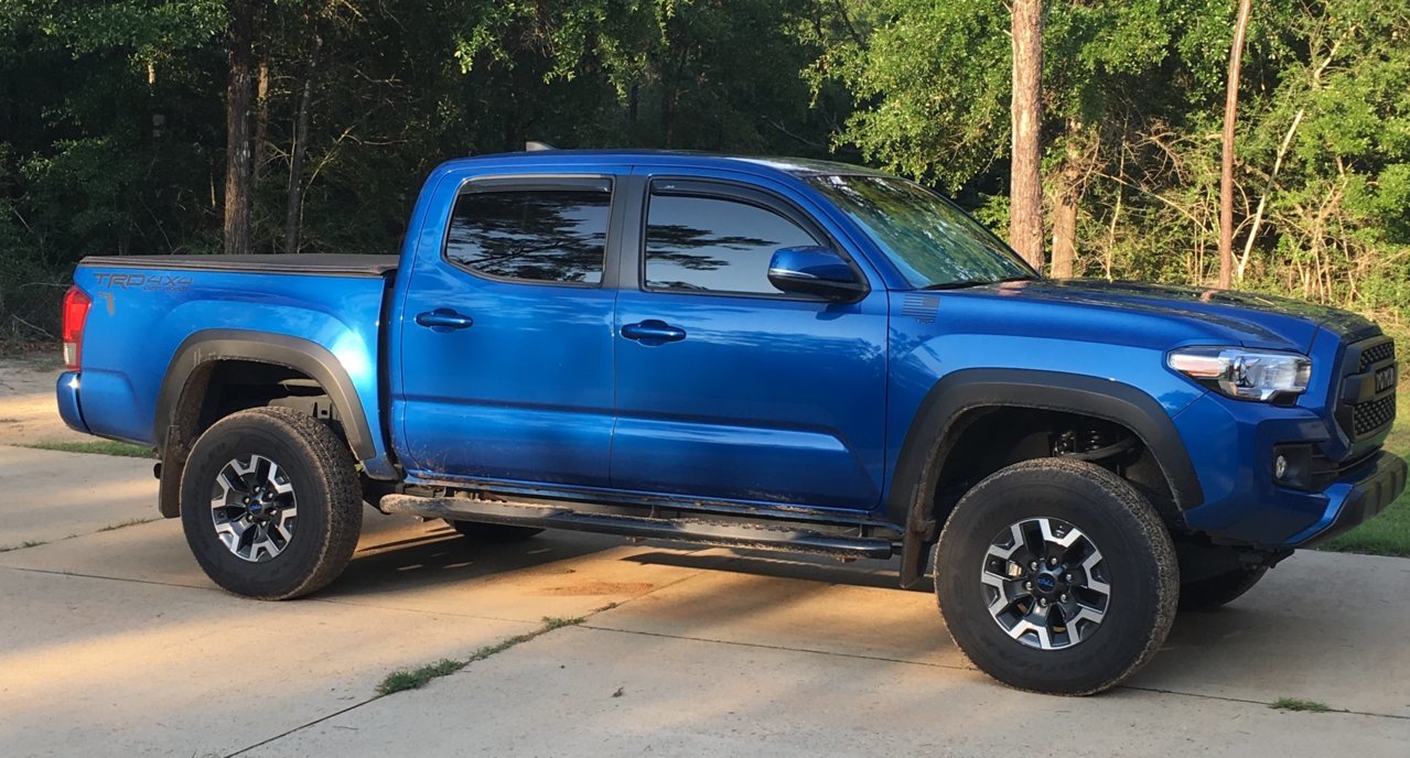

    1E8FC273-E091-4E51-8408-05FDD5AE583D.jpg Bilstein 5100 front and rear with OME 888 front springs and deaver AAL w .25” driver side spacer

    It was level but the front settled so the front is about 1” lower than the rear
    LF 37”
    RF 37”
    LR 38”
    RR 38”
    Edit: I would have gone with the 888s if I knew what I knew now

    I got 2.65” in the front with the 888s after settling. I got 2.05” in the rear with aal. The ride at first was really firm but has since settled and I’m very happy overall with both ride and looks. It’s still firmer ride than stock was but it’s what I was looking for. Less roll in turns and feels very secure and smooth on pavement imo
