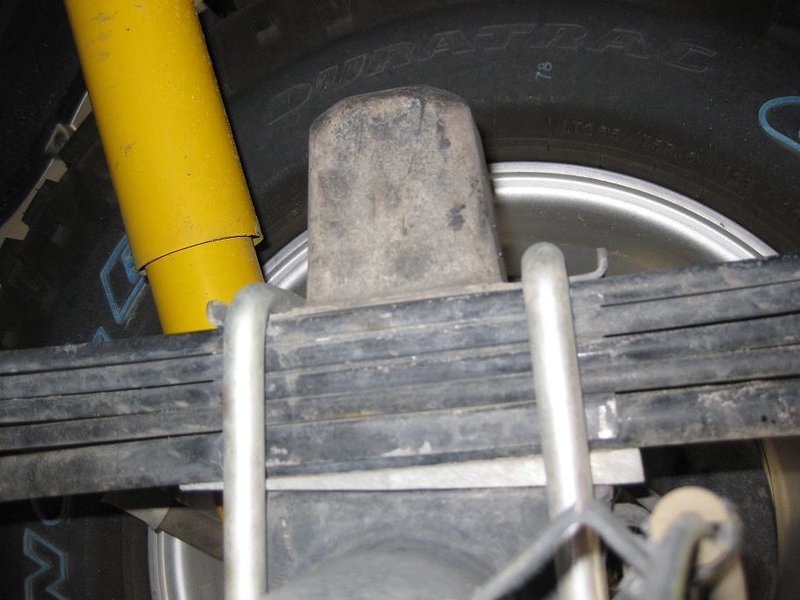

    Could someone tell me what the shim is for in the spring? Would I need this or carrier bearing with a two inch lift?

    Here is a selection of shims from Headstrong Offroad
    https://www.headstrongoffroad.com/store/p119/Axle_Shims_-_(2_degree_to_4_degree).html
    Typically you calculate 1 degree shim for every inch of lift so for 2 inches expect to go 2 degrees.
    You would need to shim if you have vibrations, you CAN shim as a preventive measure whether you have vibes or not.
    Here is a pic from TW that shows installation.
    Picture from this thread
    https://www.tacomaworld.com/threads/advise-for-install-axle-shims.71454/
    I did not need to shim or do anything with the carrier bearing as I did not have any vibrations after install. I have 2 degree shims onhand in case I develope vibrations.

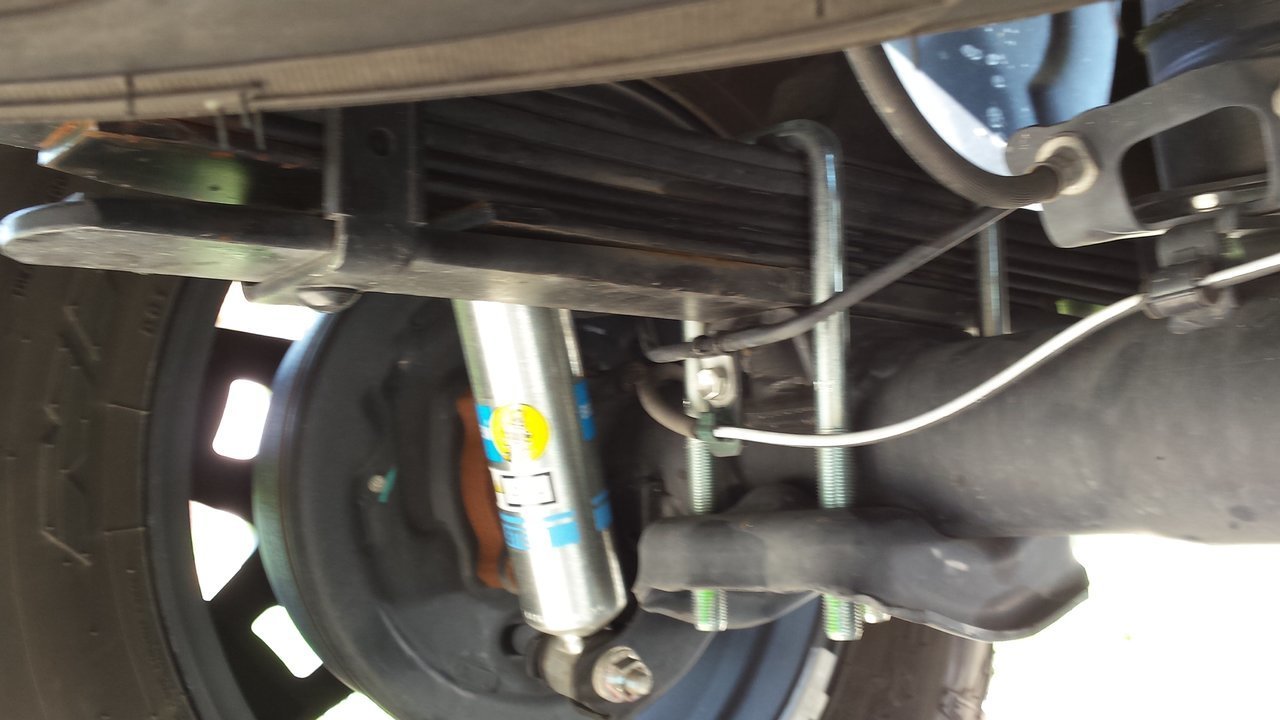

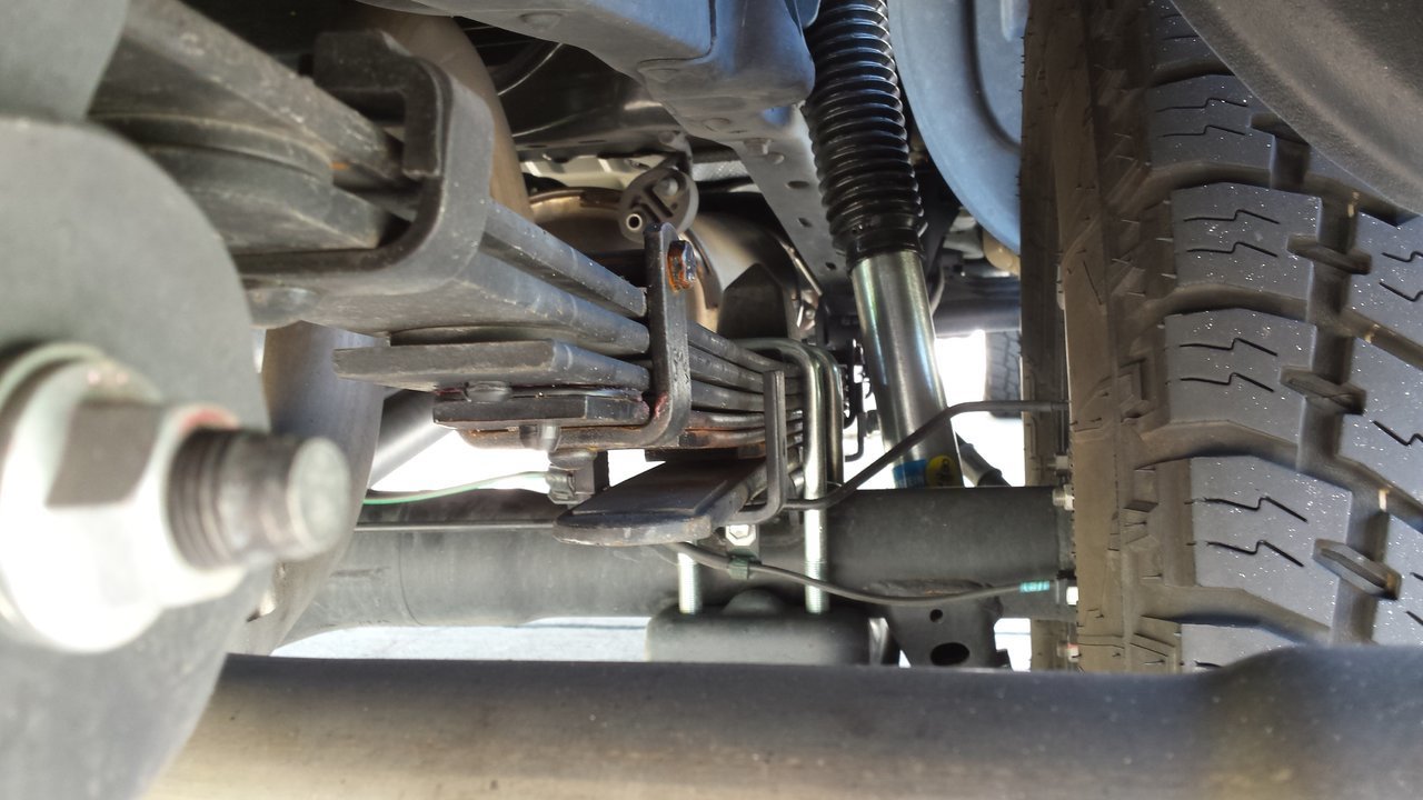

    Put the shim in when you do the AAL, both will go under the stock leaf pack.
    Heres a pic of my setup without the shims, bottom leaf is the overload, then the 3 leaf AAL then the stock leaf pack.
    Shims would be placed between overload and axle.
