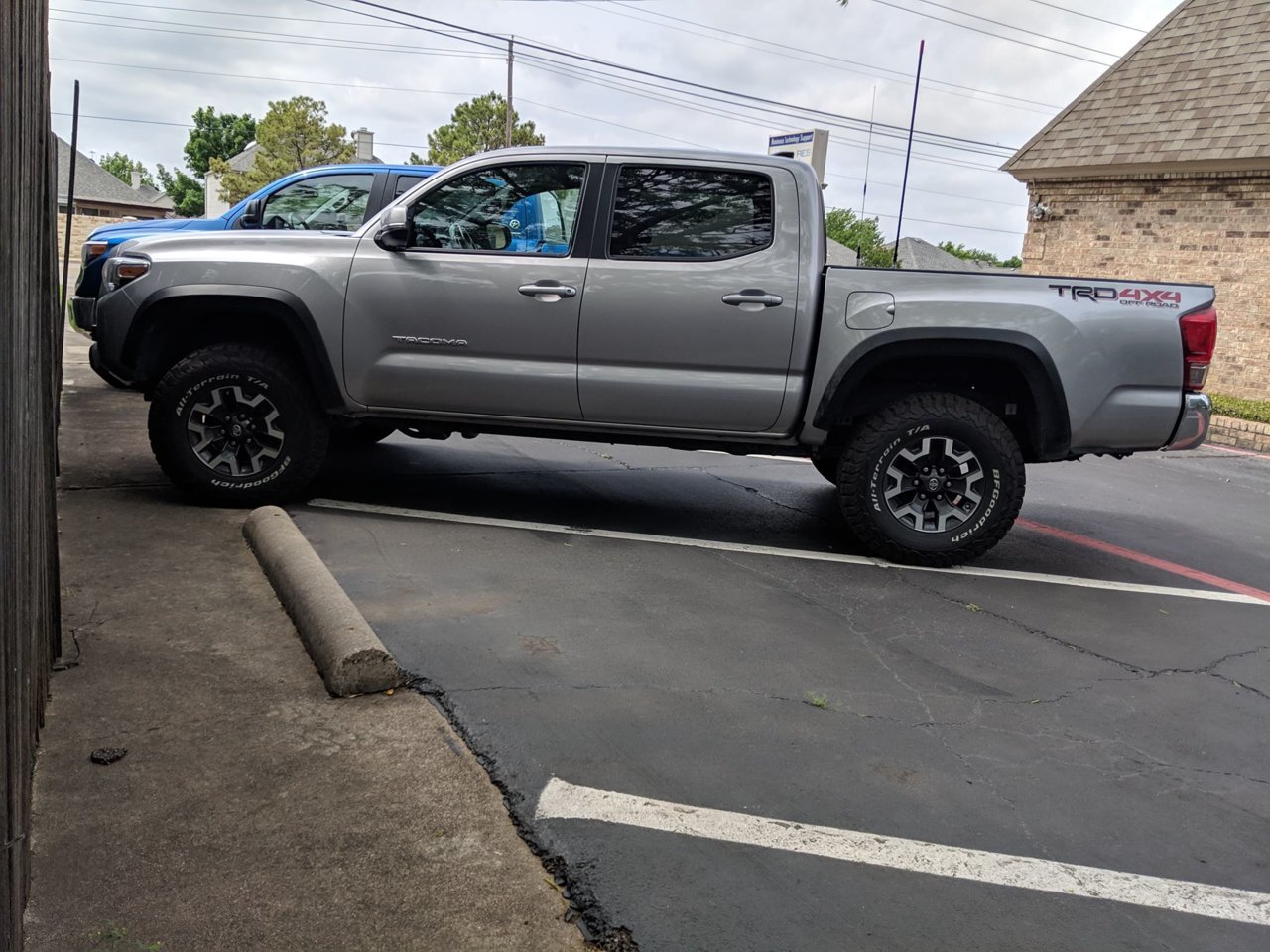

    I'll take a side-on pic of my truck at lunch today. I have OME 885s, Icon 3 leaf AAL, and 5100s all around on 265/75/16s

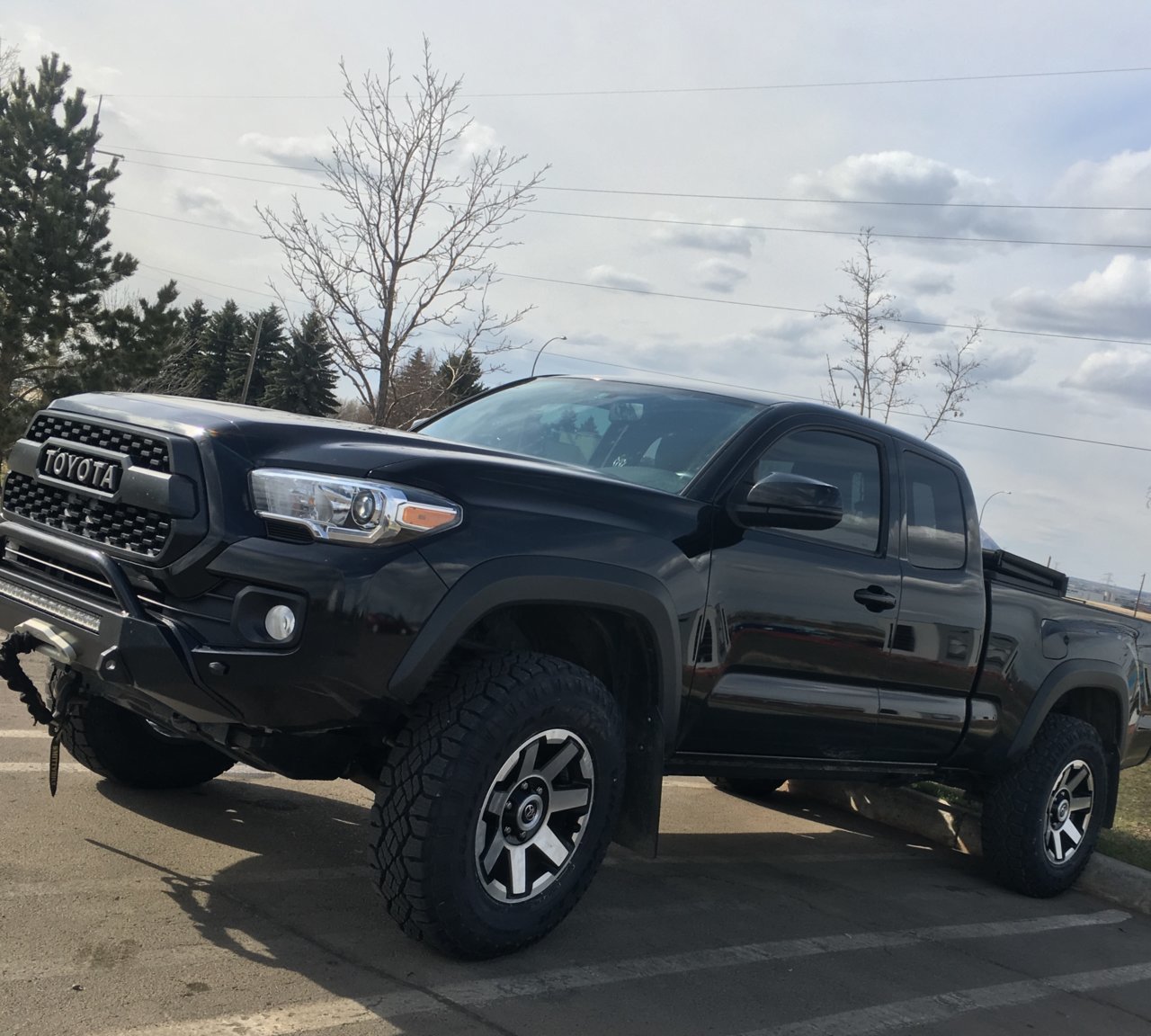

    900
    Shawn
    Crowsnest Pass, AB
    02 Taco RCSB, 16 Taco AC6MT, 07 FJC, 22 Bronco
    T4R Trail Edition
    trabo[QUOTED] likes this.
  15. May 9, 2019 at 8:37 AM
    #55
    trabo
    trabo Well-Known Member
    Dec 26, 2016
    #205704
    264
    Los Angeles
    2017 Silver DCLB OR
    I like them a lot. It's funny, your post was the first time I had seen them, and then I saw some in the wild yesterday.

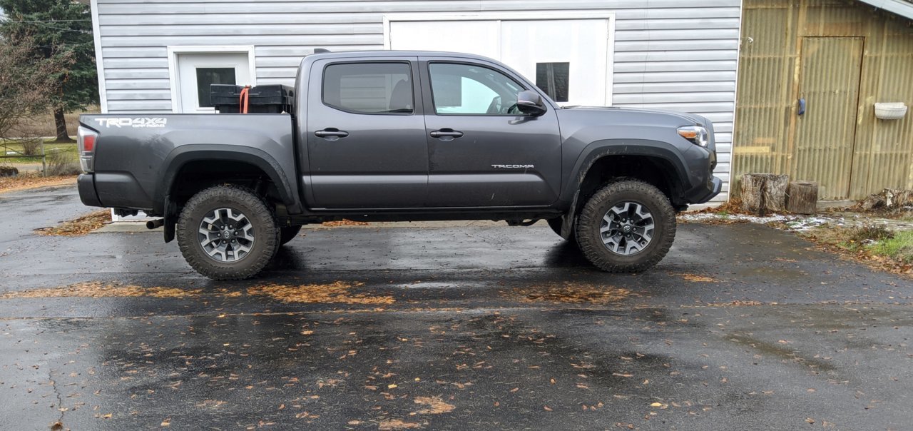

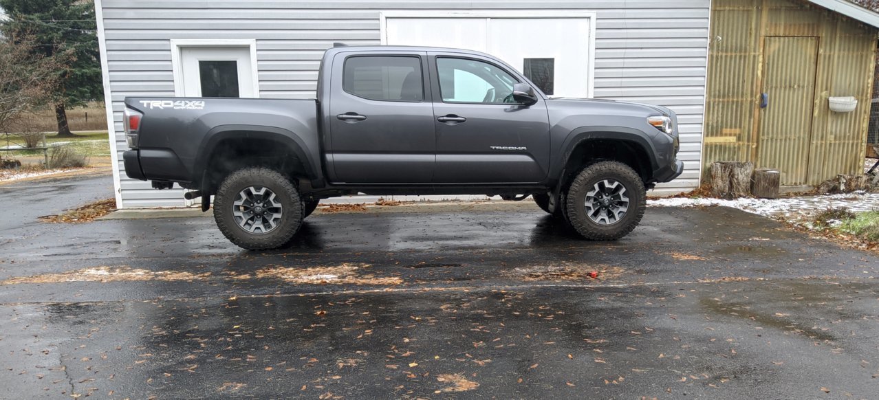

    Parts Unknown
    2018 TRD DCLB Sport 4x4 Silver Sky

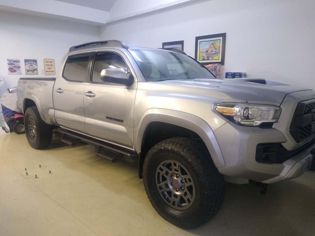

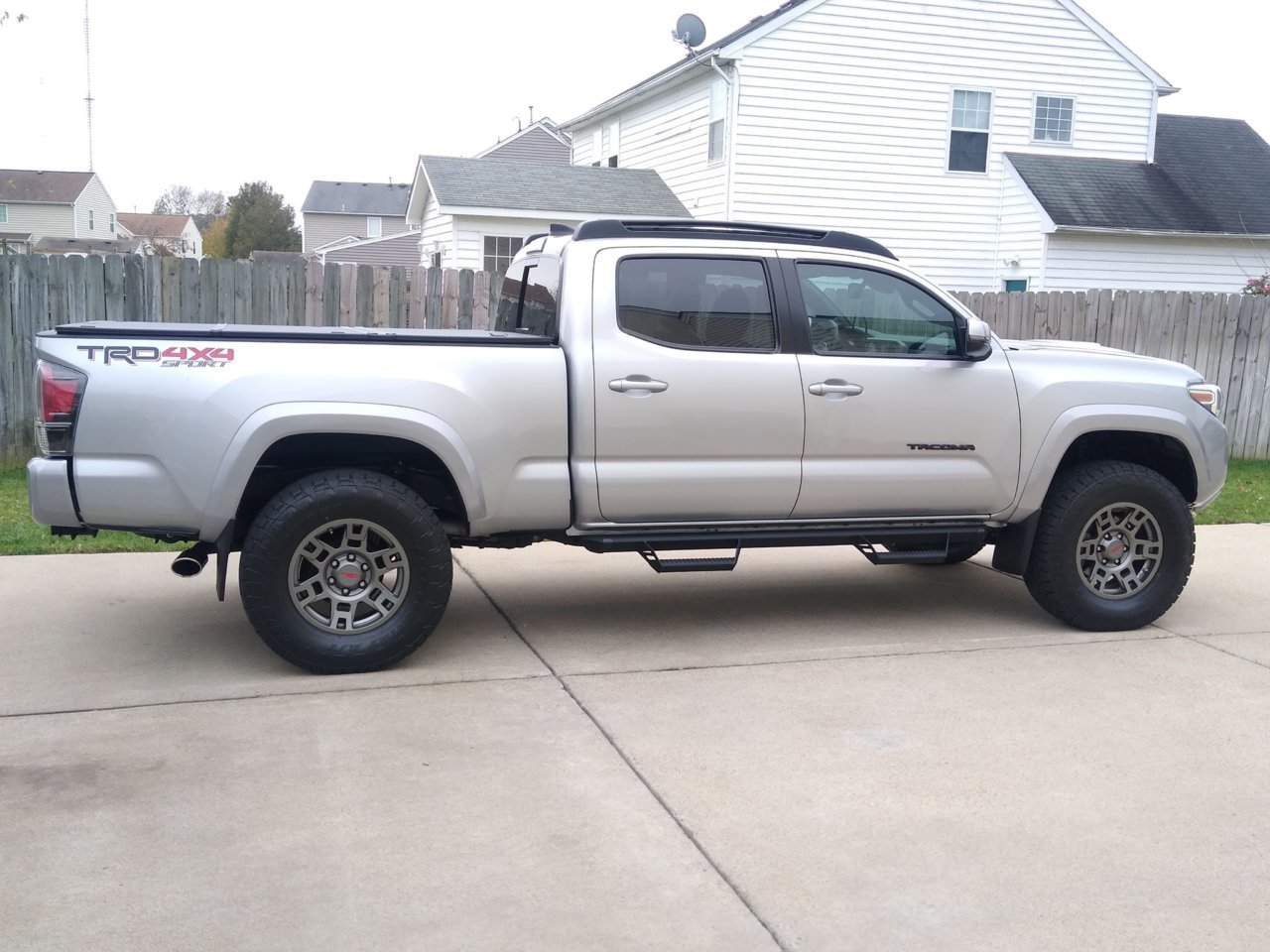

    Bilsteins 5100s on the top setting, 4runner Gray TRD Pro Sema wheels, 285/70/17 Toyo AT3s, Sumo Bump stops, TRD exhaust, ECGS Clamshell bushing, 1/4 shim for the lean and one inch rear block, OEM Pro grill and garnish OEM TRD Skid plate, TRD CAI, Demon Brackets, Rigid Industries Pro fog lights, OEM Trail Rails sidebars, Diode Dynamics LED SL1 high and low beam lights, OEM Roof racks, Clazzio leather heated seats, Remote Start, TRD Pro shift knob, tinted windows, Rockford Fosgate 4 channel amp for the headunit and sub and amp combo, OEM Puddle lights, OEM tailgate lock, OEM bed mat, LED interior lights, OEM blackout kit for letters, JLT catch can, upgraded 27F toyota True Start battery, Vleds led tail light kit with Pro tail lights, OEM Rave4 side mirrors with convex spotters,just to name a few mods.
    Therey are the stock uca. I have since went to the top setting, new alignment, added some 285/70/17 Toyo At3s and it rides even better now. Did a speedometer calibration from rough country and updated the tune to the new kdmax pro 9. Still no rubbing, no trimming and gas mileage is still around 18 give or take a little. IMG_20221222_140310731.jpg IMG_20221115_125747460.jpg
  18. Feb 16, 2023 at 1:07 PM
    #58
    Shotgunridge
    Shotgunridge Well-Known Member
    Mar 22, 2022
    #393246
    85
    2022 MGM Tacoma SR5 4x4 - Double Cab 6ft Bed
    OEM Blackout Emblem Overlays, OEM Tonneau, OEM Mudflaps
    That’s a good setup. Glad to know stock UCAs are fine. I read so many mixed reviews on stock springs and UCAs on TW. It’s prevented me from installing my 5100s for the past 6 months. I’ve been torn on the UCA, springs, and block conversations.
    VaToy[QUOTED] likes this.

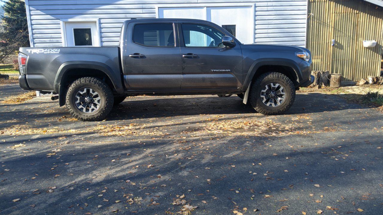

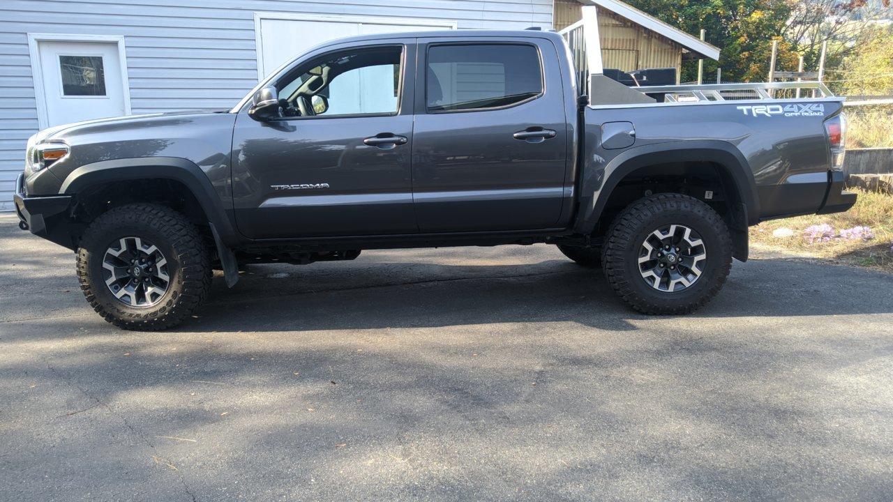

    I hated the stock TRD OR suspension and changed it at 1500km. I had the same suspension on my 2nd gen and really liked it so went with the same on the 3rd gen. Later added the airbags because I always have a load in it for work in the bush.
    stock TRD OR suspension with 235/85/16
    with OME 886 and Dakar HD nitrocharger shocks
    OME/Dakar HD and a load in the bed
    As it sits today with added air bags. front and rear bumpers, winch, skid plates, head ache rack and a a load in the bed
