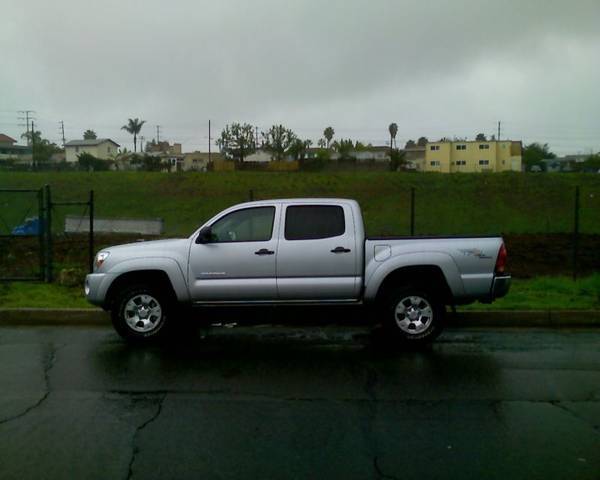

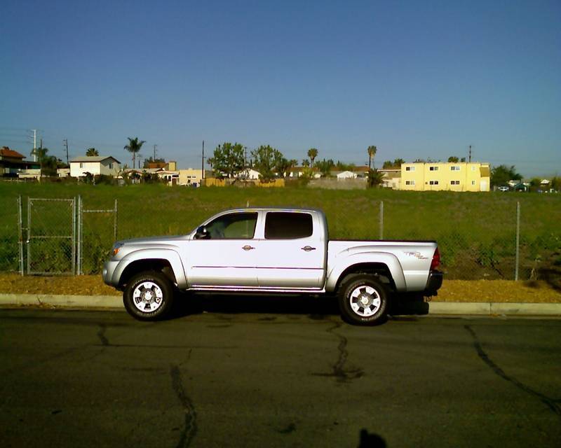

    I upgraded the shocks to Bilstein 5100s. I received the TSB which raised the back end. I had the 5100s put on and set them at 2.5". I also installed 5100s in the back. Here's some before and after pictures. The before is hard to see as it was dark and raining.
    After:
    Before:

    Looks like your front-end is a bit higher than the rear....

    You may have done better going with 1.75 rather than 2.5 unless you intend on lifting the rear. From the pic, it sure looks higher in front. If you lift the rear, you risk driveline vibes.

    Nope. It's right on. I have 7.5" clearance on both wheels when measured from the highest point of the tire to the fender well. It probably looks higher because the picture is slightly tilted. I took it with my phone's camera and had the sun to my back so I couldn't see the lcd display real well.

    Yeah I see the shadow in the rear fender well now, which is a bit deceiving. Hey if it makes you happy, then ROCK On..........but for myself, I like the rear to sit at least a half inch higher than the front. Still looks good though.

    you're like me. mine is perfectly level sitting at 2.5 upfront. looks good. i have the same amount of clearance as you do too, or at least i did till i got bigger tires.

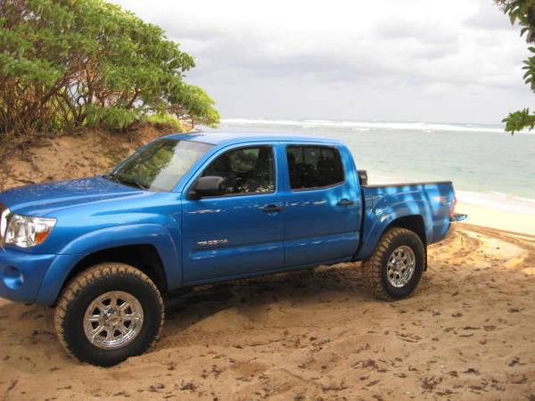

    5100s @ 2.5, tsb rear. 285/70/17 m/t baja atz

    Did you have any trimming with those tires?

    in the front, yes

    So am I seeing this right with the tsb in the rear you added the 5100's with 2.5 lift and leveled it out
