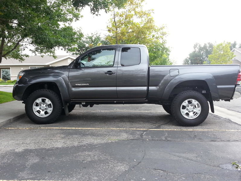

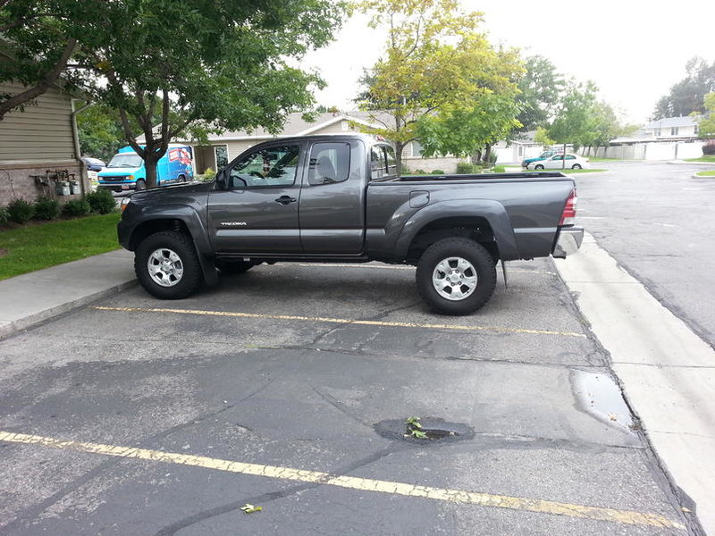

    Here is mine... Just got installed 2 weeks ago. So far love it!! Up front it has eibach coils, 5100 set at .85, 1/2" spacer on driver side, and 1/4"on passenger side. In back it has 1.5" tsb aal and 5100's. 265-75-16 BFGoodrich All Terrains
