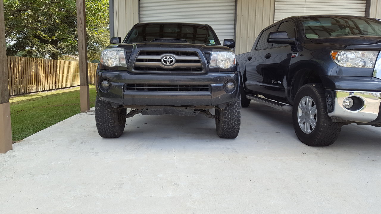

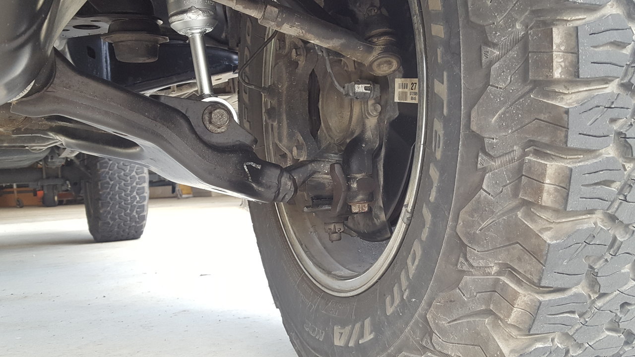

    Anybody have any head on shots of the truck with their 885's and billies? I just want to compare my lower bj angles. I don't have a good head on shot of mine but I have a pic of my lowers. I'll post a pic of the head on shot later when I get the chance.

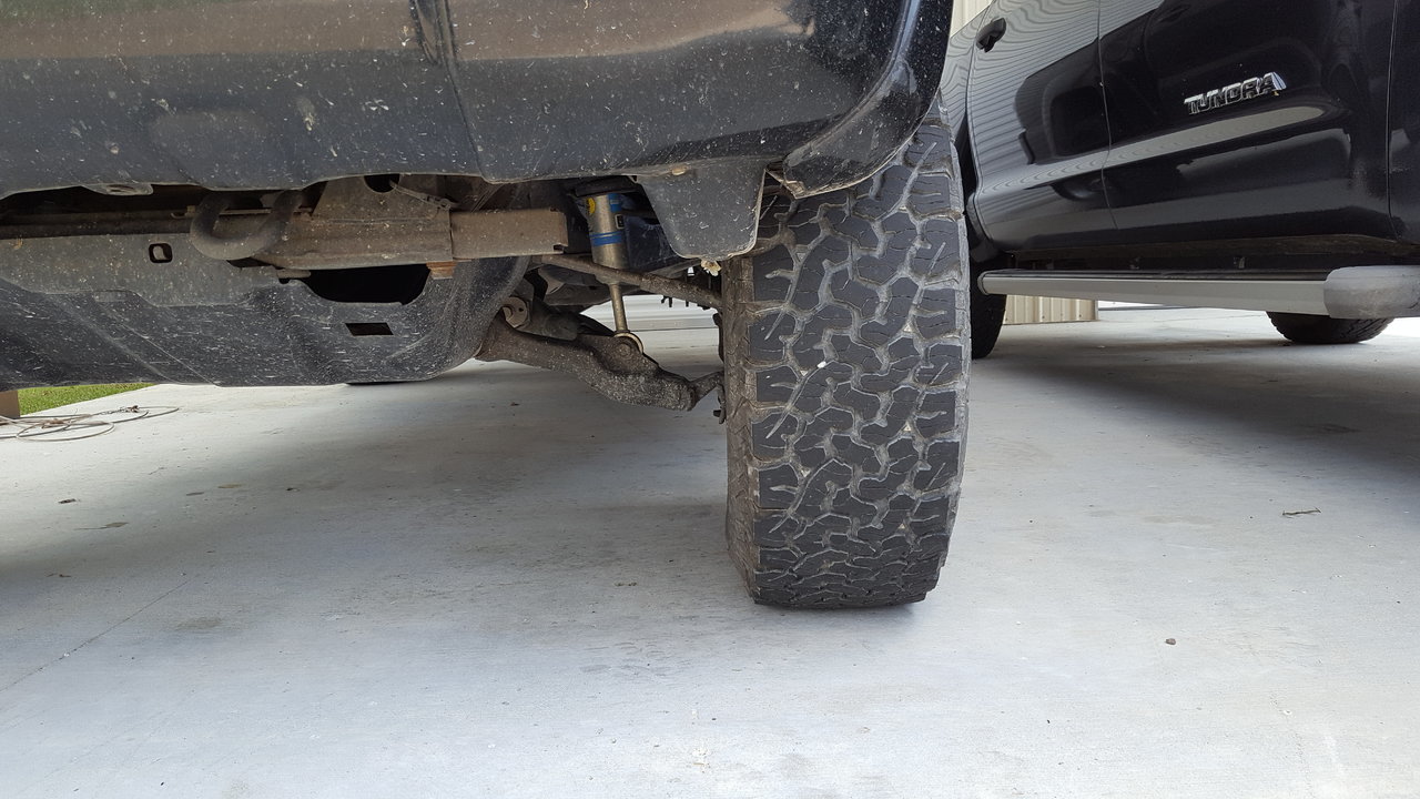

    More pics.
    Also, I'm good on uppers, I've got SPC LR UCAs

    im not so worried about the height. its the thought of having too much of an angle and wearing them down quicker. looking at others with the same setup, it looks like their angles are not as bad as mine.
