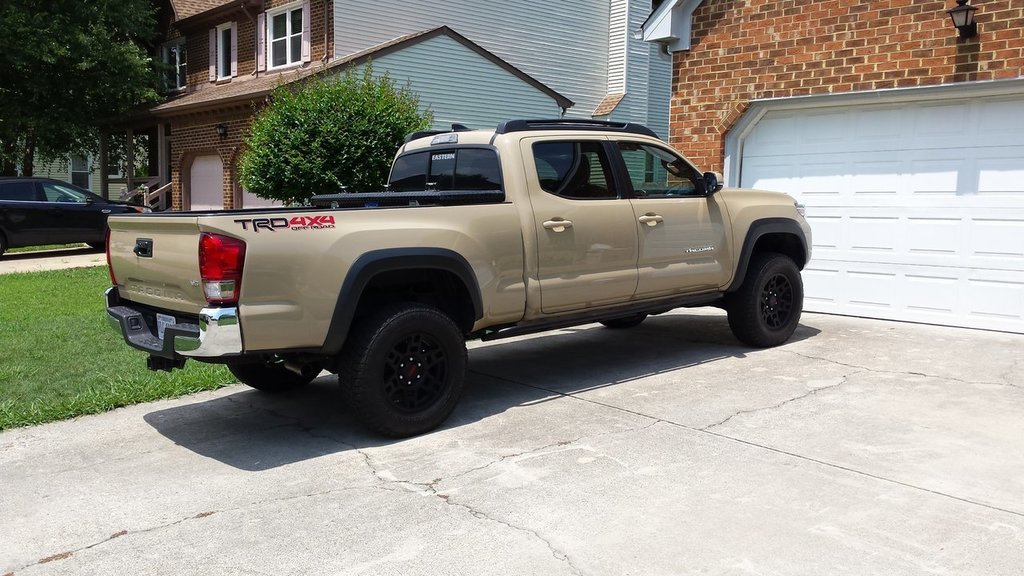

    After 18 months and 20k miles I finally decided to lift my OR DCLB. Before lift pic the stock suspension, tires are 265/70/17 Nitto Terra Grapplers.
    Hard to tell with the slope of my driveway but the rear is about 0.75 inches higher in the rear than front even with the toolbox and 100lbs of stuff in it.
    Here it is on level ground, four days after lift install, front and back have settled about half an inch, 1.75 front and back lifted overall and still retains the factory rake even with the additional weight of the long bed and full toolbox (about an inch higher in the rear when compared to the front).
