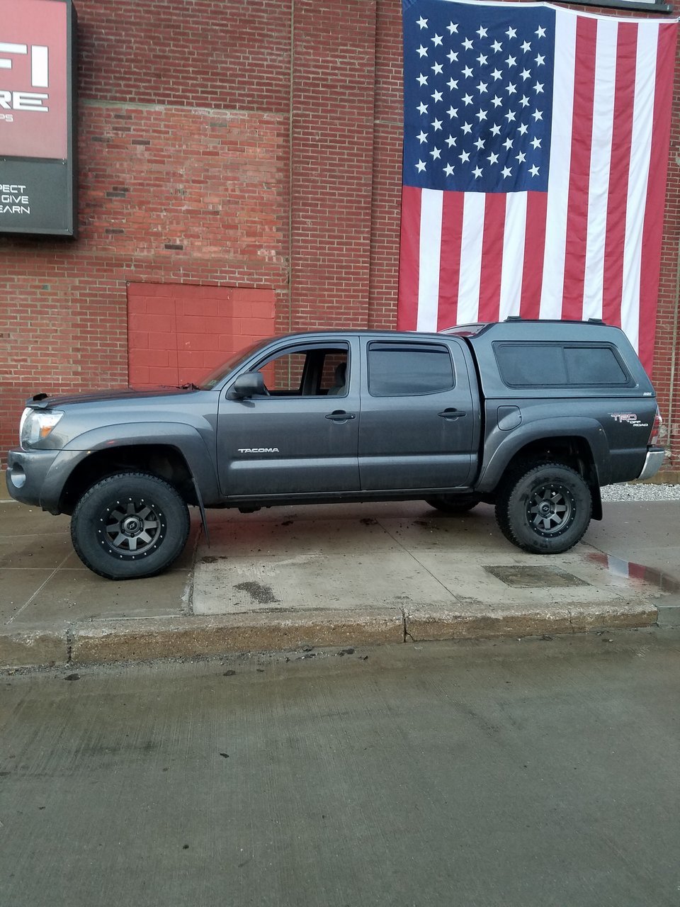

    Just installed 885,5100's and medium dakar full leaf pack got 2.5 front and 3 inch rear lift,20180220_175957.jpg ride is great and got good alignment with stock uca's running stock tires size for now

    Had your truck settled at all?

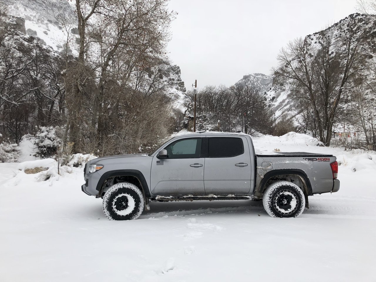

    Not much if any. Here's a few pics from this week, its current stance.

    Only vibes I've had so far are from a bad tire. I haven't done my ECGS mod yet but will be soon enough just to get it out of the way. No VSC issues.
