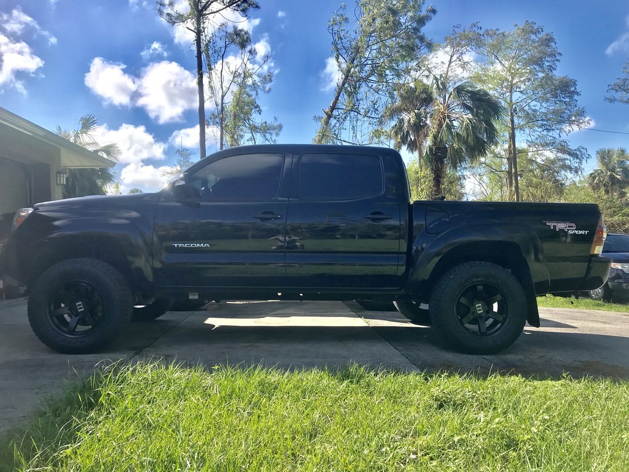

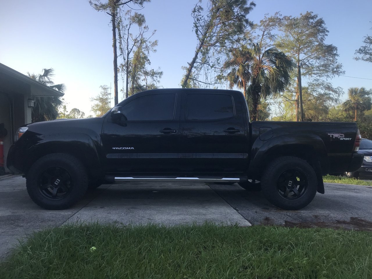

    Window tint count?
    Terrible lighting and photos for your viewing (dis)pleasure.

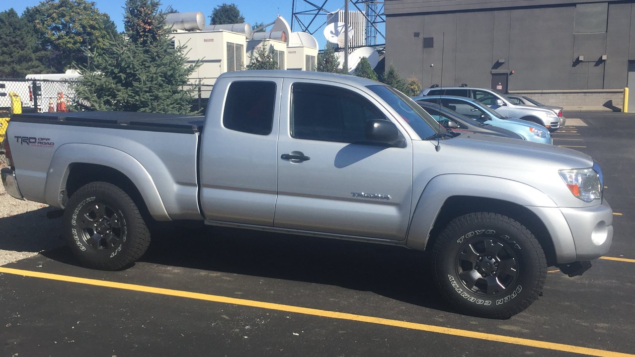

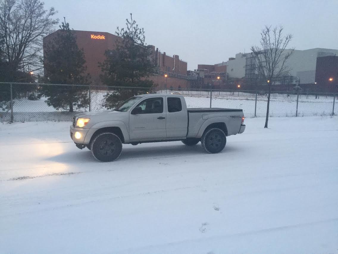

    I have the stock 4 leaf pack after the leaf spring recall or whatever. I do have ride rite airbags but i only air them up when Im hauling somthing.
  19. Feb 9, 2018 at 7:09 AM
    #259
    Czeleznick
    Czeleznick Well-Known Member
    Jan 27, 2018
    #242632
    328
    Philadelphia Area
    2022 White OR DCSB
    Eibach Pro Stage 1, Bronze SCS F5’s on Falken Wildpeaks
    looks good man and doesn't look nose high at all which is what i was hoping for. What size tires are they? 265/70?
