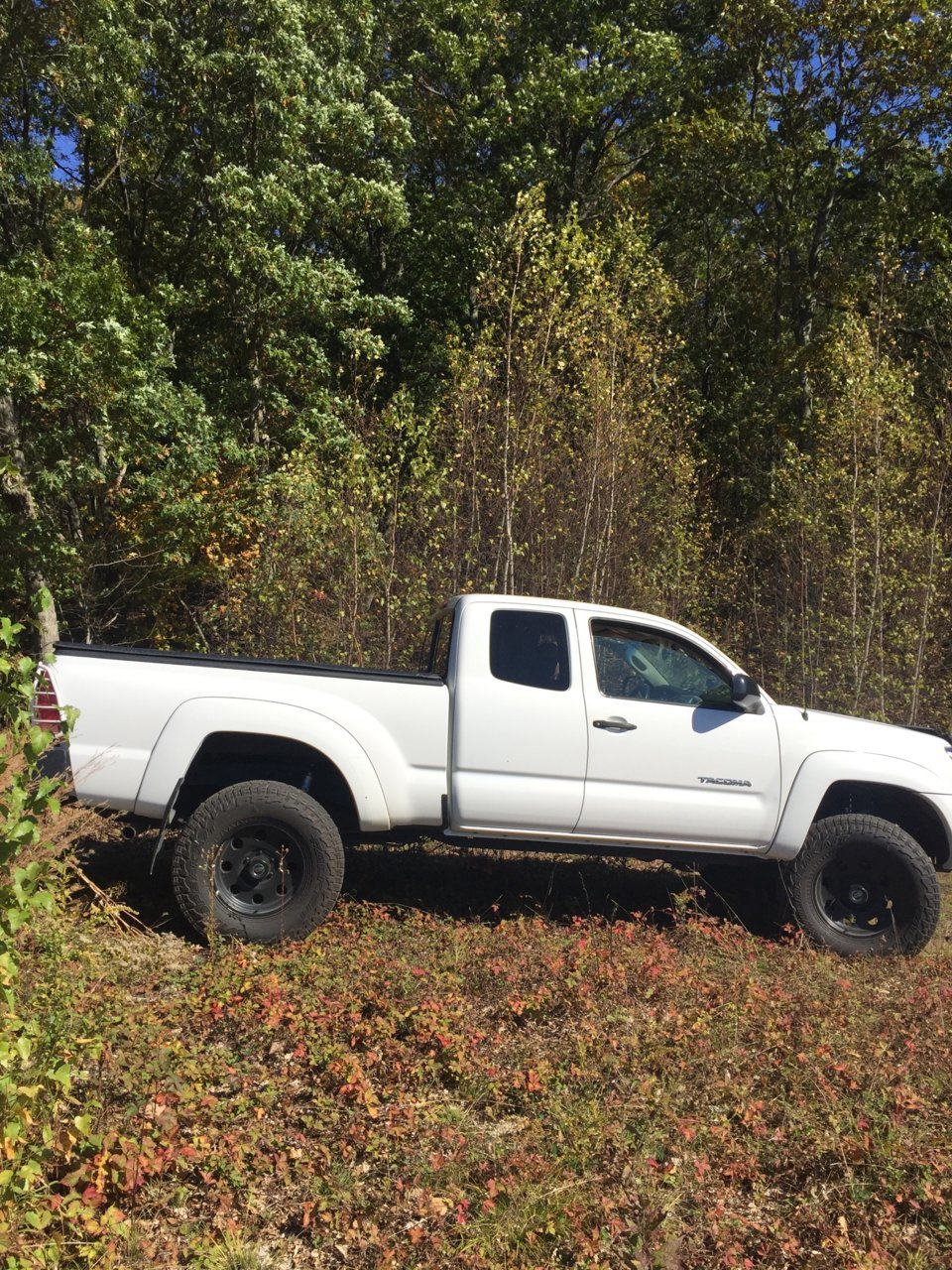

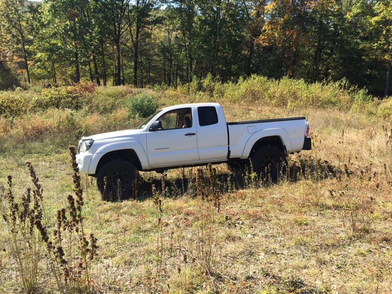

    I have since gone up to 6112s @2.5” ,Total Chaos UCAs with extended brake lines in front and Bilstein 5125s and 2” AAL in back ,extended brake lines also with 285/70 17s B5C3F0F4-127E-443A-B85E-96C907CA1C3E.jpgFFC8FC9B-E5B8-46E2-8EF0-87FC2792F39D.jpg

    That should ride pretty nice. Any issues with needle bearing or you already replace? Mine started at the lowly 1.75

    No problems yet ,but maybe I should have it done when they do my frame ?

    First lift was 1.75 in front. ,6-7 years . Lift now is 2.5 for over a year . Nothing

    you should be good then

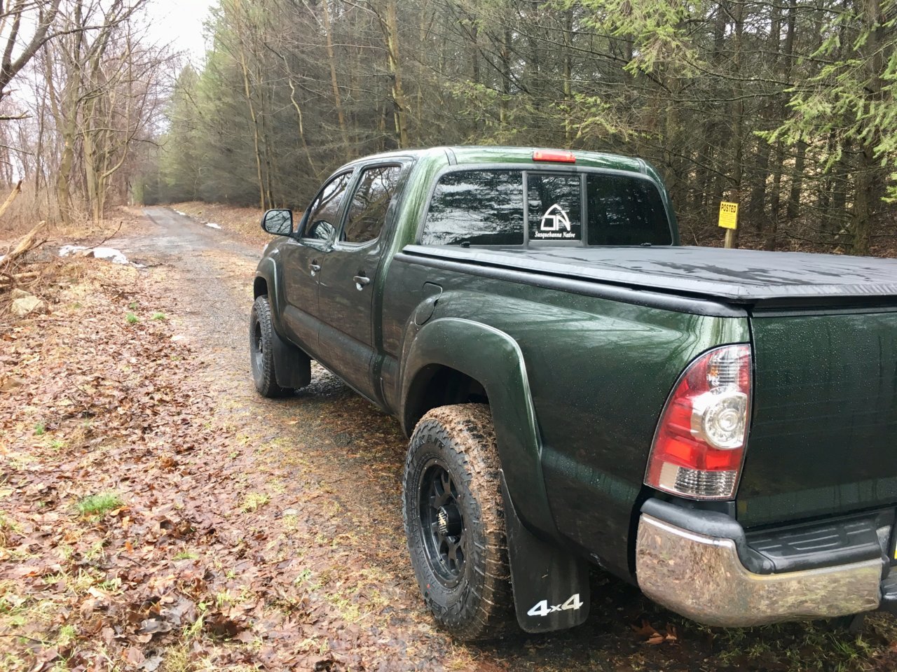

    You will be fine. I have the set up and don’t have any rubbing at all.D743A814-4050-42F1-9594-B2398228FF15.jpg
