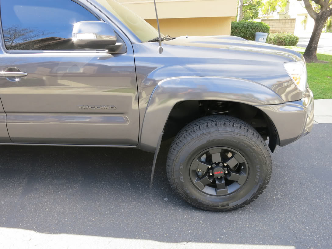

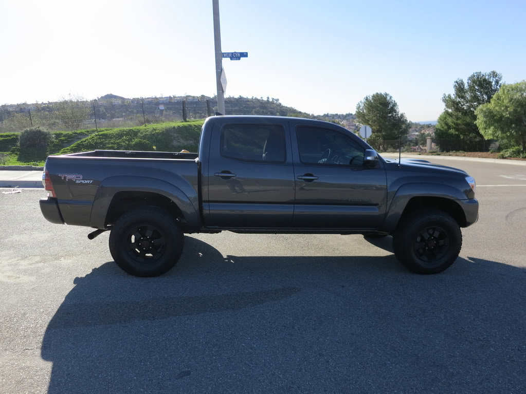

    I just finished the Bilstein 5100's all around (fronts set at 1.75") and added fj wheels with 265/75/16 Bridgestone Dueler Revo 2's
    Before
    After

    I just ordered 4 new 5100s and 1" lift shackles for the rear. When I get the install done next week what setting on front billys should i use to get a nice level ride.

    The rear is still higher what did you add to the rear. From what I have been reading front bil's set 1.75 would give you a leveled appearence. So you have had too add something.

    I had the same thoughts. Mine has the rear tsb and still looks a touch nose high, on the passenger side anyway, due to the lean.

    This... Nothing but 5100's done to the rear.

    Maybe its the slope of the street.

    After looking again, maybe it's the shadow underneath?

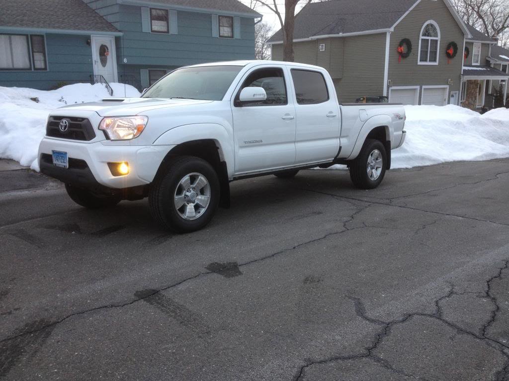

    loaded 2013 TRD sport
    Here's mine , 2013 4 leaf .
    1.75 front
    1" blocks rear .
