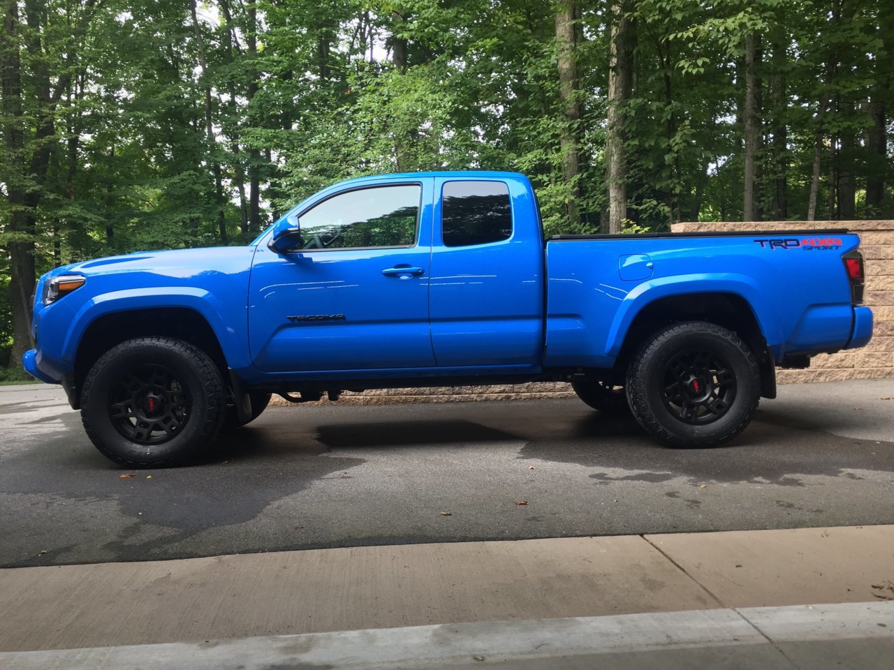

    BC2156A1-4755-4B74-8470-2CD885EC04AC.jpg 5100s on front only.
    Third notch (1.1”) with 265/70/17 (same overall height as 265/75/16).
    Rides great and TSS works as advertised.
