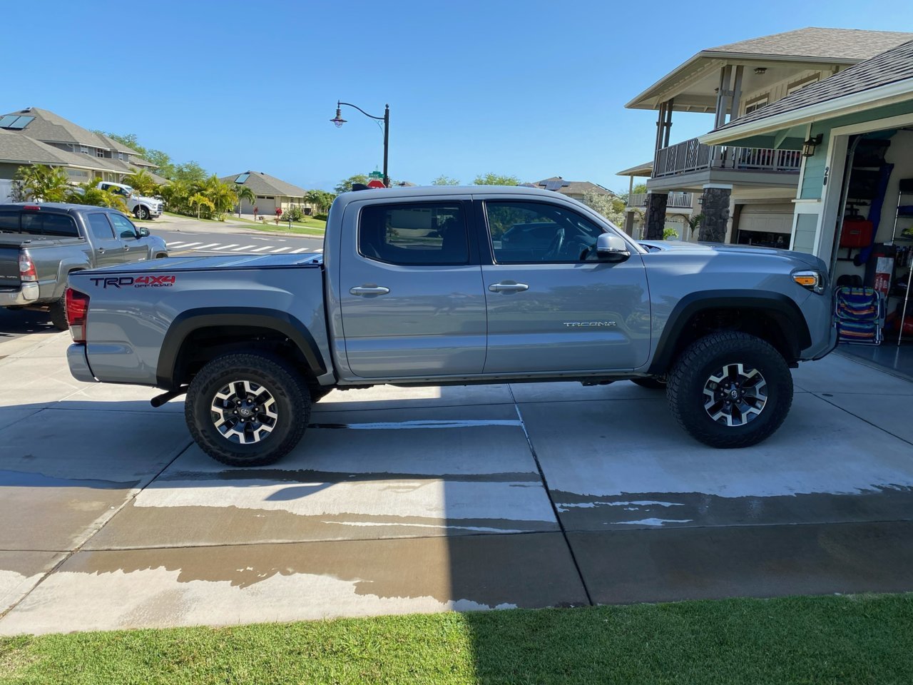

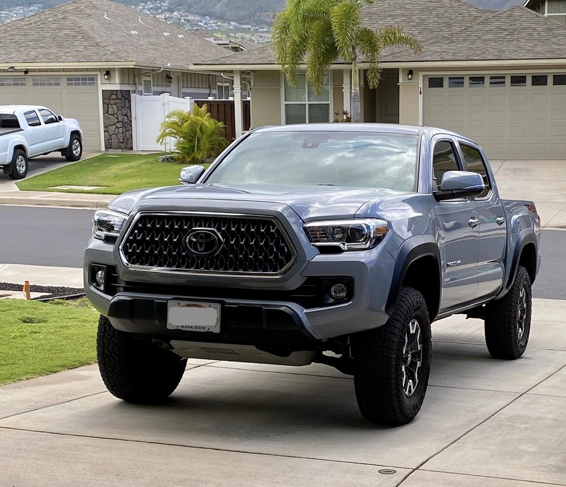

    848F5506-AB4F-4475-9AE6-E5D6AA5CC7D3.jpg 5100s, 4th ring up front and a 1.5 AAL in back.

    Looking good :thumbsup:

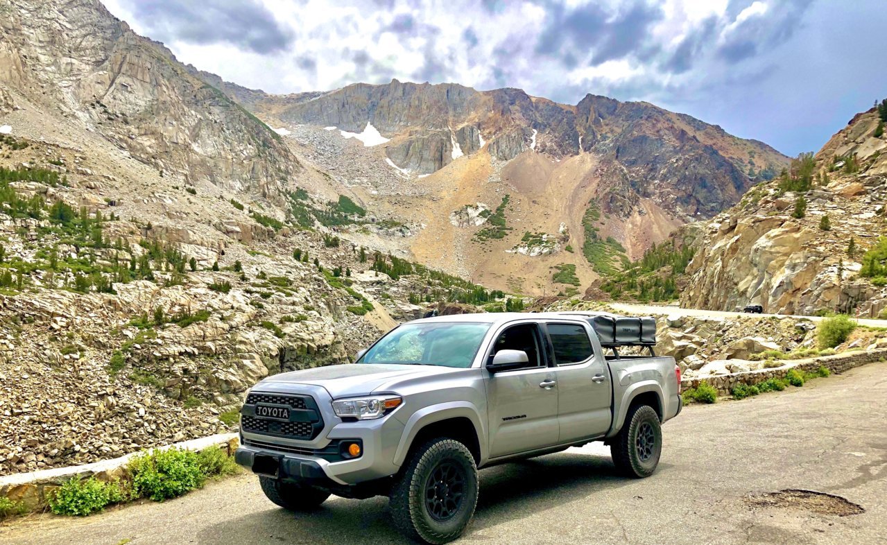

    I did 5100's with the 1.1" front lift #3 with 265/75/16 and Spydertrax wheel spacers on the stock wheel with no lift in the rear and it sat almost level... I have since added a Icon AAL 1.5 / 2" to the rear to help with sag while loaded with gear/tent. Sits almost level with AAL and full camping load. You should be fine with no rear lift unless you are going to load the bed with gear. 2020 215_LI.jpg

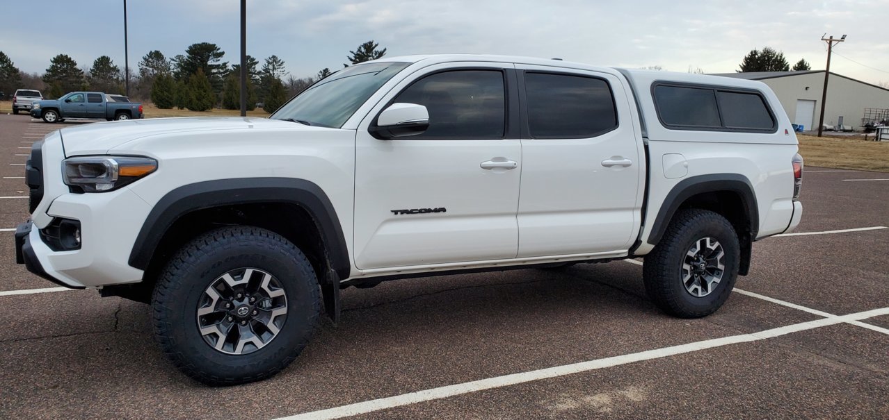

    Here she is w/ 265/75R16s and Bilstein 5100s front (set @ 2nd clip) and rear (no lift) me likey!

    Looks great OP :thumbsup:

    Noticable improvement in ride quality. Luv the stance and how the larger tires fill out the wheel wells.

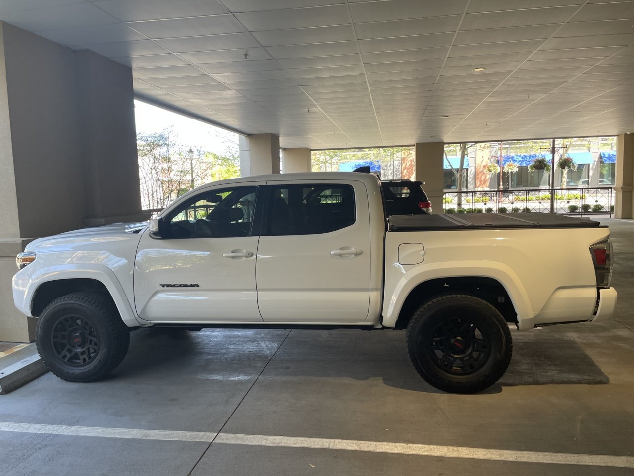

    Bilstein 5100, all 4 corners, stock coils set on 3rd perch(1.1).

    @jrshaw91450 - Damn nice truck. I'm over on Oahu and may have to copy your approach. The TRD Leveling lift has a "Stop Sale" and looking for a suitable leveling lift option (1-2 inches only).
    Stock tires? Did you install clamshell bushing? If not, have you noticed any vibrations? Last question, did you do install or local offload shop (Maui Offroad?). Love the way your truck sits.

    Thanks man! Tires are C rated wildpeaks and one size up at 265/75/16. I had a shop (IMM) install the lift and the bushing a week later. I had no vibration, but just did it for peace of mind. Drives better than stock in my opinion and the AAL was the way to go. I was nervous about the aal being harsh, but actually feels better than before.
    The tires and wheels look good to me and really didn’t loose any performance from stock, however, a set fo the 17” matted gunmetal pro rims with a 0 offset and same tire at 265/75/17 would be the $#it. When I ware these tires out that will be my next big splurge. Until then I am very happy with the look and no rubbing even when wheeling hard.
