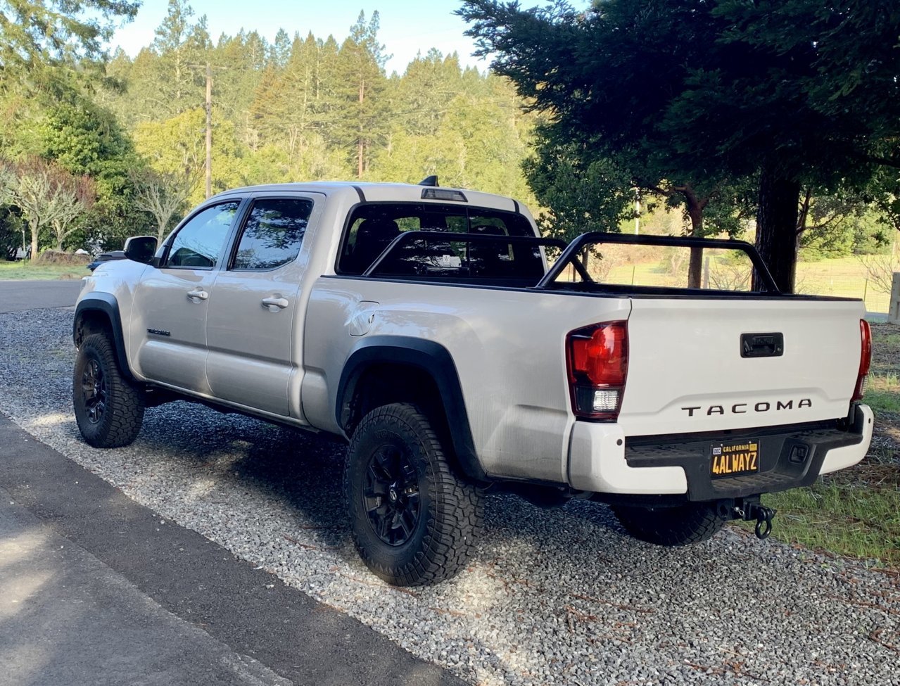

    Kings 2.5” front and rears from Accutune / ICON RXT LEAF PACK black badges doors and tailgate / method 315 / 255/85/16 Yokohama G003 / magnaflow exhaust , axle dump / meso int delete kit / meso led map lights / dome lights / wheelers front super bumps / accutune Flip kit with spacer and new bumps / Cali raised fog light pods / Cali raised ditch lights / RCI FULL SKIDS / SLIDERS / RCI rear bumper / rigid backup lights / tuned on 4.88’s
    Yup heard the same thing 2A3A5FCC-CF6B-49F9-B16E-47E937F19CE5.jpg 5100’s 1.5” front lift 4th setting. Ride is great. 1.5” rear lift to maintain rake. Hope this helps for looks. A member on here posted an email from Bilstein about pairing with aftermarket springs.
    My3rdTacoma, jsinnard and Tocamo like this.

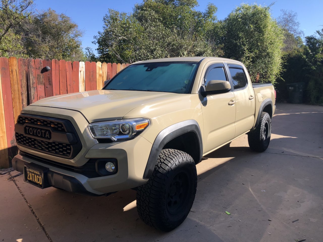

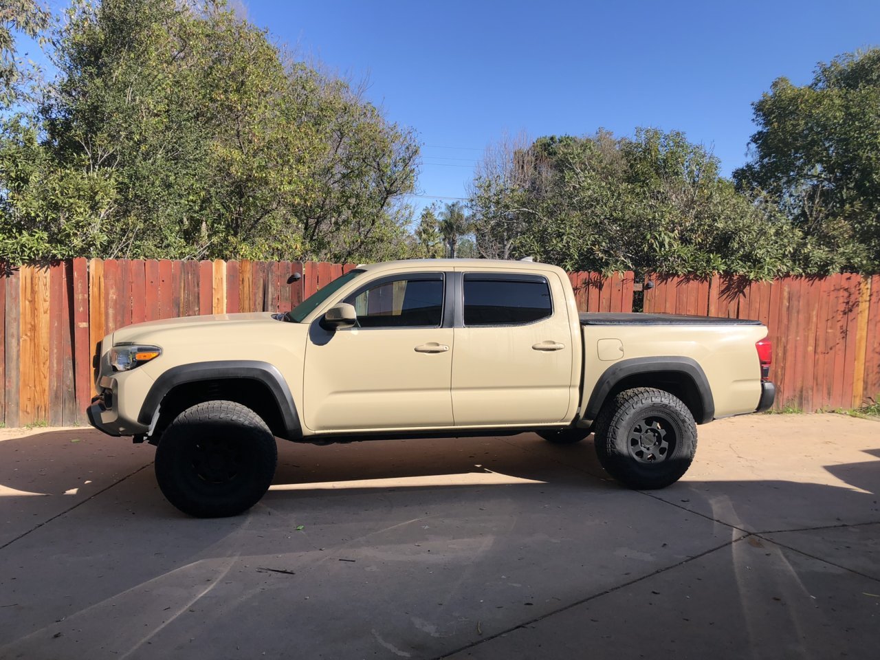

    5100s front and back - Eibach Pro springs up front - bottom setting:
    disel_V1, EvxnCrxss, Shaggs and 2 others like this.

    Looks good. You have any lift in the back?
    Also are those 285 or 265 tires?
    ajsandiego[QUOTED] likes this.
  12. Feb 20, 2020 at 9:29 AM
    ajsandiego
    ajsandiego Member
    Aug 5, 2018
    #261848
    23
    Aaron
    2018 Quicksand Tacoma SR5
    Thanks - really happy with it. Just the 5100s no added shims, leaf or anything in the rear.
