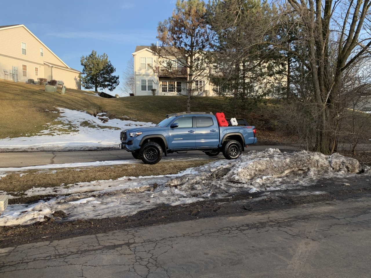

    19 Tacoma Trd O/R 4x4 S/B 6spd auto cav-blue
    Bilstein shocks & springs. Method 16in wheels Rigid led fogs 265/75 16 BFG KO2s
    5100s and eibach springs. Perfect lift for a daily/weekend warrior build.

    You have any lift in the back? What springs and how much height did you get in the front?
  6. Feb 24, 2020 at 12:37 PM
    #26
    Hal_XIII
    Hal_XIII Well-Known Member
    Apr 27, 2019
    #291495
    139
    Chicagoland
    i have 1.5 lift in the rear.
    2” in front.
    I have eibach springs.
    I think progressive coils, I have the shocks up front at the lowest setting since my springs provide the lift.

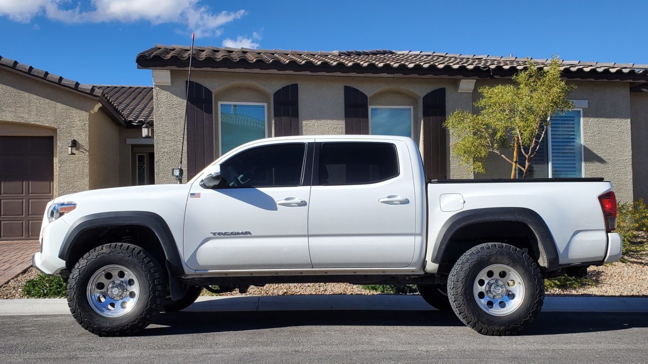

    1.5" Eibach springs, 1.5" Icon add a leaf, Bilstein 5100 shocks, 1" rear blocks.
    Eibach springs with 5100s. Icon add a leaf with 1" blocks. Hub to fender is 22" front and 23" rear.20200316_163820.jpg

    I assume lowest perch. What size tires?
  11. Mar 31, 2020 at 3:38 PM
    #31
    Konagrn
    Konagrn Well-Known Member
    Sep 25, 2019
    #306322
    132
    Jason
    Las Vegas, NV
    2019 Tacoma off road manual
    Yes lowest notch. 265/75 16. Bfg ko2s

    Don't know the spring rate. This is the part number. E30-82-069-02-20

    I would just get higher springs. Mine is on the bottom notch and after settling it's only 1.25" higher.
