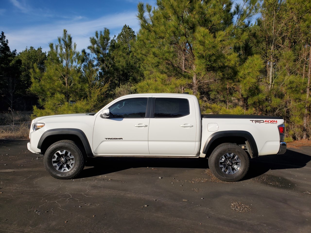

  2. May 23, 2020 at 5:19 PM
    #82
    jshields
    jshields [OP] Well-Known Member
    Feb 12, 2020
    #319051
    132
    2019 SR5 4x4 double cab

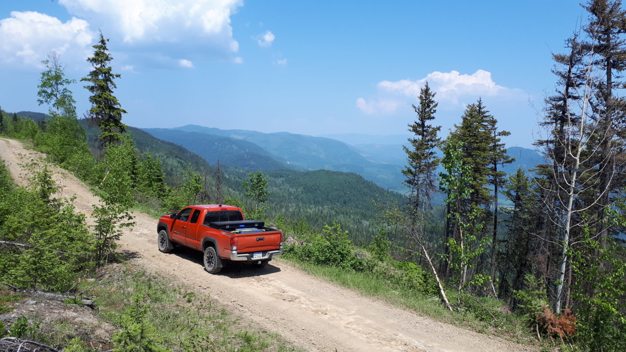

  7. May 31, 2020 at 12:36 PM
    #87
    ppat4
    ppat4 Well-Known Member
    Oct 7, 2019
    #307325
    1,004
    Paul
    Kelowna, BC
    2016 Tacoma TRD Off-Road Access Cab
    Just added toolbox and roof-rack to haul my fishing boat 100's of miles into the backwoods every week. Goodrich K02s, Bilstein 5100 front and back, no lift.
    Yeah it is pretty darn nice up here. Same with up at Field BC area, beautiful up there.
    Here we have tons of fishing lakes, hiking trails, and so much offroading spots you can go wherever you want and never see any other trucks. I have driven literally weeks through BC backroads, and never see even a single other truck. Love that.
    Plus all these nice small towns north and south of Kelowna. Summerland, Peachland, Osoyoos, Okanagan Falls, Penticton, Vernon, Armstrong, Sicamous, etc. All within 1.5 hour scenic drive of Kelowna. Still pretty quiet up here too, lived in Vancouver many years. No more big city for me, can't stand that stuff now. All I need is a few hundred miles of bush, truck, and boat. Nothing better. Kind of like this. :)

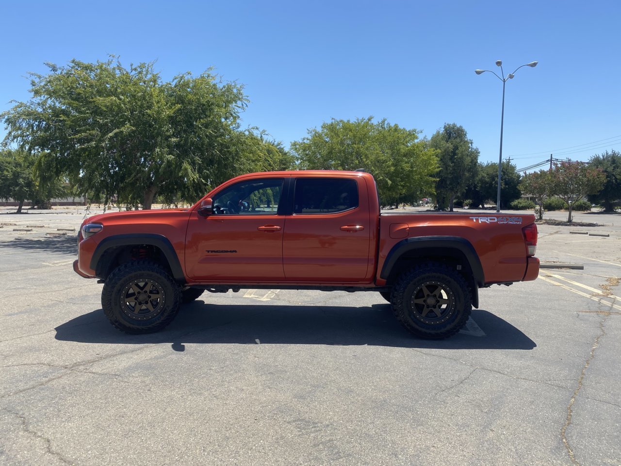

  11. Jul 14, 2020 at 6:35 PM
    #91
    Lunatic209
    Lunatic209 Well-Known Member
    Jun 12, 2017
    #221372
    246
    17 Inferno TRD
    Just sharing a quick pic I took after lift and alignment. Fronts are Bilstein 5100 with eibach pro coils and 1 inch top hat spacer
    Measurements
    Before Front driver 20 1/4 After 2nd notch 24
    Before Front Pass 20 1/2 After 1st notch 24
    Before both rear 22 After Headstrong 1.5 AAL 24
    as it sits currently 24 all around from Hub to fender

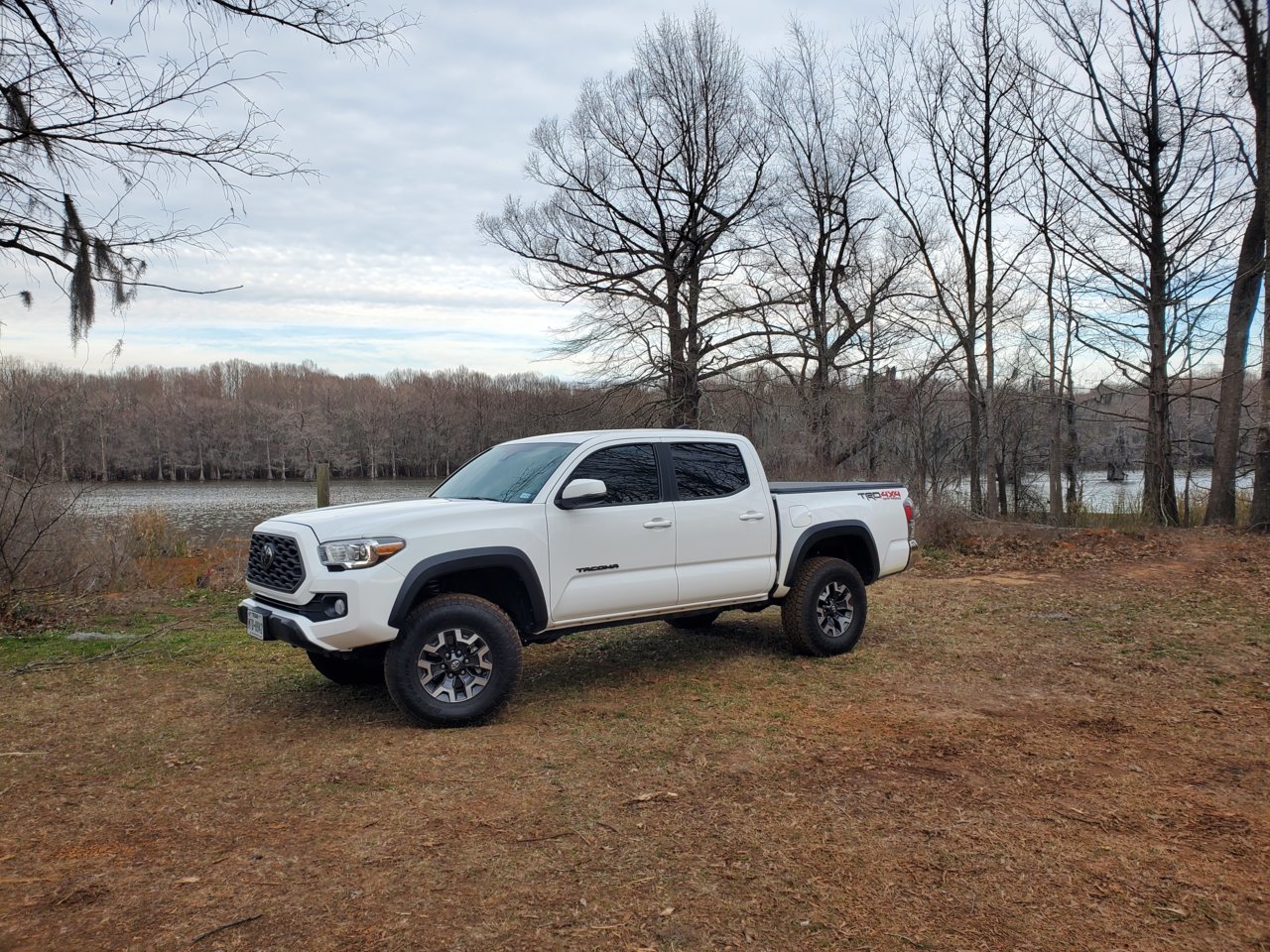

  14. Oct 15, 2020 at 5:34 PM
    #94
    jshields
    Feb 12, 2020
    #319051
    132
    Well I upgraded to 285/75R16. Had to do a little trimming on the front bumper and wheel well liner. So far no issues with cab mount but going to go ahead and chop it when I can find time.

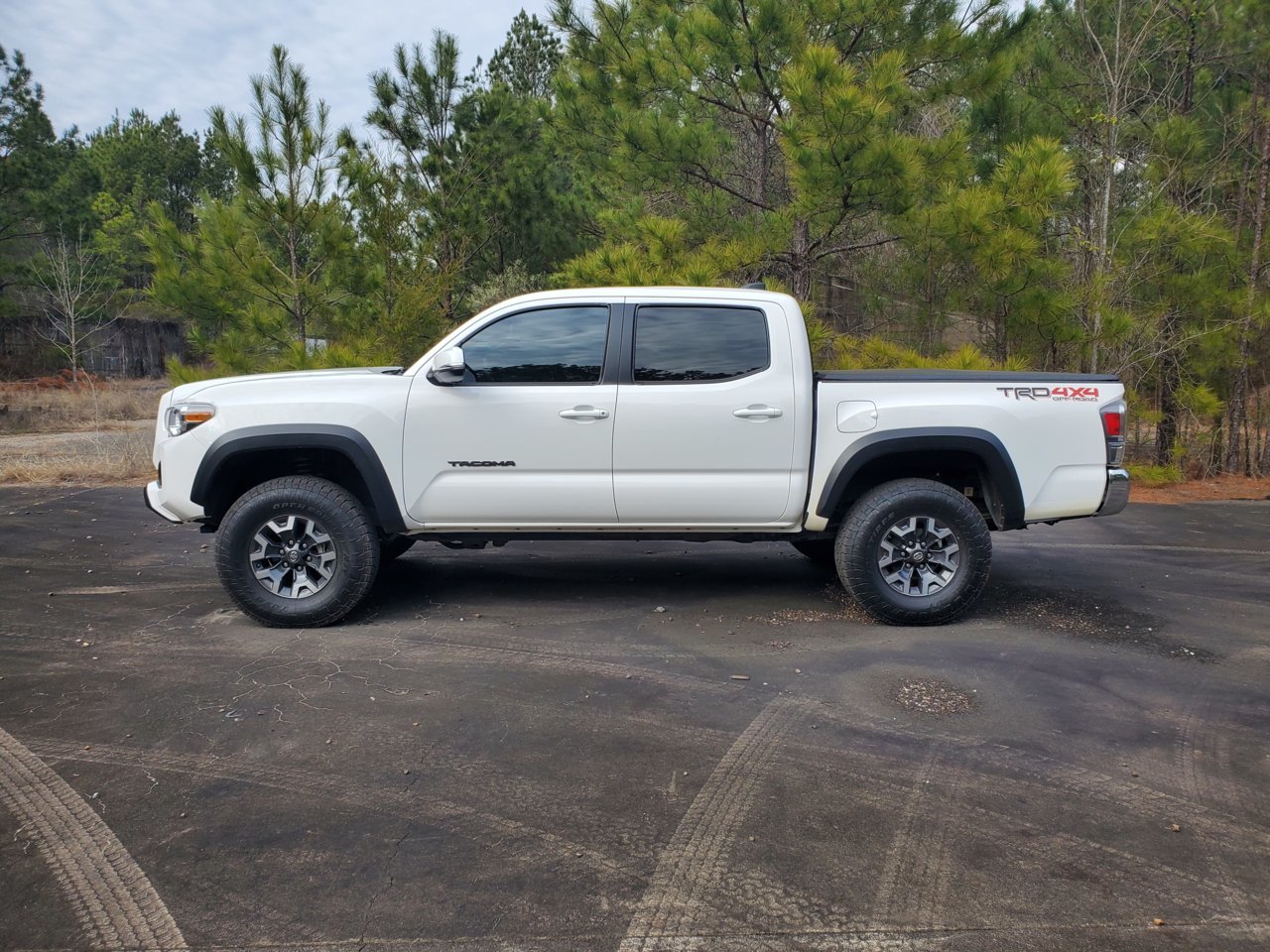

  15. Jan 31, 2021 at 6:48 AM
    #95
    Dave-73
    Dave-73 New Member
    Nov 20, 2019
    #311266
    4
    Dave
    2020 White TRD Off Road
    5100's front and back, Eibach Coils, and Icon 1.5" progressive AAL
    Toyo AT3s 265/75/16
    Before (stock) and after photos. Really happy with this lift and ride quality.
