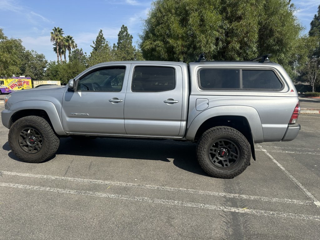

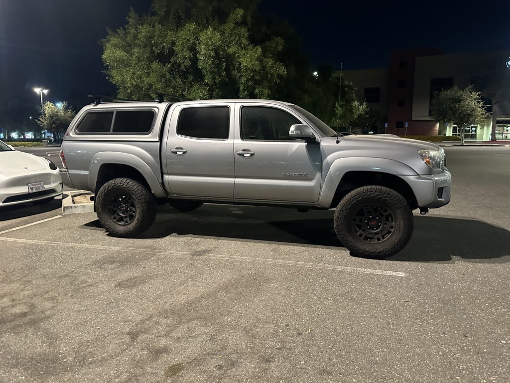

    I had bilstein 5100s with a spacer so I replaced it with the Eibach spring and it lowered my truck two inches on the bottom perch on the 5100s so maybe half and inch to an inch lift over stock. I’m going to jack it up to the third notch since it’s only temporary until I go with better suspension. Overall I would not recommend buying this setup brand new save your money and get 6112s. These were on my truck when I got it so I’m working with what I have

    I ended up going up just one notch and was surprised what a huge difference it made! I’m quite pleased with them now
