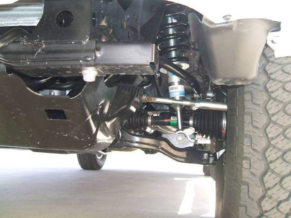

    I put them on my truck a 2006 double cab TRD 4x4 set at 1.75. My truck drives and rides a whole lot better than the stock setup. Which I would have never believed until I did it. So far about 2000 miles and I still love it wish I would have done it a year ago. Hope this helps

    fwiw,I also have the 5100's,set at 1.75".They ride much better then the stock trd Billys.Not stiff at all.:thumbsup:

    I set the 5100s on the front at .85" and actually got 1" of lift. The TSB on the rear springs left my truck 1.25" higher in the rear than the front while running light. This was measured through the center of the hubs from the ground to the lip of the wheel well. I don't think the drive shafts or steering linkage is affected enough to do any other mods. The ride with the 5100s is much better than with the stock fleet type HD bilsteins that came on the original TRD, OR package.
