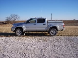

    http://truck12-08_39576661924e4e3a9481a5d91858893314795327.jpg
    Sorry The Pic isnt that good Billys set at 1.75. Rear TSB with ToyTec Add a leaf for the TSB.

    so if i get the TSB done for my truck what should I set my front bilsteins at? I want it levelish..... maybe barely if at all aimed downwards, but i DEFINENTLY DO NOT WANT my truck to have any upwards slant... so what setting?

    Every truck is different. I set mine in the front at .85" and got an inch of lift. The TSB gave me right at an inch of lift in the rear when it was done. Now that it has settled in and had a few heavy loads it rides 1" higher in the rear running light. When I pull my trailer or have a load on it the stance is level or barely lower in the rear. Set at 1.75" you would be close to level but nose high with any load at all. Most I've seen anyway. I don't think you would like the highest setting if your not going to AAL in the rear.

    I have mine set on 1.75. When I first got them I just had the rear TSB. With a little weight in the back 200# my truck raked backwards (bad) with no weight it was perfect. That's why I went ahead and bought the ToyTec ad leaf. I like it real will know. The ride is good. The pic doesn't do it much justice.
