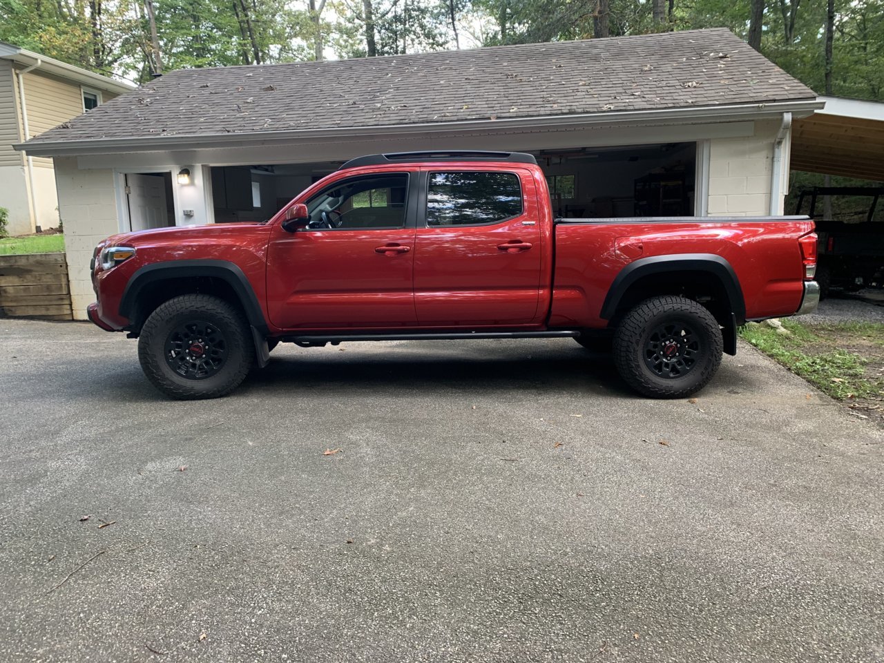

    sortof stock. 6112/5160, pro wheels and a tune.
    3BBE7202-FA6B-49E0-9AAD-25F083B40D63.jpg mine are set at 5/4 aswell. i felt like 1.5 was a good compromise to still get a decent alignment without having to get ucas. i also have a 3 leaf mini pack out back. the ride is great. way better than my 5100s, and feels about the same as my fox pro shocks i had. (those were smoother on low speed bumps)

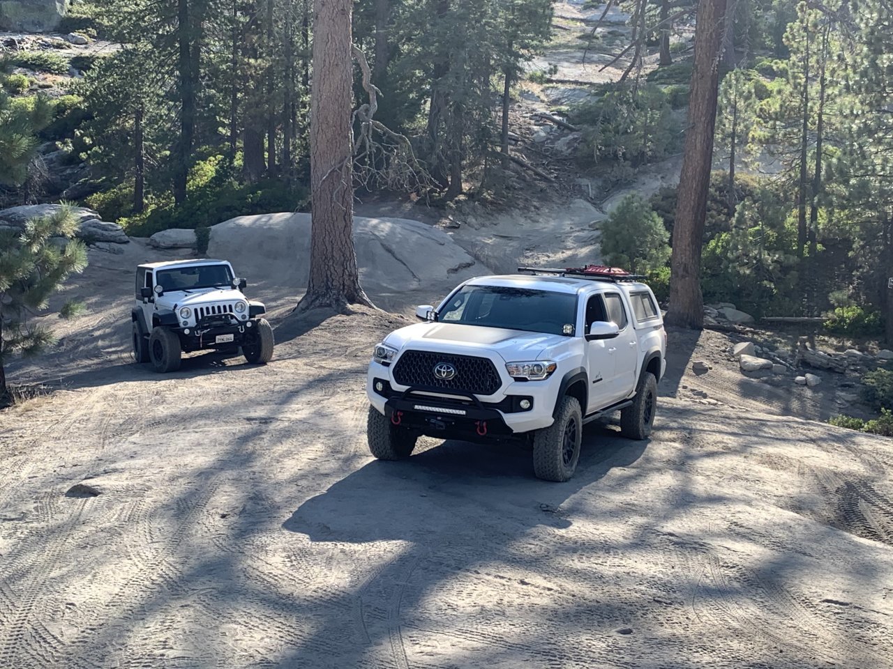

    Bilstein 6112 / 5160, 275/70/17 BFG KO2, Caliraised Sliders, SSO bumper, Warn winch
    I run 6112s at their highest settings (5/6) and have 275/70/17. Add-a-leaf in the rear. Truck was fairly heavy in this pic.
    No rubbing in normal driving, only during significant flex.

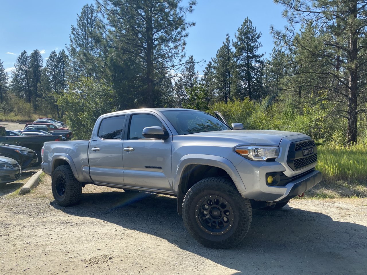

    6112/5160
    CMC
    285 Falkens
