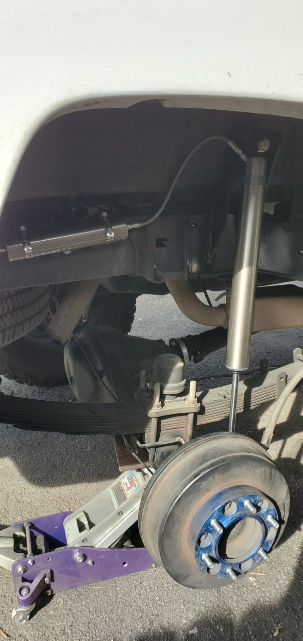

    2007 White DCSB Sport
    14" 7100 short bodies with BAMF shock mount relocate
