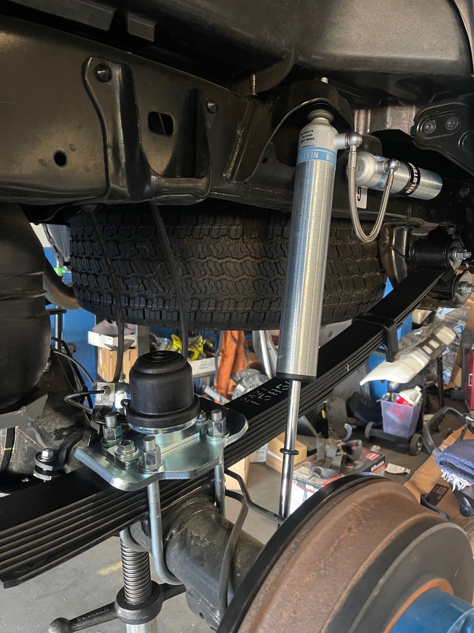

    Here is my current set up:
    6112/5160 5-6 notch as recommended by shock surplus, Bilstein Upper Control Arms, Icon RXT Leaf Pack on setting 2 & decided to change out the u-bolts with Wheelers u-bolt flip kit. Loving the ride, so much better than the factory set up.

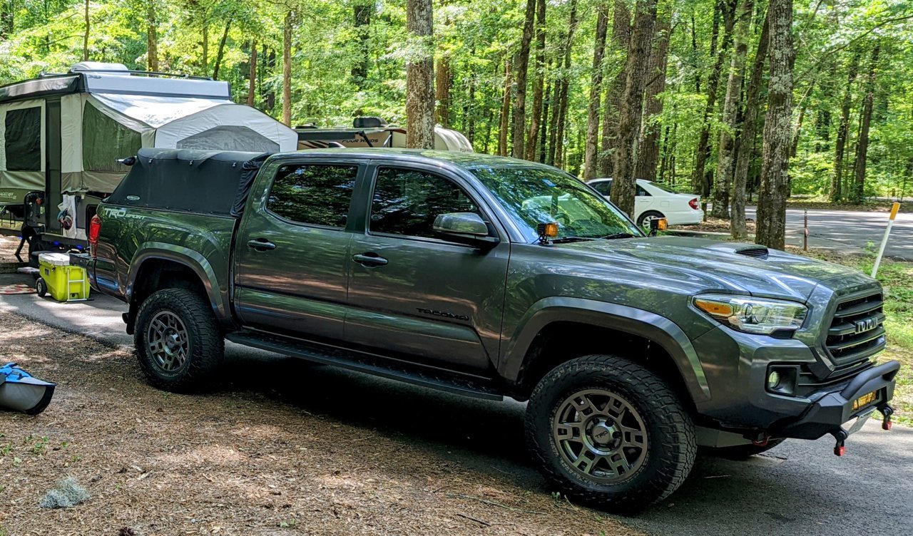

    Just had mine done over the weekend. 6112 set at 5/4 (6-notch version), 5160, Icon AAL, SPC UCA. A little under 2" lift in front and a little over 1.5" in back. We'll see how it settles.
    Before:
    After:
    With the new sliders:

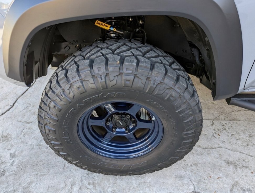

    Here's mine set at max height, ICON RXT leafs set on option #1. About to go up to option #3 (add extra leaf) for max height and 305/70R17 tires, debating whether or not to add a thin spacer up front to gain 1" or not.

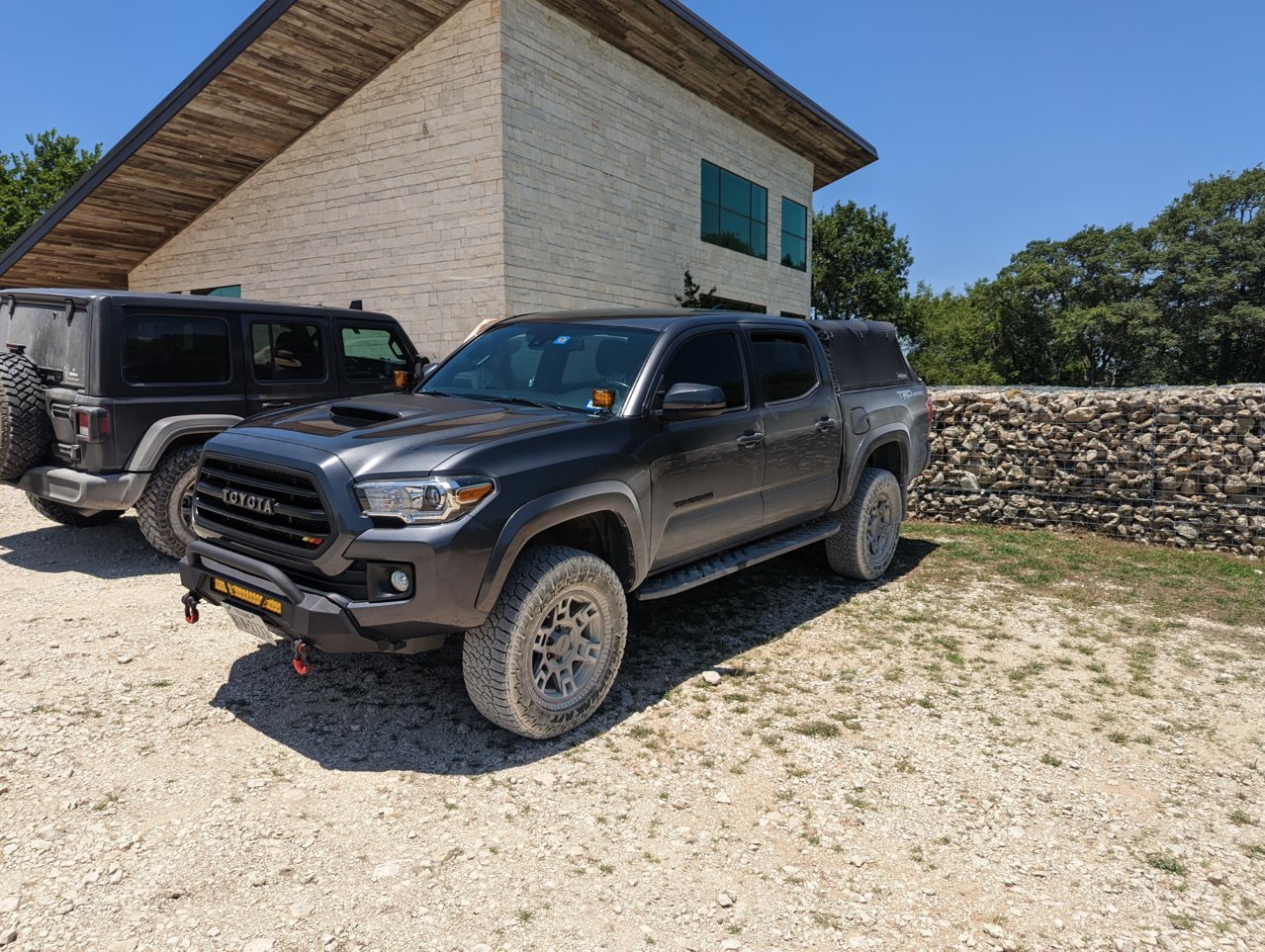

    My 6112s are set at 3/2 (I just wanted to level the front a bit) with 265/75R16 tires;

    Is that just the stock leafs in the rear? I'm looking to do the same, I don't have a need to lift the rear.
    Looks good!

    Yes, this is with stock leaf springs in the rear (and 5160 shocks).

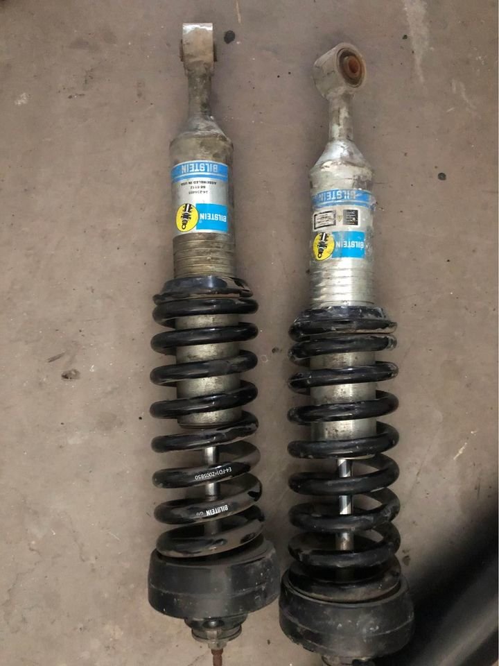

    found these 6112 from facebook marketplace local to me with 20k miles. came off second gen. seller has listed for 500 which is a little high for my liking, but will watch for price drops. can anyone help me out and figure out whats with those top hats? are those the stock second gen tophats or some spacer he put on? also can someone link me to the other 6112/5160 thread? ive been lurking but not posting.
    also looking for low mile TRD pro bilstein takeoffs. thinking slightly used 6112/5160 would be better off than new 5100's. also bilstein in general what do yall think about performance change over miles? have a chance to get 40k mile front 5100, 80k rear 5100, and generic AAL in rear for 200 bucks. tempted but know buy once cry once
