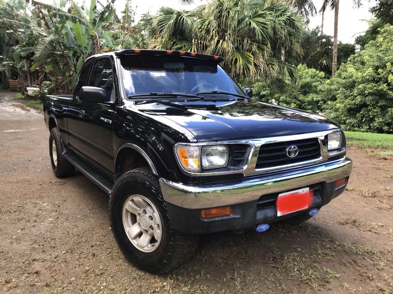

    Switched over my 32’s from my old truck today and can barely turn haha.. looks great but time to order lift set up next week. Anyone? It’s between 6112/5100’s w Dakars and a full OME set up. 9706AA5D-70B3-4651-B5CE-B7224E364B22.jpg
