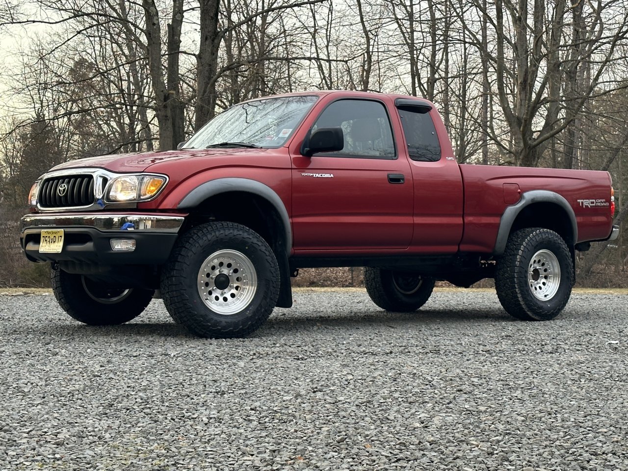

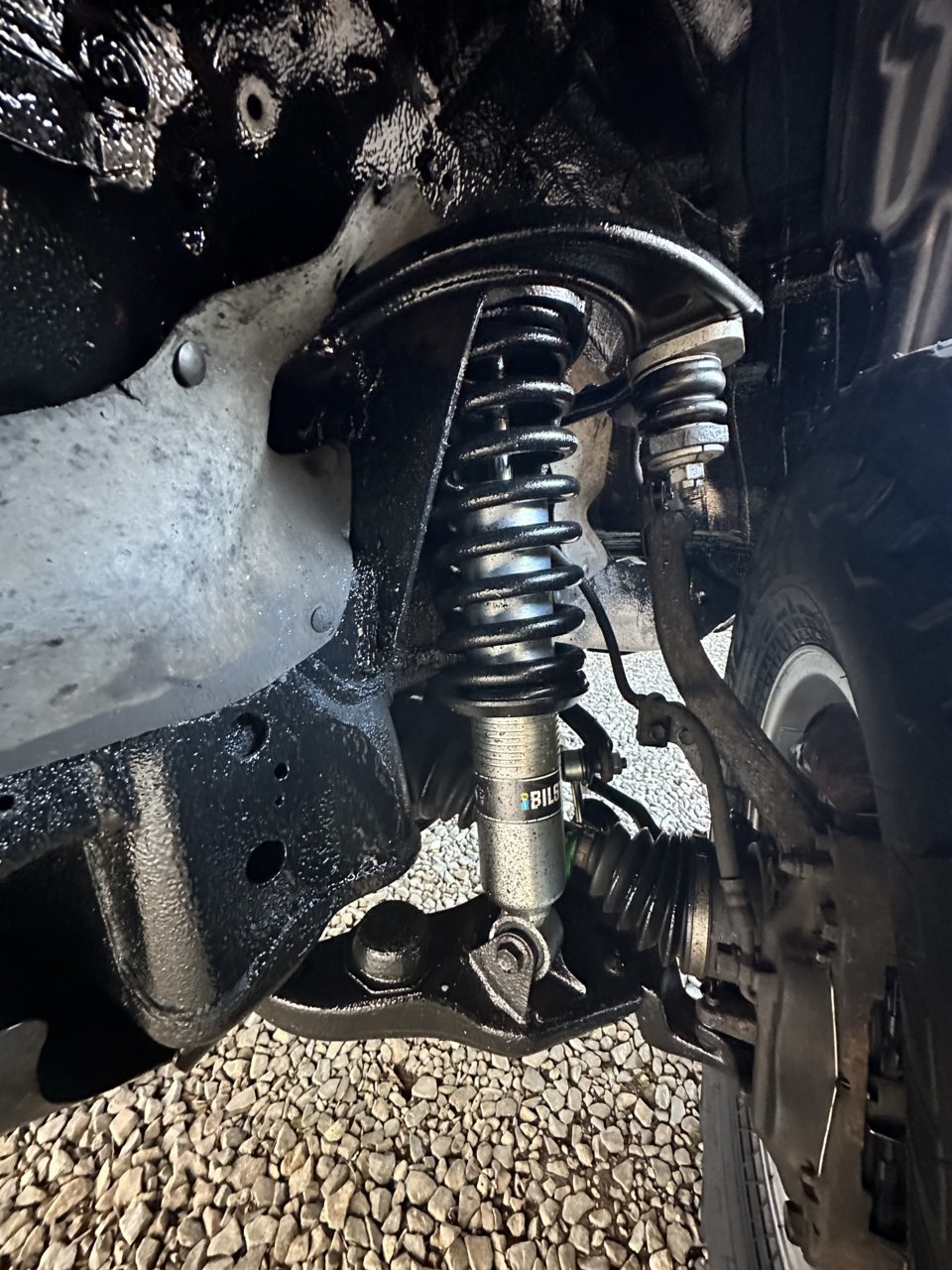

    For as beefy as they are, I would rate them a step above your traditional 5100s in the stiffness department. I was a little concerned there would be very little dampening at all but that certainly wasn’t the case. I had them set up by hotshot off road for about 2 inches of lift. It’s a nice stiff ride but I’m not avoiding potholes.

    Nice !
    I got the set from wheelers now (6112 front assembled and 5100 rear
    I got the new leaft pack from Alcans and Ubolts
    Did you change anything else doing this swap / upgrade .?
    tks for the pics , seem not many choose this route with Bilstein
