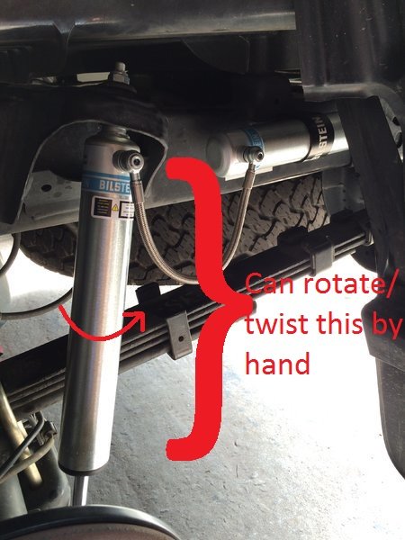

    Warning: Potentially stupid question inbound.
    I noticed yesterday that one of my 5160's had twisted ever so slightly so that the angle of the reservoir line wasn't quite what it was when I installed them. To my surprise, I could actually twist the body of the shock by hand even though the bolts are still on and snug.
    Is that normal, or do I need to re-tighten the upper shock mount bolt?
    Example of what I'm talking about:

    Just went in my garage and checked... If I grab the shock body, I can twist/torque it about 1/16" - 1/8", but it twist back into place... looks like you may need to tighten up your top bolt/nut a bit. Be careful not to tighten to much though... don't want to break it off.

    Normal. Mine is the same way, the hose resistance will keep it in the position that's most comfortable to keep it from binding or loosening up the bungs. Tightening won't do anything to it except max out compression on the bushings.

    Mine are the same. Because the housing is not bolted to the frame, its just snugged between the bushings. It shouldn't move much, and if it does, I wouldn't worry about it.
