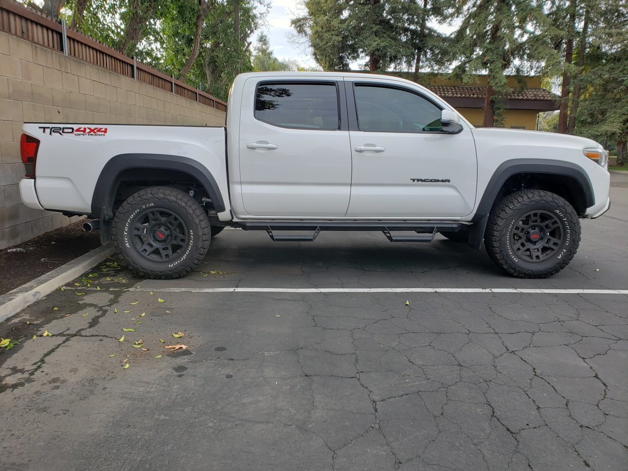

    3rd gen 6112 and 5160. Goal was to level out the front to the rear stock height. 6112s are set at 4 and 3 perches. 1st day the fronts were about 3/4 inch higher. 3 days later and about 100 miles of driving, they've settled to less than a 1/4 inch higher. Hoping for it to settle a little bit more with some miles.

    1,113
    MA
    2017 TRD OR 4x4 DCSB
    Nice setup! What size tires are you running?

    2018 Tacoma TRD Off-Road
    Thank you. I am running the basic 265/70/17 KO2's.
