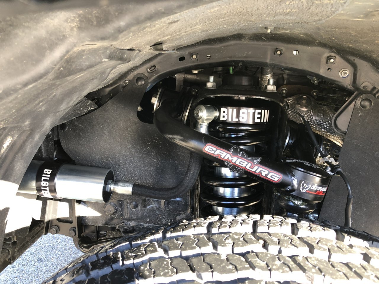

    You honestly wouldn't need to cut at all. I personally wouldn't think 3rd gen installs are any more technical than 2nd gens, other than extra intake-related equipment shrouding up the P-side. Tackle that UCA. A lot of us will definitely chime in.
    As for the 6112s, they ride so much smoother than stock OR. Not sure if the coils are progressive or linear. 2nd gen on the 4th notch, 1/4" spacer on D/S, Camburg UCA with MOOG B/Js, 5160 rear shocks, and EL096R Dakars. Light trail riding here in CO paired with the 6112/5160 is definitely the secret sauce. I got so excited to wheel that I forgot to air down. They still rode quite well!

    It definitely helps to enlist someone to wedge a pry bar between the through bolt and metal lining as it doesn't require the through bolt top to scrap the metal lining. I used the lower C/O bolt to punch the through bolt out. The length was sufficient and did not require much punch force. The initial pry bar-wedge method is only necessary for the flanged top nut of the through bolt so that it clears the metal lining. The rest will just pop out. Enjoy a beer immediately after you get that bolt out.
