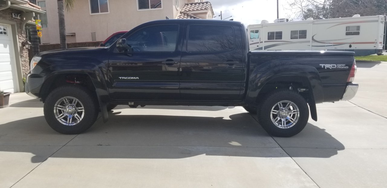

    Finally installed. Went 4th notch and I am sitting at 23.5" front driver and passenger and 24" in the rear with 5160 and an add-a-leaf.

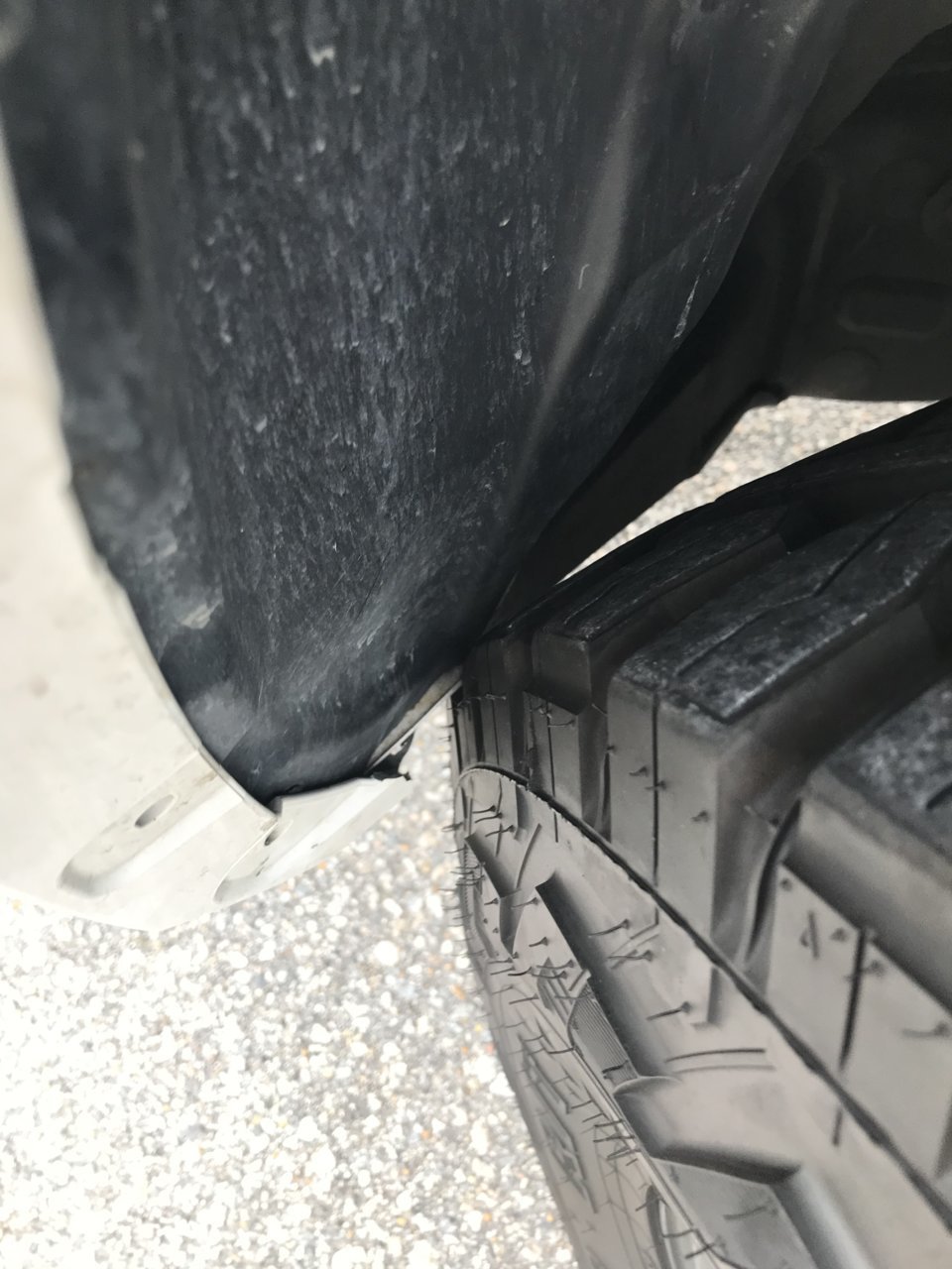

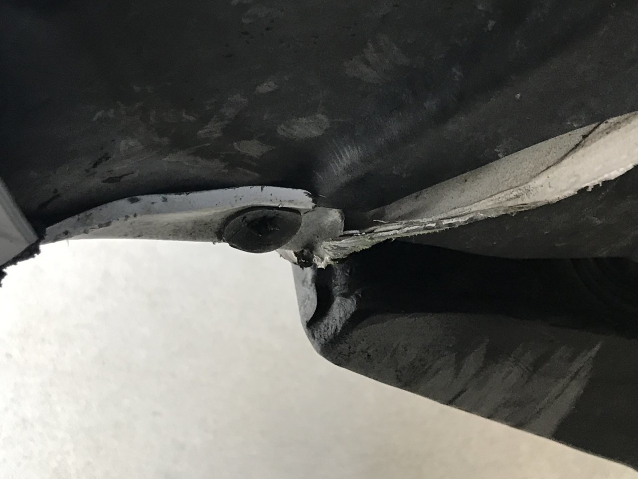

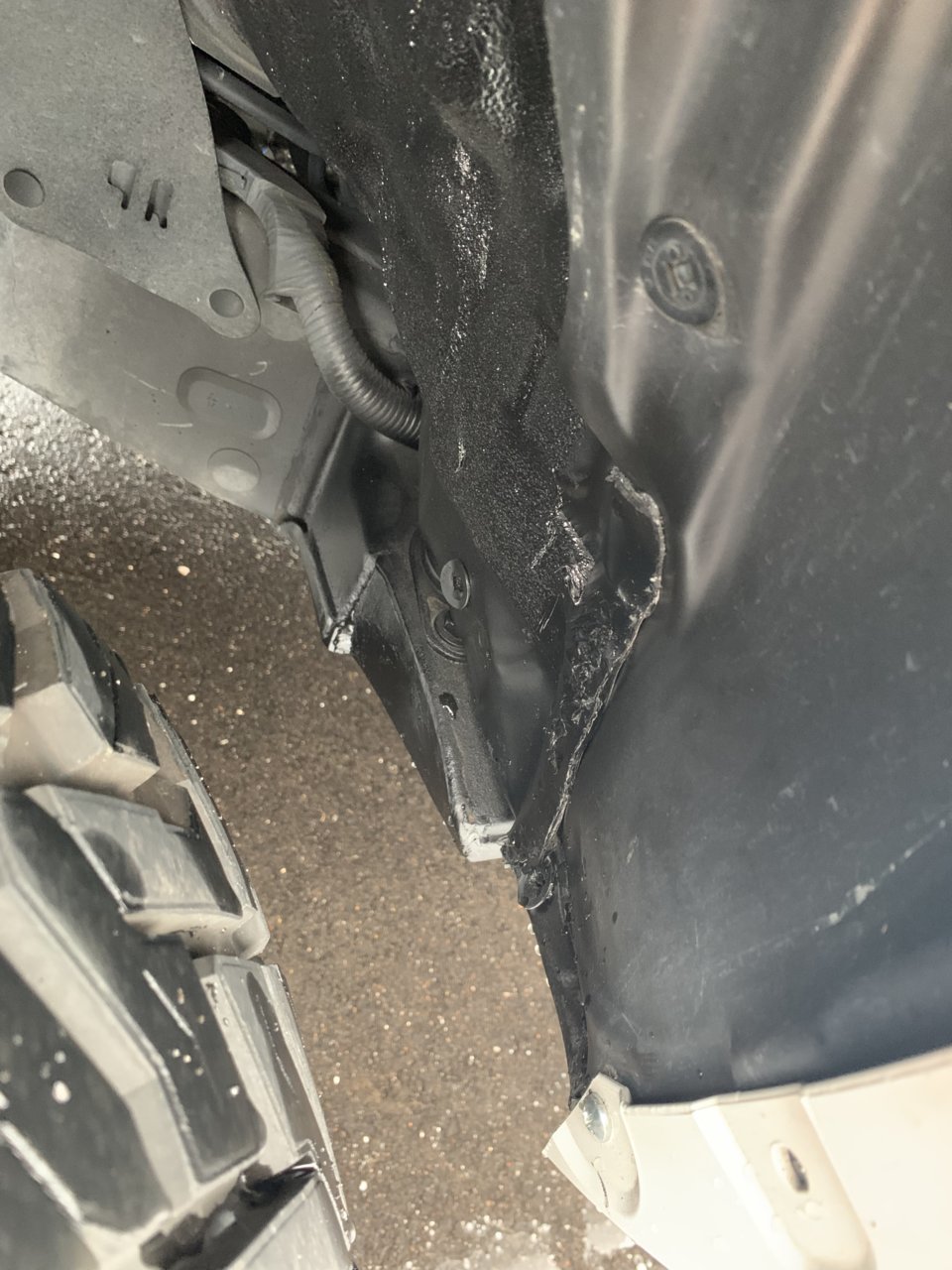

    If you don’t wanna cut metal or let alone trim plastic then get 265s.
    I have 2” lift with 6112s and didn’t rub with 255s skinnies but with a cmc with slight trimming on plastic and a bit of fender, 285 now with a cmc and more plastic trimming. I added a 1.25mm spacer and had to redo my cmc and do my pinch welds. You gotta pay to play if you don’t want to stick with 265s.
    Seen down below for pics of the process and headache lolE1208813-7DFD-4EE4-81B8-BAAEEF571FAB.jpg

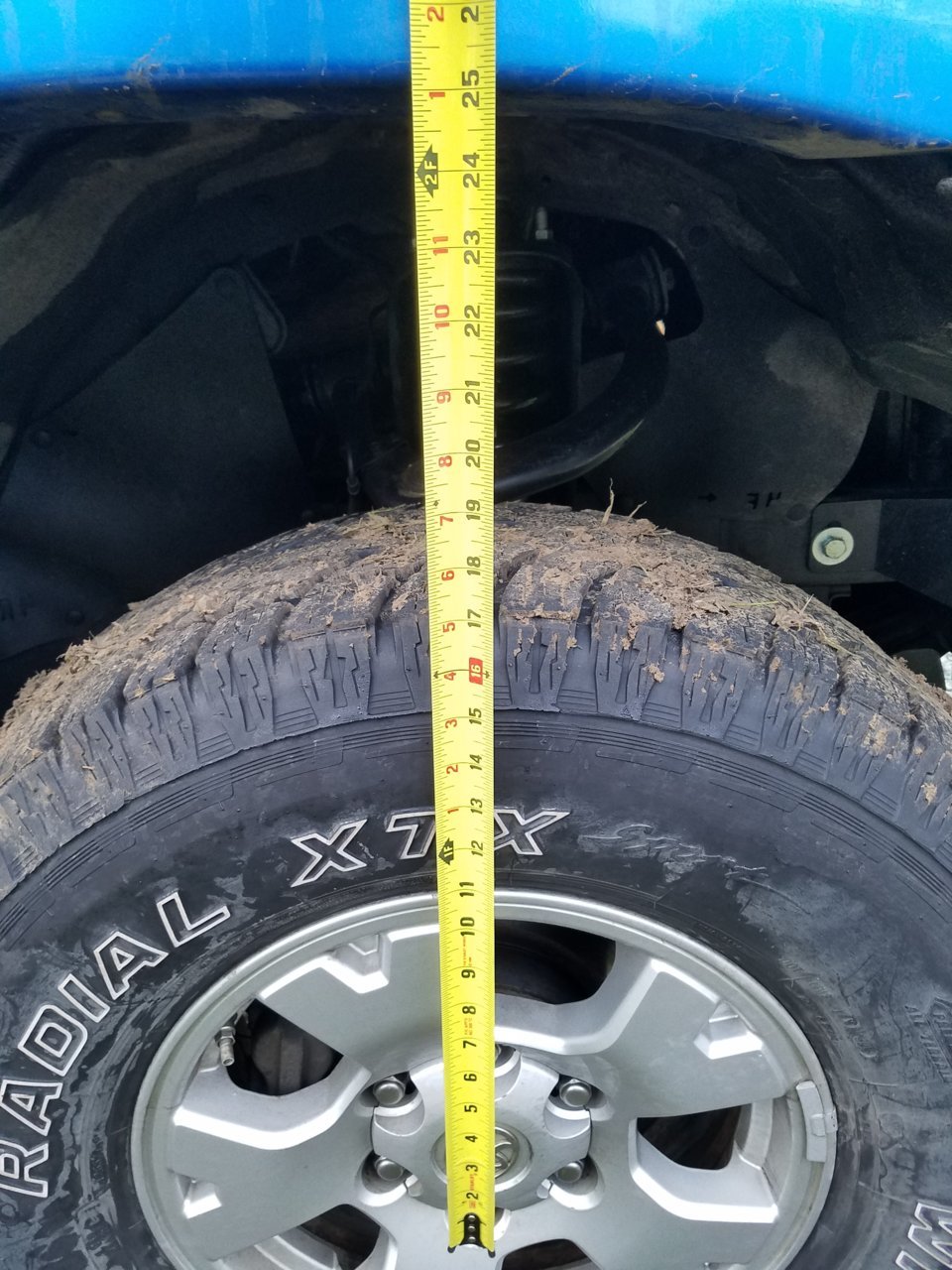

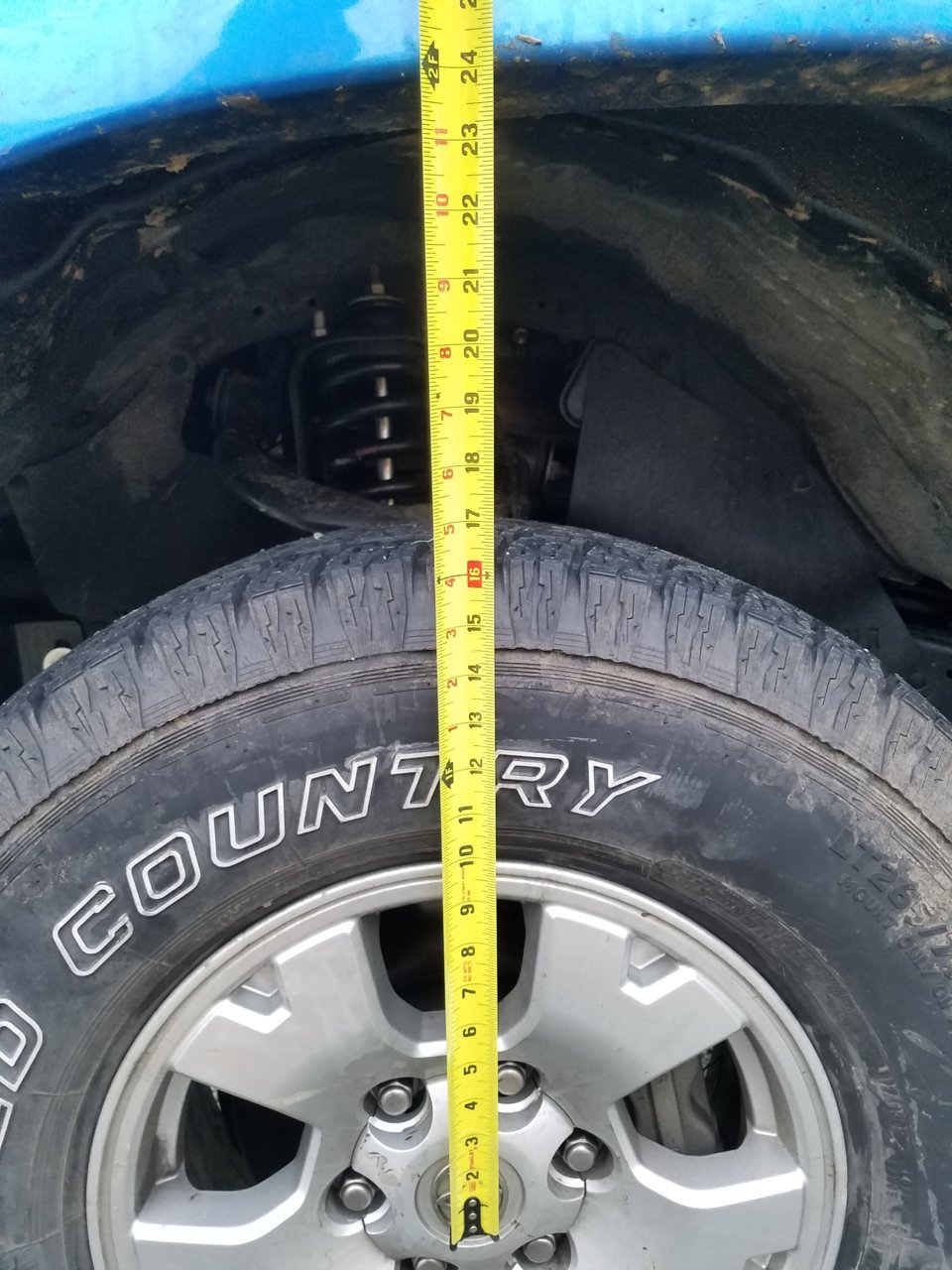

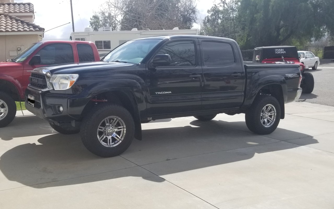

    Anybody running the 700# 14" springs with 6112s? I have mine set at 5/5 and it's way over lifted, so I'm going to have them lowered down. Just trying to get some good estimates as to which clip setting I should go to. For wieght up front I've got an ARB and a 9k winch and it doesn't even faze the 700# springs! No sag at all after running them for a solid 10k miles. Thanks for any input guys!
  19. Mar 6, 2019 at 5:47 PM
    #2059
    oscolivar1
    oscolivar1 Well-Known Member
    Oct 30, 2013
    #115568
    2,267
    Oliver
    VA
    2017 Tacoma Limited
    Bilstein 8112/8100, JBA UCAs, Icon RXT leaf pack, work wheels 17x8.5;-10os, 285/75/17 cooper LTX AT3, Mobtown HC rear bumper and Sliders, SSO front bumper, BAMF greceased grill.
    Pics? Just curious how much lift you got. Most people went 4 setting.
  20. Mar 6, 2019 at 5:56 PM
    #2060
    yotatotaco77
    yotatotaco77 Well-Known Member
    Jun 14, 2018
    #256398
    120
    Southern Oregon Coast
    2011 Tacoma TRD off-road extended cab
    Bilstien 6112s with 700# springs ARB Deluxe Bull Bar 9k winch Bilstien 5160s Icon progressive 3 leaf AAL
    About 4.5" DS and 5.5" PS, just for reference, stock height was 20 1/4"
