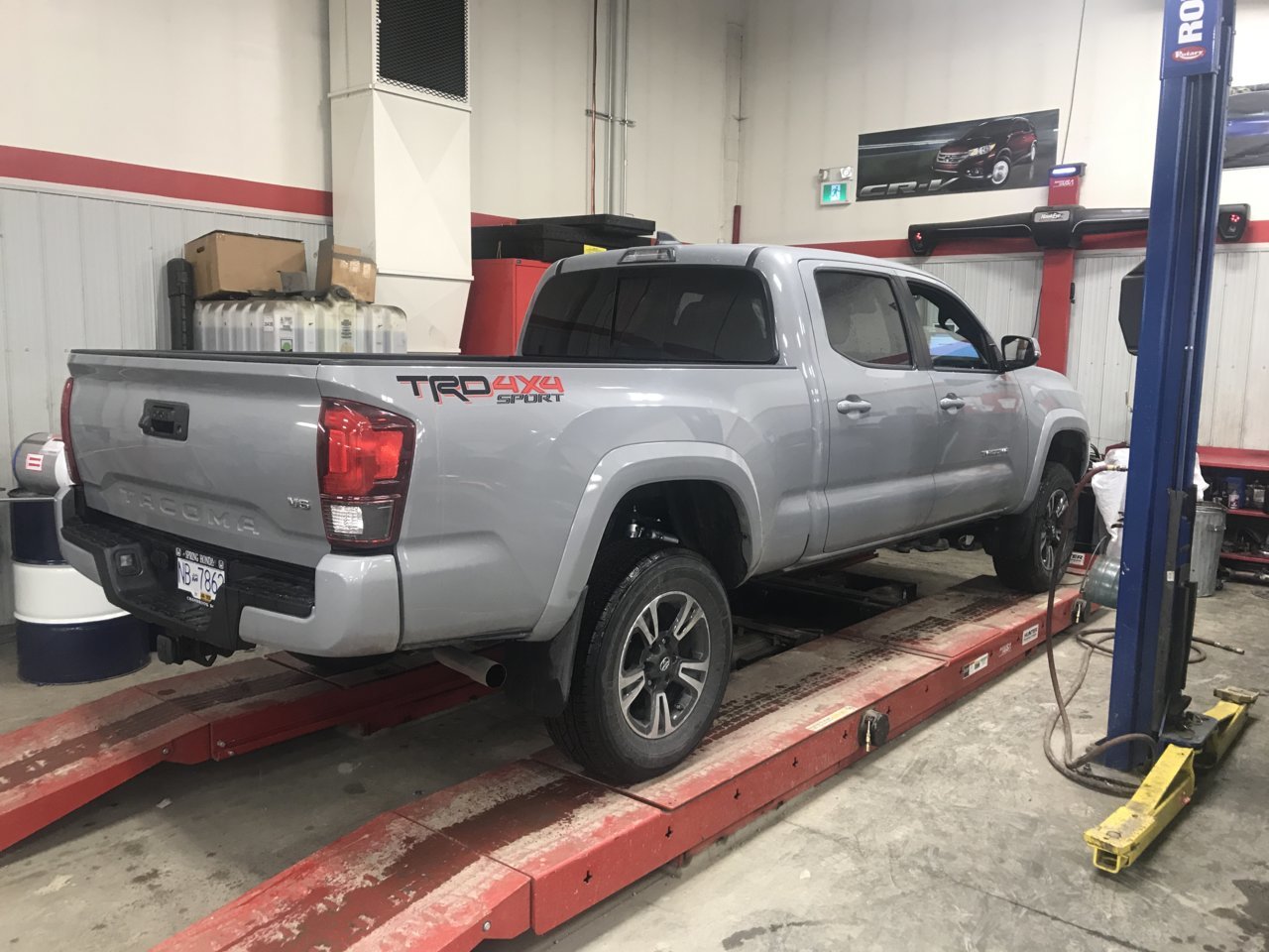

    Just finished up the 3rd gen Bilstein 6112/5160 install with Deaver AAL in the rear.
    Lift specs before:
    FL=20 3/4
    FR= 20 3/4
    RL= 21 1/4
    RR= 21 1/2
    After:
    FL= 23 1/2
    FR= 23 1/2
    RL= 23 3/4
    RR= 23 1/2
    So pretty much 2 3/4 inches in the front on the 6/5 setting and 2" in the rear with the AAL.
    Does this seem normal I assume it with settle down a bit as the kit was only supposed to net 2" max.

  20. Mar 7, 2019 at 2:07 PM
    #2080
    oscolivar1
    oscolivar1 Well-Known Member
    Oct 30, 2013
    #115568
    2,267
    Oliver
    VA
    2017 Tacoma Limited
    Bilstein 8112/8100, JBA UCAs, Icon RXT leaf pack, work wheels 17x8.5;-10os, 285/75/17 cooper LTX AT3, Mobtown HC rear bumper and Sliders, SSO front bumper, BAMF greceased grill.
    It will settle and will settle more and faster if you added armor etc up front. It will bring you down to the advertised 2”
