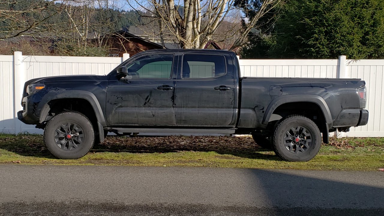

    Street right now.

    Okay cool. Just to clear up things when people are searching.
    Pics of the truck?

    Oh yea I remember this post. Thanks.
