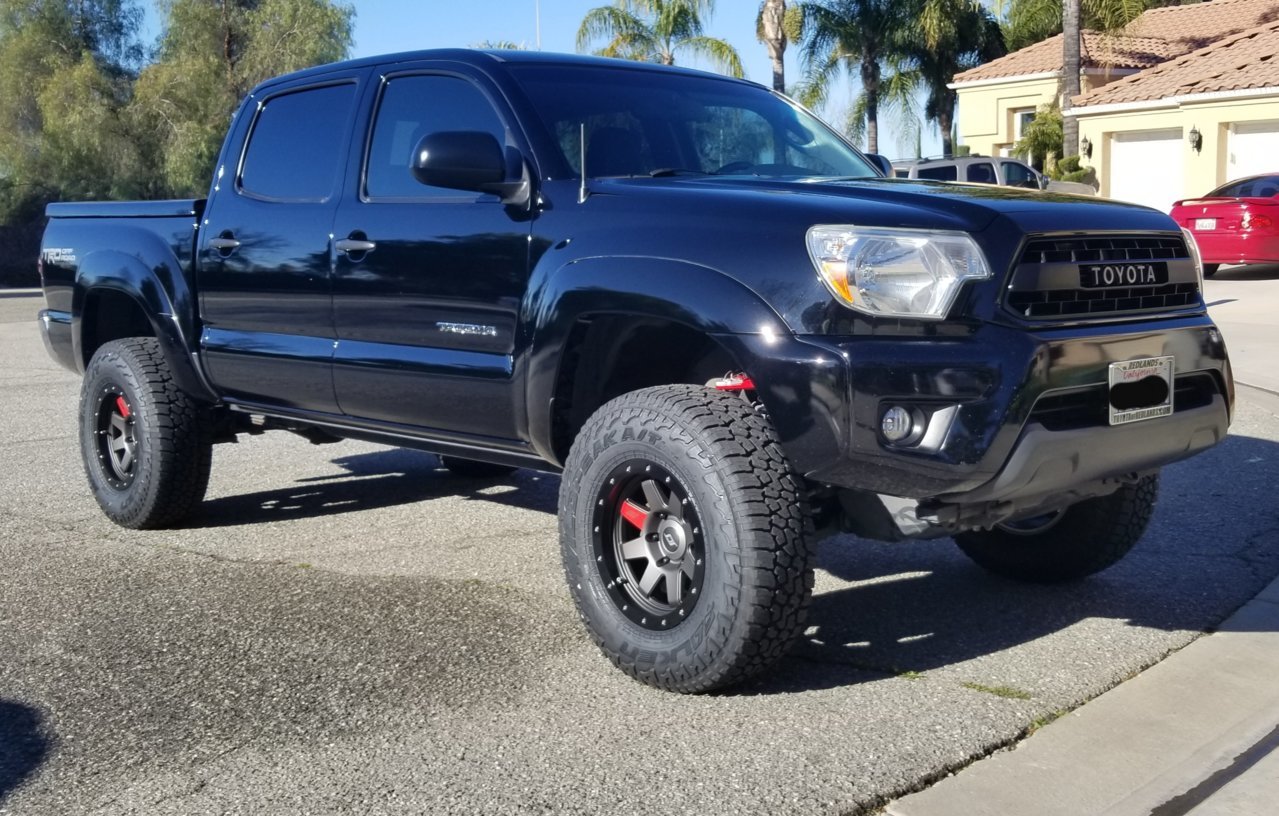

    I am on 4th notch with 5160 and single 1.5-2" add a leaf in the rear with overload. I am sitting dead level at 23.5" Hub to Fender all the way around to give you an idea. 20190317_062754.jpg

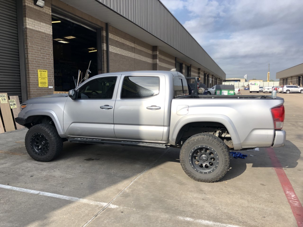

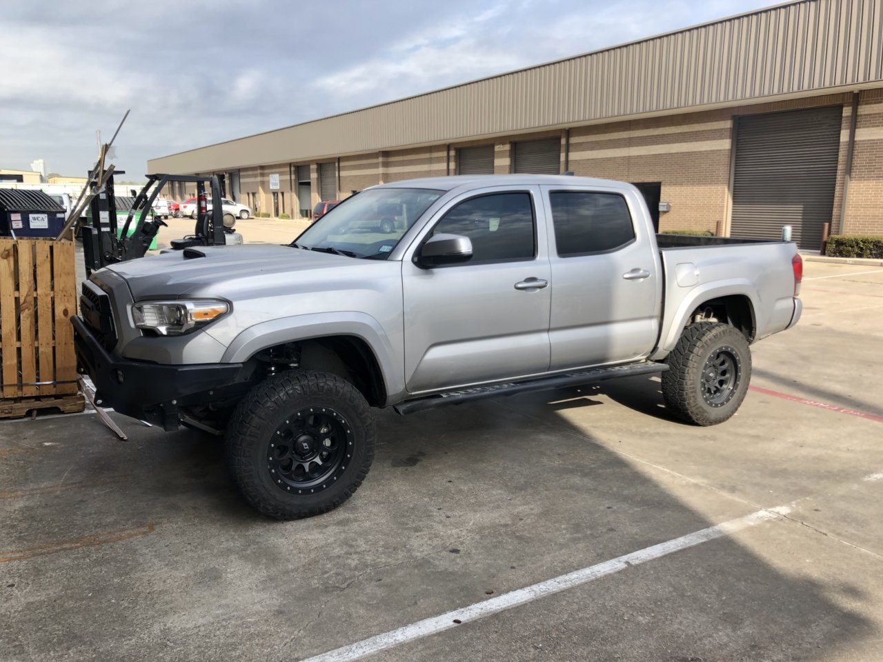

    6112/5160 w/driver
    Side spacer (4th botch). Icon AAL pack (stock overload removed). JBA UCAs and ecgs for good measure. I’m happy with how it currently sits/rides. Tires are 265/70/17s

    What color paint is that? looks almost chrome in the pics? What tires too? looking sharp!

    It’s actually the metallic gray, just got a lot of reflection because it was a nice day.
    The tires are Pro comp Xtreme MT2 265/70/17. I bought it from dealership with the tires and wheels and I’m happy with both!
