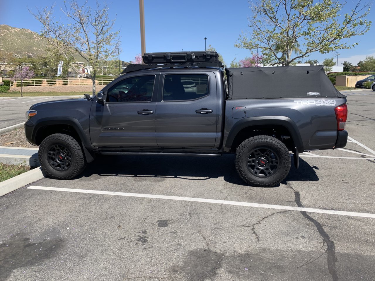

    Look great. I plan to go with the a similar setup but 3rd notch instead of 4th. Doubt I get UCAs since it will be in 3rd notch. Any issues with TSS/ did you have it recalibrated?
  7. Apr 1, 2019 at 1:42 PM
    #2127
    Niccas9
    Niccas9 Well-Known Member
    Feb 5, 2019
    #281914
    218
    Nic
    2019 TRD Off-Road
    I haven't had anything re-calibrated so maybe it's just my ignorance, but I haven't had any problems with the sensor. I've put about 1,000 miles on the set-up and definitely notice an improvement in the ride.
    I do, however, notice a little bit of squeaking, but haven't spent a lot of time trying to pinpoint where it is coming from.
