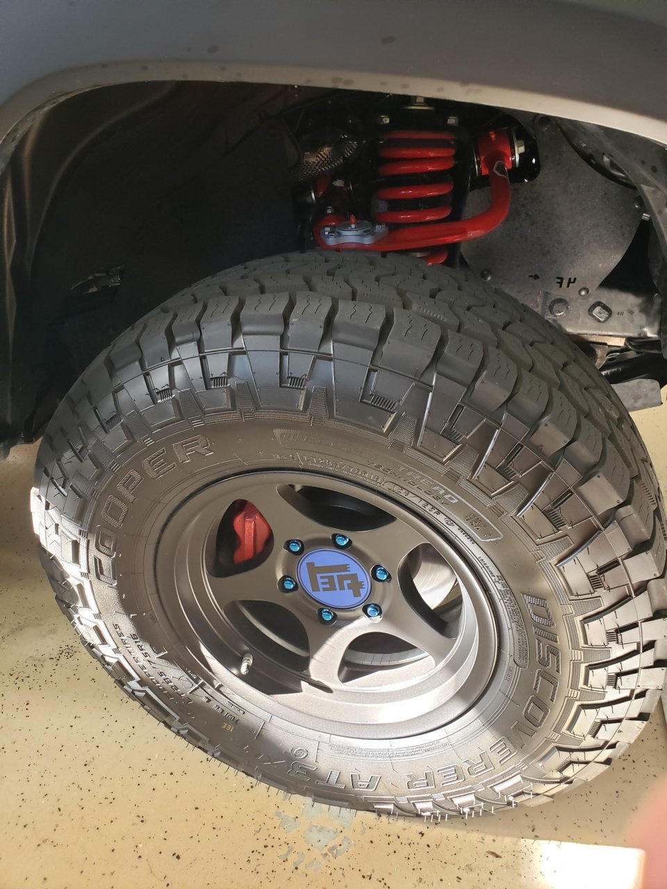

    20190317_173035.jpg The 2nd gen Tacoma Pro suspension are 6112s. Anybody knows about difference besides the coil over are color red on pros

    I installed 2nd gen 6112's onto my 3rd gen truck. Not sure if they made things differently, I do know the 2nd gen setup sits 1" higher than the 3rd gen and they were the only ones in stock at the time
