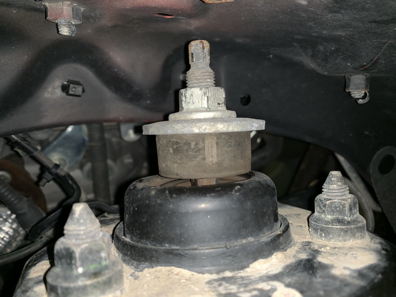

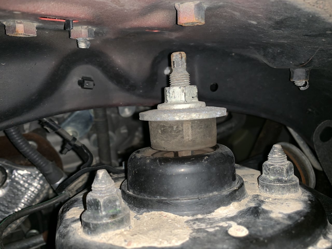

    Can you just tighten it down more? Or is it out of threads? I couldn't tell in the pictures
  2. Apr 23, 2019 at 3:32 PM
    #2182
    Cricketeer
    Cricketeer owned by bird dogs
    Jun 26, 2017
    #222457
    154
    Jeff
    Everett, Washington
    2017 Inferno DCLB TRD OR
    Leer 180, Bilstein 6112/5160, OME Dakars, OVTune
    Out of threads, unfortunately.

    Actual strut mount and/or the lower bushing is shot. The lower is probably missing
  5. Apr 23, 2019 at 4:40 PM
    #2185
    Tridet167
    Tridet167 Not an Overlander, or am I?
    Nov 16, 2014
    #142434
    2,819
    Tony
    Toronto, Canada
    2014 Tacoma SR5 DblCab
    Can you see underneath and see if things are snug there? The way the top is loose like that, I would say remove the top nut and add couple washers and snug it down. Quick fix.

    anyway to get a pick looking up into the top hat? that is odd. Looks like the cap seat that sits over the shaft was left off or failed, and or the washer that sits above it (below the top hat) was left off. Sucks on any account.

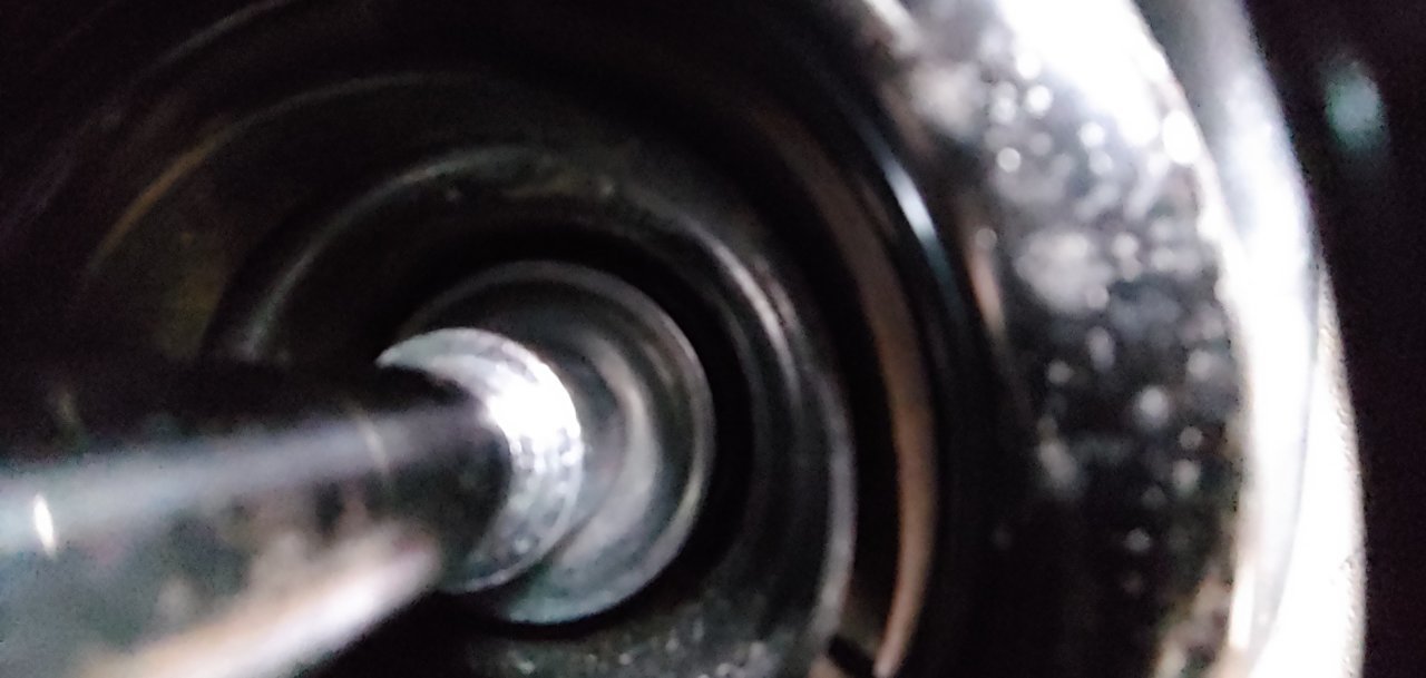

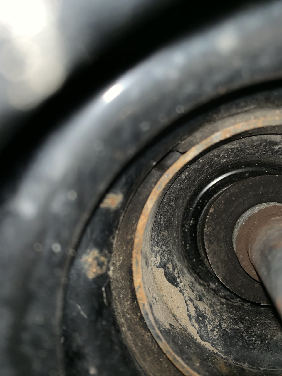

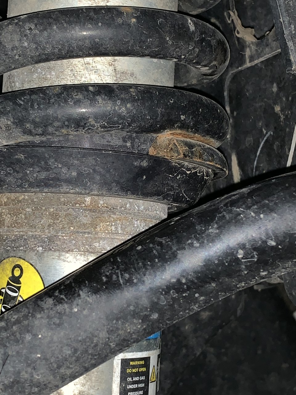

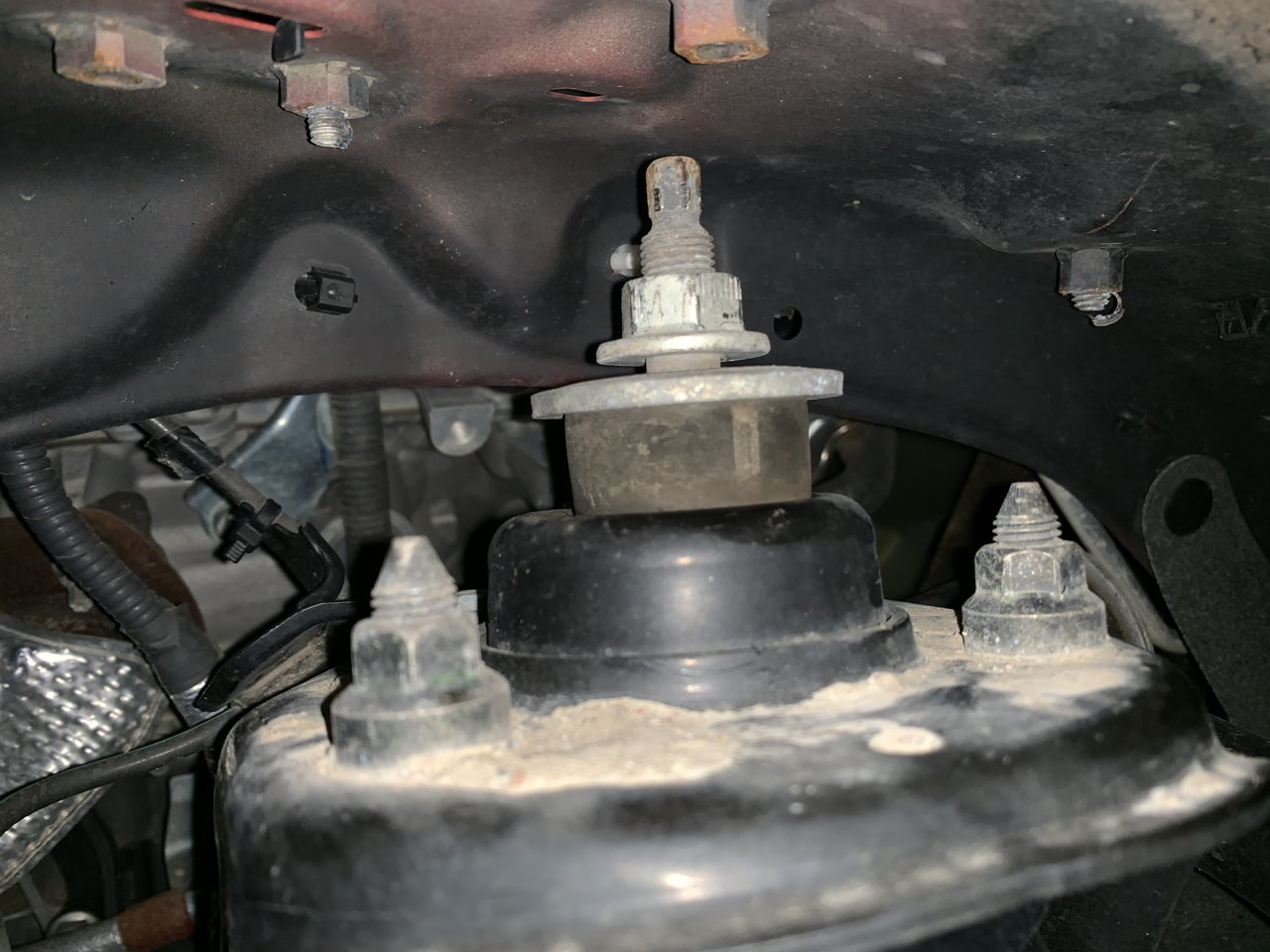

    Pics from both sides.
    Driver
    Passenger
  8. Apr 24, 2019 at 5:54 AM
    #2188
    Scott B.
    Scott B. Well-Known Member
    Nov 11, 2014
    #142118
    4,474
    Scott
    Georgia
    2015 ACLB SR5 4x4 Expo
    This most definitely is your noise.
    Can you post a picture of the lower mounts?
    Have you checked the springs themselves? Any cracks, bends or breaks?
    Which notch is the lower spring mount in? Did it by chance slip?
    It looks like the spring is not expanding enough.
  9. Apr 24, 2019 at 6:18 AM
    #2189
    Cricketeer
    Jun 26, 2017
    #222457
    154
    Jeff
    Everett, Washington

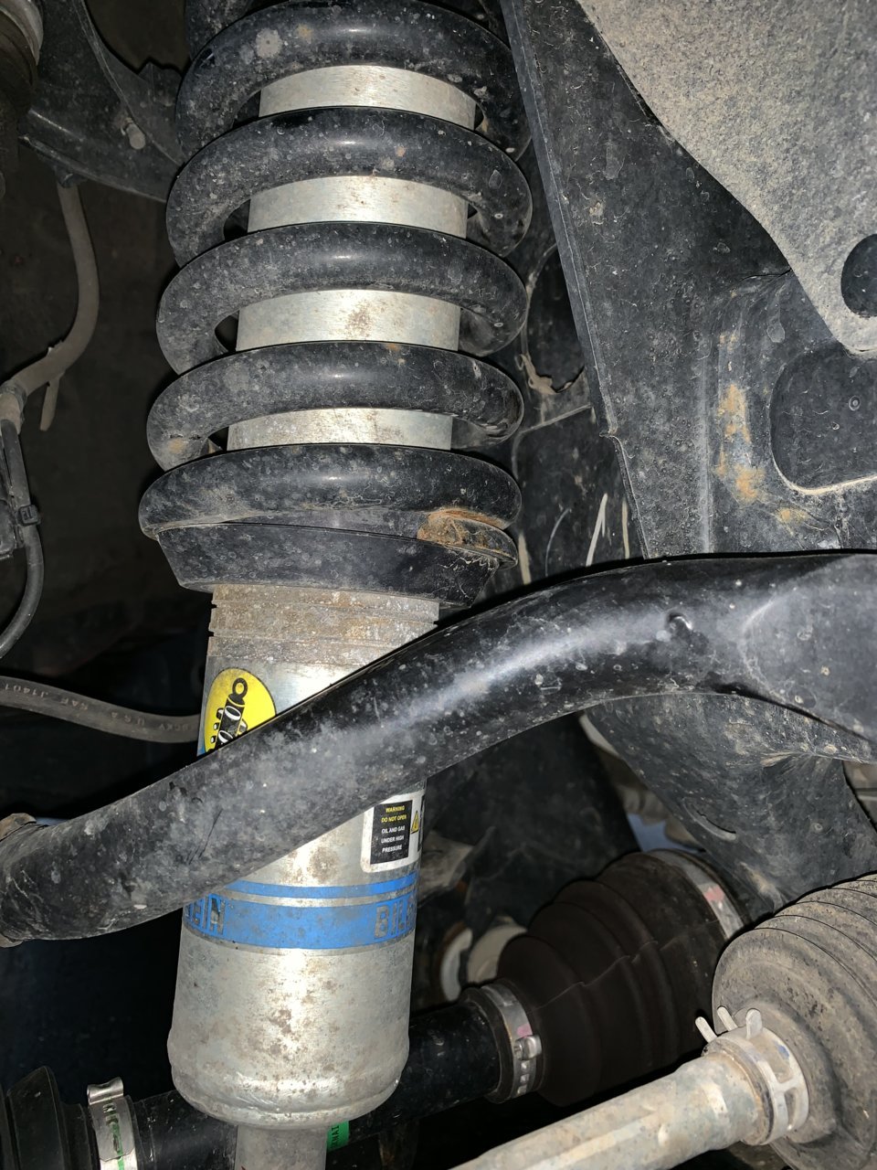

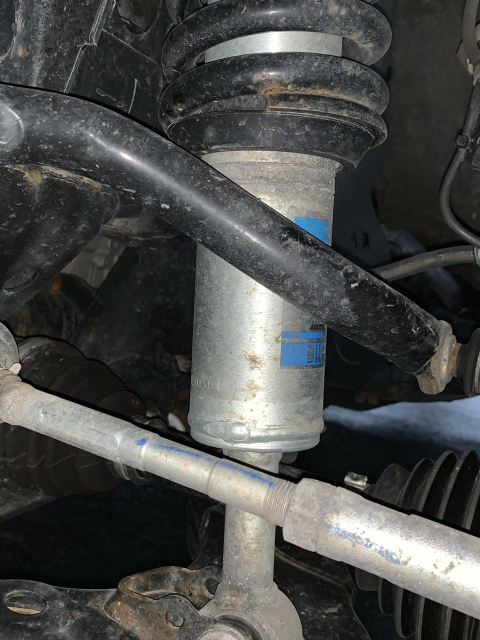

    Passenger
    47B400B4-D999-45CD-A506-147D5B38180C.jpg F5611A9E-5B5A-4EFB-8536-FF2D09615147.jpg
    Driver
    82B769C5-F2D9-45BF-93A0-02D1A8A0ECBF.jpg 01BB78F1-96BE-480B-BC2C-8491A0D9D758.jpg

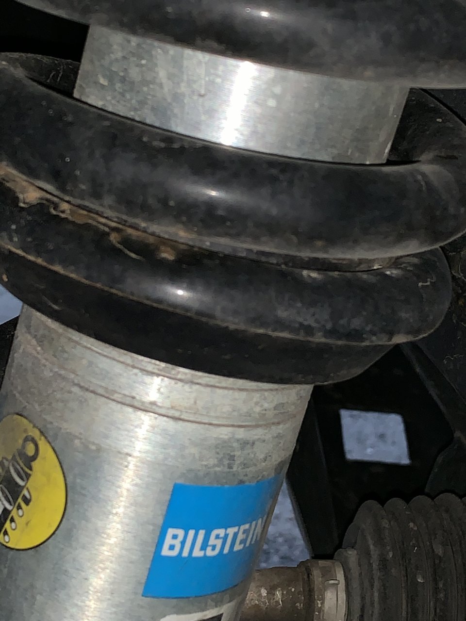

    They were supposed to be set 4&5, but I count two rings showing on both.

    From the looks of it, you have no shock dampening on the front suspension. Only spring bounce.
    Possibly, the springs are too short. Where did those springs come from?
    You could try pulling out one of the coilovers, raise the lower spring perch to the 5th notch, and reassemble the coilover. Perhaps then you can correctly tighten the upper mount.
    Either way, if it is the correct spring, it should fit together fine even at the lowest notch.

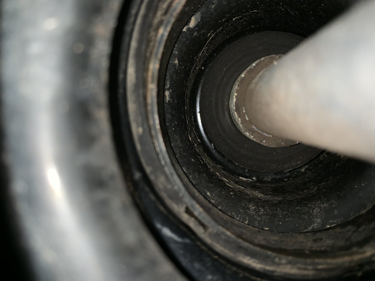

    I can't get a finger in to feel, but should there be a metal retainer/washer between the rubber bushing and the stop on the shaft?

    Yes your missing something under the top hat! I'm not sure if you can get just the lower bushing and washer. I'd order the bushing set and replace all. If your handy and have tools its not that hard to lower the shock out the bottom without removing the top hat (upper plate). Many threads on that. Go through page 5 on this thread. At that time you can move the clips also.

    Okay...
    Called the shop that did the work initially, and it took some 'splaining.
    Problem #1 - They installed 46-241627 for the '05-15 Tacoma's instead of 47-234413 for '16+. The old struts are 1/8" longer.
    https://www.tacomaworld.com/threads/bilstein-6112-finally-released-for-third-gen-2016.478386/
    Problem #2 - They are assembled w/o the lower retaining washer.
    They called Bilstein and they are sending new rubber bushing/isolators and retaining washers which includes an 1/8" spacer.
    I'm not sure now where the clips are set now, though it sure looks like they are the same. I guess we'll find that out when they take the struts apart.

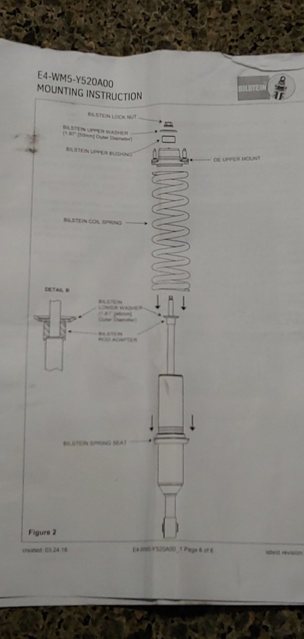

    here is a shot from mine along with assembly instructions = pics show they screwed up - as you noted - yes they let off the lower washer and installed Gen 2 rather than Gen 3. Glad they stepped to the plate and are going to fix them. They probably owe you an alignment too.
