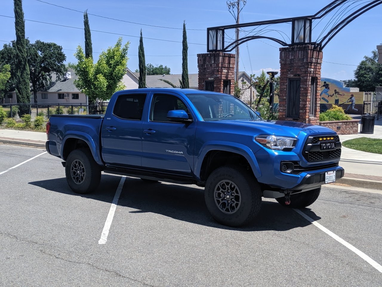

    I added 6112s set at 6th notch both sides with a Headstrong 1/4 spacer on the driver side. 5100s in the rear with a 1 inch block. Dead Level. 38 inches ground to fender . Ride is great on and off road. Glad I went this route instead of 5100s in the front. 00000IMG_00000_BURST20190512134717921_COVER.jpg

    Running the 5/6 setting just nets you a little less lift. Running it at 6 and using the spacer levels your truck and gives you the full lift
  15. May 18, 2019 at 7:03 PM
    #2275
    Tacosrus
    Tacosrus Carpe Diem
    Apr 19, 2018
    #251056
    1,662
    Northern California
    2018 Blazing Blue Pearl SR5 DCSB
    As a matter of fact it's an option on the Headstrong Site To use the 6th clip with the spacer .

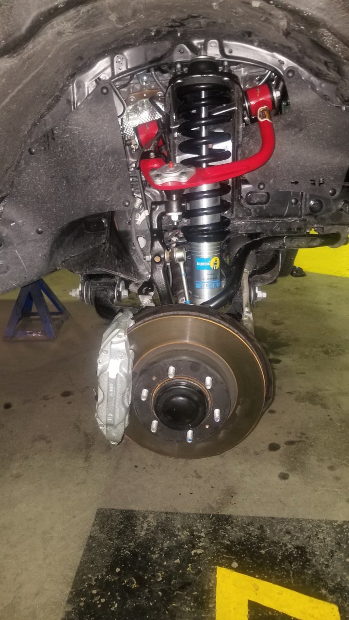

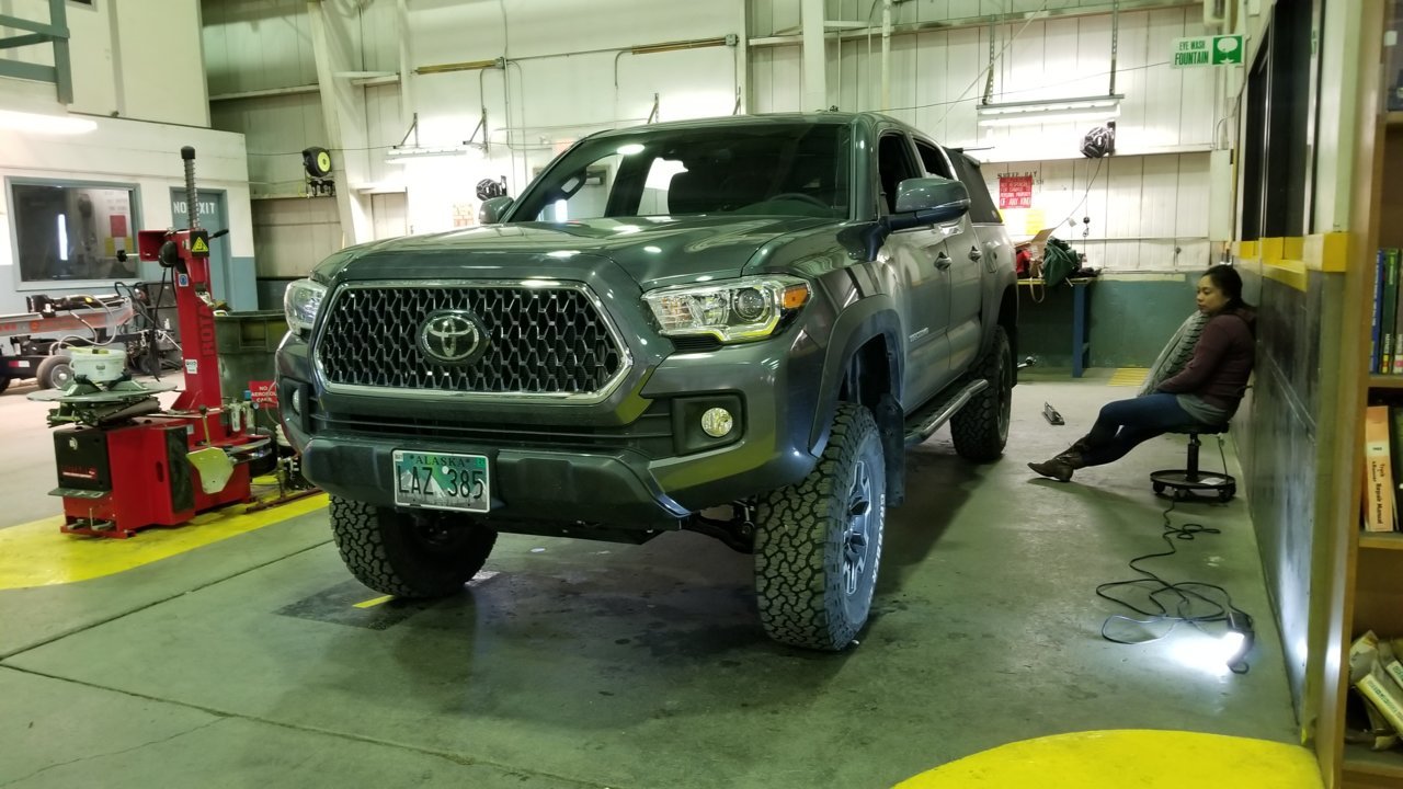

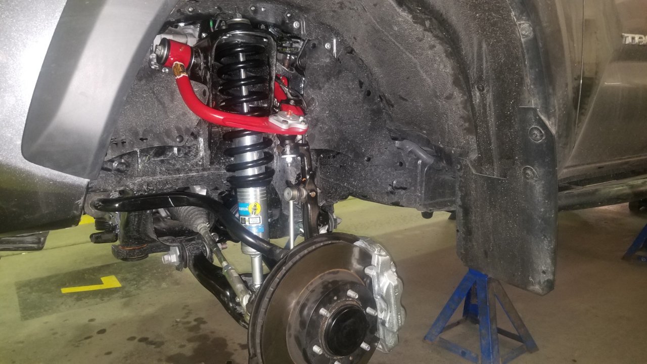

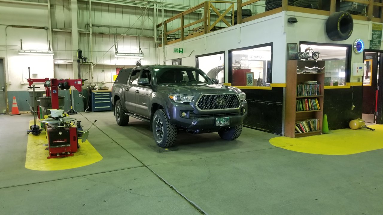

  16. May 18, 2019 at 7:26 PM
    #2276
    Drunken Chewbacca
    Drunken Chewbacca Well-Known Member
    Dec 10, 2017
    #238172
    1,016
    Josh
    3rd Gen Taco
    Not enough to list
    6112/5160s w/ JBA UCAs, OME medium duty leafs, and ECGS bushing.

    I'm gonna do the UCAs in the next few months. A little extra wheel tire clearance is a good thing. Those look Stellar.
  19. May 18, 2019 at 8:03 PM
    #2279
    Drunken Chewbacca
    Dec 10, 2017
    #238172
    1,016
    Josh
    3rd Gen Taco
    Not enough to list
    Mgm
  20. May 18, 2019 at 8:08 PM
    #2280
    Tacosrus
    Tacosrus Carpe Diem
    Apr 19, 2018
    #251056
    1,662
    Northern California
    So are these the high caster or stock UCAs ??
