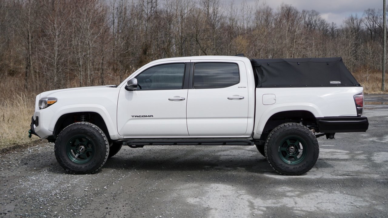

    @NYCTaco52 It doesn’t matter if you run the 1/4 spacer to correct the “lean”. People rock crawl with them and they have no issues. However I still tell people not to add a 1/4 spacer just for the simple fact it was not designed and developed to have one on. If I had to guess the 600lb spring that comes with it can’t hold the weight which causes the lean. When I upgraded to 650lb springs, the Lean was gone. I sit dead level up front on 6/5 setting. C2BF479E-85E5-47D8-8080-24E8601EF1BD.jpg
