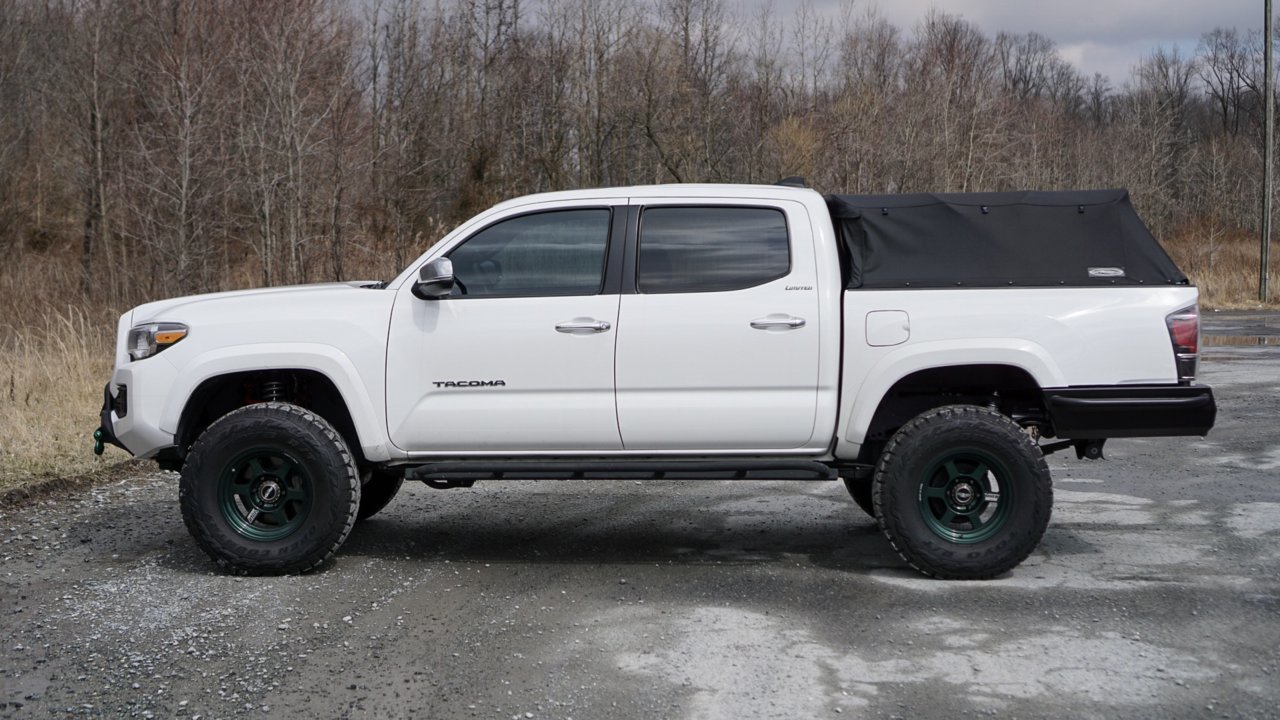

    Just to make sure you have a 2016 double cab 5ft bed with a v6?
  16. Jun 13, 2019 at 9:01 AM
    #2356
    littlefish
    littlefish Buzz, your girlfriend...
    Sep 13, 2018
    #266147
    2,001
    Hudson Valley NY
    2016 TRD Off-Road DCSB
    The one who dies with the most stuff wins.
    Correct. V6 double cab 4WD. How much weight do you have on your front end with your 650# springs? I'd like to retain my rake, I don't want to level the truck. I ordered the 5160s and the Dakar leaf pack for the rear.

    Ok. So if I wanted to be at 3" lift, I should look for something else instead of the 6112? I had plans on putting on bumpers, winch and some armor.

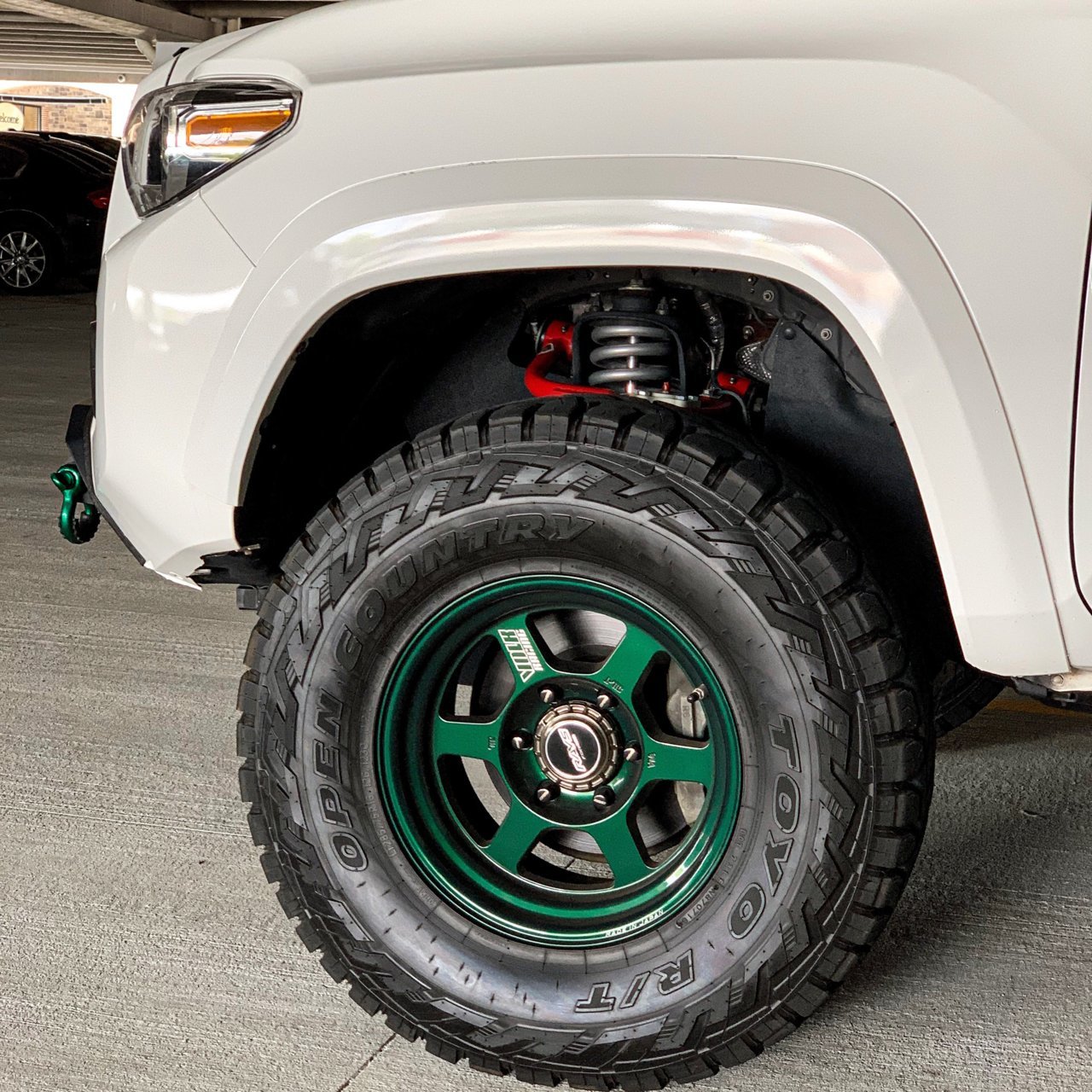

    Bilstein 8112/8100, JBA UCAs, Icon RXT leaf pack, work wheels 17x8.5;-10os, 285/75/17 cooper LTX AT3, Mobtown HC rear bumper and Sliders, SSO front bumper, BAMF greceased grill.
    A lot easier just to show by pictures. I gained just a tad over 2”. Slimline bumper and mobtown rock sliders with kick out, and just the trd skid plate. Rear is 3” lift icon RXT with bilstein 8100 with mobtown HC rear with tube protection. With 350-400lb or so I still had like .75-1” of rake.
    F277E7FB-22A7-4CFA-9A7F-3FA774499B35.jpg 76BA6C72-81DF-4A2B-B47C-6449C25F6B72.jpg
    You could But with a spacer lol. Other wise coilovers that are preloaded to the max that will affect your ride and comfort severely if you wanted to maintain 3” with all that added weight. I’d suggest stay 2.5” range, but that’s just me.

    Man your truck looks good! Based on your previous comments, the setup in those pictures is the 6/5 perch with 650# springs? And you're just over 2"? I have ~ 200 pounds more upfront than you with my winch and all three skids. So I'm feeling more confident that I"ll be right around 2" or less.
    I see you have aftermarket UCAs. It's my understanding that I shouldn't need them. Did you find them necessary or more preventative for future mods?
