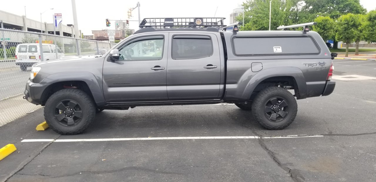

    Texas
    2013 Double Cab Short Bed
    Bilstein 6112 (Front) Bilstein 5100 (Rear) General Spring KC - HD Leafs Poly Swaybar Bushings Braided Stainless Steel brake hose Intake Manifold Spacer Retrofitted Headlights
    Here’s mine after installing 6112s and 5100s with new General Spring leafs
    Tridet167 and Durango95 like this.

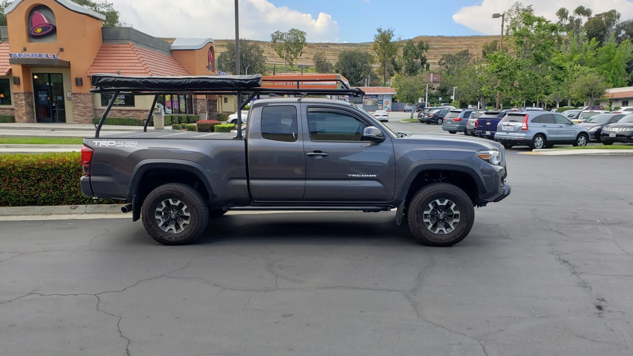

    202
    Tony
    2018 Tacoma TRD OR ACLB
    I installed 6112 last month with OME Dakar medium leafs. No rear shocks yet as they are still not in stock.
    I had the clips on 5/4 as recommended for my AC.
    This picture was taken right after the install and alignment.
    I am currently at factory height in the front. No mods to the front of my truck.
    Rear came up 2" despite the additional weight in the bed.
    What am I doing wrong?

    What’s the question? Your saying you didn’t get and lift cuz it looks like you got some. Did you take before and after measurements?
    You have to completely remove the setup. You can install the Dakar’s in the rear on the stock shocks.
