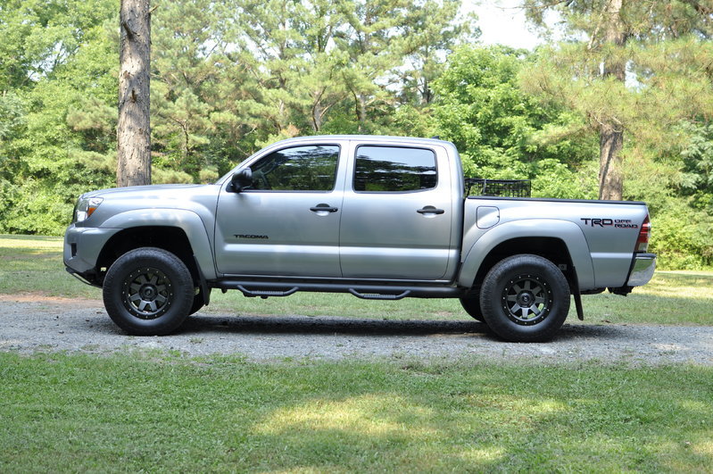

    How's everyone's 6112's holding up after some road time?
    I've got about 6000 miles on mine now and they've settled quite a bit from when they were freshly installed.
    Notch #3
    Day of Install:
    6,000 miles later:
    Which, it's fine. I'm pretty much sitting dead level now, but I was surprised that I went from slightly over 2" of lift down to about 1.5". I'm not nose high anymore, but I think I'll have to bump up to notch #4 when I decide to do the AAL on the rear.

    A couple of things: for one your showing different sides of the truck, and was that first pic right after install or after driving around a bit. Also do you have a spacer on the drivers side? I have a 1/4". Mine maybe settled 1/4" to maybe 1/3" so far after 4 months or so (3rd setting also). That looks like more than a 1/2"? I also noticed a difference when i loosened the LCA bolts went down the driveway and back then retorqued - it dropped 1/8". I originally torqued the LCA bolts while it was raised - mistake. I have about 1" net lift in the rear with the stuff in and on the bed and it sits right where I want it for now. Still riding sweet though on and off road.
